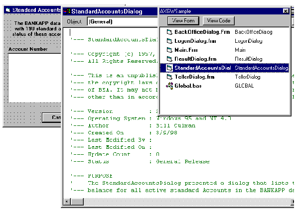

The code examples shown here are taken directly from the sample BANKAPP project forms. You can also see code for the dialogs in the BANKAPP project by choosing View Code on the selected form in Visual Basic (Figure 5-13 shows an example of this), or by opening the files with a text editor.
For the purposes of understanding how we got the generated sample code for the examples in this chapter, make sure that you have the following sample code options set to on in the Active Expert Application Builder:

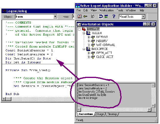

Figure 5-13 Viewing Code on a BANKAPP Dialog in Visual Basic
To do this choose, Tools->Options from the Active Expert Application Builder menu, and click on the Sample Code options tab. Click the exception handling and transaction object options so that checkmarks show beside them, and click OK to save your changes.
Now, to see the example code in the Active Expert Application Builder, simply select the appropriate object in the Workstation Objects main window view and click on the Declarations, Usage, or Cleanup tabs. In this way, you can follow along with the code examples using both the Active Expert Application Builder sample code displays and the full code text files in Visual Basic.

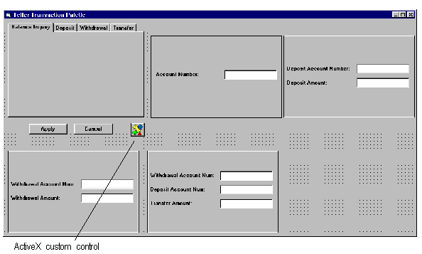

You can view the code for the Teller dialog in the file Figure 5-15 shows the Visual Basic form for the BANKAPP Teller dialogs (Balance Inquiry, Deposit, Withdrawal, and Transfer). Since Teller uses an ActiveX Control (

This ActiveX control was created with the Active Expert Application Builder, registered to this project, and then placed on the The following code is copied directly from the Active Expert sample usage code for the INQUIRY operation.

Logon
LogonDialog.frm
Declare Variables for BEA TUXEDO Logon
Session.logon
. This code is copied directly from the Active Expert sample declaration code for the BANKAPP module as shown in Figure 5-14. (To see this code in the Active Expert, select the BANKAPP module in the Workstation Objects main window view and click on the Declarations tab.)
Const SecAuthSuccess = 1
Const SecAuthFailure = 2
Dim UserData(0) As Byte
Dim ret As IntegerFigure 5-14 Copying BEA TUXEDO Logon Variables from Active Expert to Visual Basic Logon Form

End Select ActiveX Control Using a Synchronous Interface (Teller Dialog: Balance Inquiry)
TellerDialog.frm
. (Note that a single form is used to present the Balance, Inquiry, Deposit, Withdrawal, and Transfer transactions all within one dialog.)
.OCX
) Visual Basic interface, the Teller form includes an ActiveX Control which is hidden at run-time.
Figure 5-15 Teller Dialogs - Balance Inquiry, Deposit, Withdrawal and Transfer (TellerDialog.frm)
