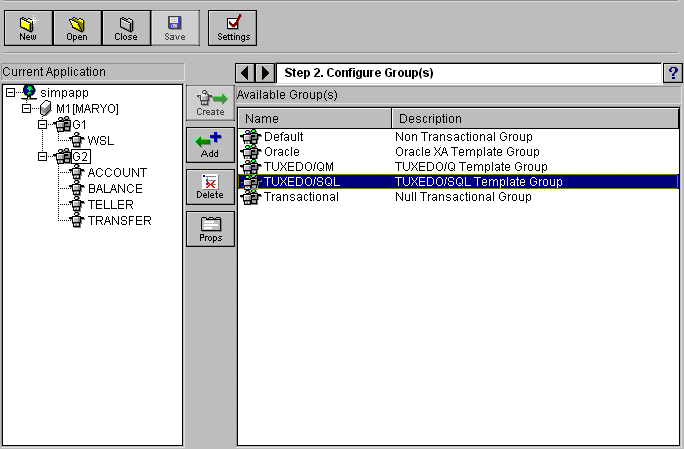

Configuring Groups (Step 2)
You can add a server group to your configuration or modify the properties of an existing group.
Adding a Group
To add a server group:
  1. On the main window, select the group you want to add from the list in the right panel as shown in Figure 3-11.
    Figure 3-11 Configure Server Groups
  2. Click Add on the Configuration Tool bar.
    Repeat steps 1 and 2 until all server groups are added to your configuration.
    Once all groups are added, you may change the properties of each group. See Modifying a Group.
