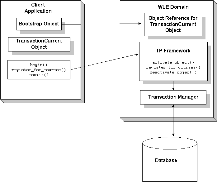

Figure 4-1 illustrates how transactions work in a WLE application.
Figure 4-1 How Transactions Work in a WLE Application
A basic transaction works in the following way:
  1. The client application uses the Bootstrap object to return an object reference to the TransactionCurrent object for the WLE domain.
  2. A client application begins a transaction using the Tobj::TransactionCurrent::begin method, and issues a request to the CORBA interface through the TP Framework. All operations on the CORBA interface execute within the scope of a transaction.
  3. The Tobj::TransactionCurrent:commit method causes the TP Framework to call the Transaction Manager to complete the transaction.
  4. The Transaction Manager updates the database.

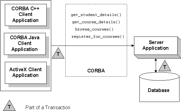

In the Transactions sample application, the operation of registering for courses is executed within the scope of a transaction. The transaction model used in the Transactions sample application is a combination of the conversational model and the model in which a single client invocation makes multiple individual operations on a database.
The Transactions sample application works in the following way:
  1. Students submit a list of courses for which they want to be registered.
  2. For each course in the list, the server application checks whether:
  3. One of the following occurs:
Figure 4-2 illustrates how the Transactions sample application works.
Figure 4-2 Transactions Sample Application
The Transactions sample application shows two ways in which a transaction can be rolled back:
