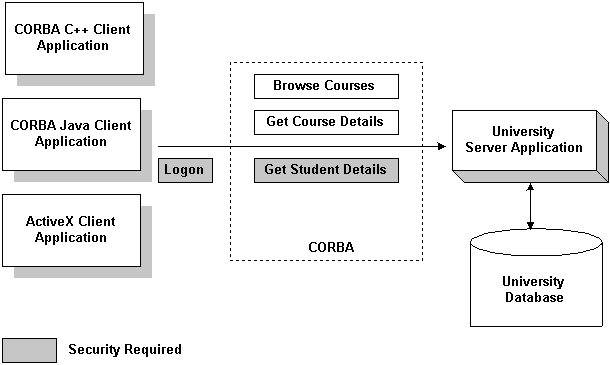

Figure 4-1 illustrates how the Security sample application works.

Figure 4-1 The Security Sample Application
