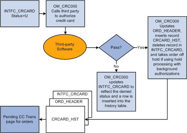

    1. Load CC Interface process (OM_CRCARD).
    2. CC Processing (OM_CRC000).
      Note. For OM_CRCARD to load the pending credit card data to the interface table and OM_CRC000 to transmit for authorization or approval, a working third-party integration to the credit card application must be installed in the system.

PeopleSoft Order Management Credit Card Process Flow
The next four diagrams illustrate the PeopleSoft Order Management credit card process flow:
Creating credit card charges during online order entry in PeopleSoft Order Management
Submitting credit cards for background processing in PeopleSoft Order Management
Processing failed credit card authorizations in PeopleSoft Order Management (1 of 2)
Processing failed credit card authorizations in PeopleSoft Order Management (2 of 2)

  1. Access the Load Credit Card Interface page to initiate the Load CC Interface process.
    This process loads the credit card information from the ORD_HEADER table and address information from the CUST_ADDRESS table into the INTFC_CRCARD, the main staging table for the credit card authorization interface program to the third-party credit card authorization and payment application.
  2. Access the Credit Card Processing page to initiate the Credit Card Processing process.
    The Credit Card Processing process takes the credit card information from the INTFC_CRCARD staging table and calls the Process Credit Card process. It also removes the hold that was applied when the order was created, assuming you have set up the PeopleSoft Order Management Business Unit to do that.
    If reauthorization of stale transactions is enabled on the OM installation record, then a corresponding check box is appears on the Credit Card Processing page. You should schedule this process to run at least once per day with this check box selected on the run control.
    Note. The Enable Authorization Reversals for Decrements option needs to be selected in the Installation Options for authorization reversals for decrements. The batch process will handle the reversals if necessary.
    If purging of security codes is enabled on the installation record (indicated by a value greater than zero), then a Purge Security Codes check box appears on the Credit Card Processing page. The user should schedule this process to run at least once per day with All Business Units selected.
