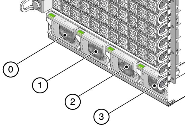

The power supplies mount at the lower front of the switch chassis and occupy slots numbered 0 through 3, going from left to right. That is, slot 0 is on the left side of the chassis and slot 3 is on the right side of the chassis, when looking at the slots.
Illustration shows the numbering of the power supply slots.
Note - Power cords and power supplies are mated in a pass-through, one-to-one relationship. The power cord for power supply 0 is on the right side of the switch chassis when looking at the receptacles. The power cord for power supply 3 is on the left side of the switch chassis when looking at the receptacles.
The following table lists the slot numbers, associated IPMB addresses (in hexadecimal), and FRU numbers for the power supplies.
Slot Number
IPMB Address
(in hexadecimal)
FRU Number
0
20
3
1
20
4
2
20
5
3
20
6
