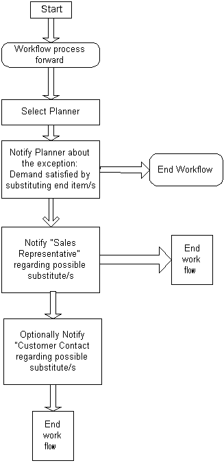

Follow work flow procedure to enable execution

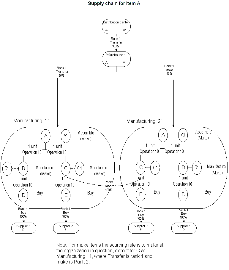

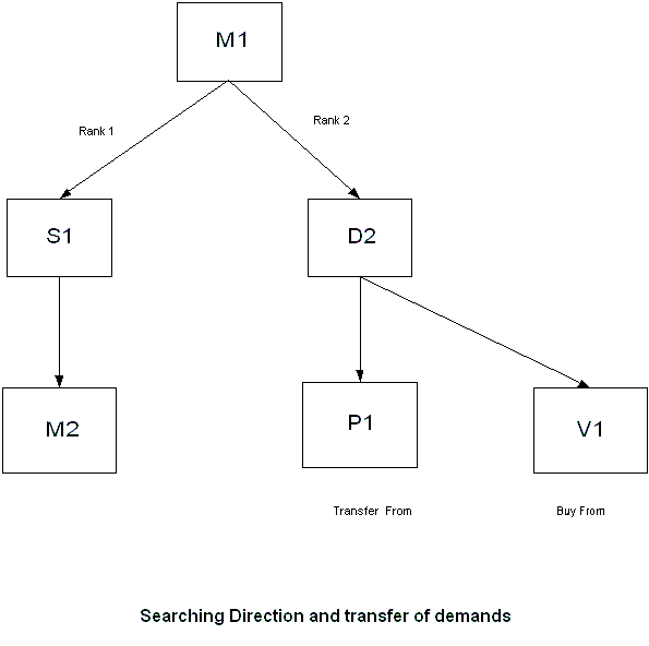

Searching the supply chain
Chaining
A demanded item or a substitute item could be available within the same organization or in a different organization within the supply chain. You can take advantage of availability of supply (both requested item and substitute items) across the supply chain and use up the inventory effectively before placing orders to make or buy the item. To search for demanded item or substitute items, the planning engine looks for demanded and substitute items within the same organization before looking in other organizations to find them.
The following figure show you this search method:

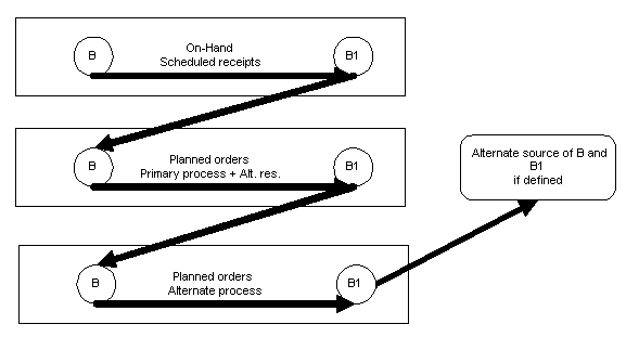

With this method, the emphasis is on use up. The availability picture of original item and substitutes guides the search. The emphasis of the search is to seek supplies from demanded item or substitute item and use it up as effectively as you can before creating supplies for the item requested. This means Oracle APS looks for on hand and scheduled receipts of demanded items and substitutes within one organization before proceeding to the next organization to repeat the same search.
If profile option MSC: Choice of item for which to create supplies in substitute relationship is Follow Item Attribute, the planning engine respects capacity on the demanded items. It can create planned orders for any item within the chain as long as flag Create Supply is Yes and there is available capacity. It does not necessarily use the next item within the substitution chain with flag Create Supply as Yes.
An important point to note here is the direction of search when multiple levels of sources are involved. If you consider the following diagram, the Atlanta facility sources from Dallas and Miami, Dallas sources from Dallas-1, and Miami sources from Miami-1.
Supply Chain for Substitution
If you have item A and a substitute item A1 in all the organizations in the supply chain and if you have demand in Atlanta, the search follows the sequence mentioned below:
Look for on hand and scheduled receipts of item A and substitute A1 at Atlanta
Look for on hand and scheduled receipts of item A and substitute A1 at Dallas
Look for on hand and scheduled receipts of item A and substitute A1 at Miami
Look for on hand and scheduled receipts of item A and substitute A1 at Dallas-1
Look for on hand and scheduled receipts of item A and substitute A1 at Miami-1
The search across organizations is guided strictly by sourcing rules, bills of distribution, and the corresponding ranks for the sources. Summarizing the search process, Oracle APS looks for the demanded item (requested item) and all its possible substitutes within a facility and it continues to look for demanded item (requested item) and its substitutes in other facilities searching breadth first. Referring to the diagram, the search will follow:
Atlanta, Dallas, Miami, Dallas-1, and Miami-1
It is very important to note that the breadth-first search method is used in constrained plans. In optimized plans, the search is entirely driven by costs i.e., item costs, penalty costs for satisfying demand late, transportation costs etc. An optimized plan suggests transfers and substitutes based on the overall objective of the plan and costs mentioned above.

A supply chain is shown in the diagram below. In the diagram M1, S1, D2, M2, D2, and P1 are Organizations. V1 is a supplier. Organization M1 sources from S1 and D2 in a ranked order. Organization D2 sources from three different sources. (Make at, Transfer from, Buy From). Your desired search sequence is M1, S1, D2, M2, P1 and V1.
Figure title
The following tables show supply and demand for the organizations in the diagram.
In this example, you have two items; A and A1. A can use A1 supply due to substitution rules. Both item A and A1 are enabled in all organizations. Assume that you do not have any supplies at Organization M2, P1 and supplier V1.
| Record Type | Item | Day 2 | Day 5 | Day 10 | Day 20 |
| Demand | A | 100 | 0 | 0 | 0 |
| Supply | A | 0 | 5 | 0 | 10 |
| Supply | A1 | 0 | 0 | 15 | 0 |
| Demand | A | 0 | 0 | 0 | 0 |
| Supply | A | 20 | 0 | 0 | 0 |
| Supply | A1 | 10 | 0 | 0 | 0 |
| Supply | A | 0 | 10 | 0 | 0 |
| Supply | A1 | 0 | 0 | 10 | 0 |
Starting with a demand for 100 units of Item A in Organization M1 on Day 2, you consume 30 units of supply from A and A1 leaving you with a net demand of 70 units. A planned order demand for item A is created and pushed down to Org S1, where you will consume 20 units of supply from Item A and 10 units of supply from item A1. (Notice that the demand is pushed down for A instead of A1. If you push down the demand on A1, you run a risk of not using supply from item A). Now you are left with a net demand of 40, for which you create a planned order demand for item A and push it down to Org D2. You consume 10 units of supply from both A and A1 leaving you a net deficit of 20 units.
Now that you have exhausted all original item supplies and substitute supplies in the supply chain, you need to still produce 20 units. The creation of 20 units of supply follows the normal planning logic.

For each occurrence of the exception message: Demand Satisfied by Using End Item Substitution, a workflow is initiated and sent to the planner associated with the original item. At this point you can end the workflow or notify the Sales Representative or the Customer Contact of the substitution.
Following is a diagram of the workflow initiated by the planning engine. You will notice that there is not an alternative to change the line item based on the workflow. Users can manually change the line items as long as the orders are in a pre-booking stage.
Workflow Initiated by the Planning Engine
The heading of the workflow is Demand Satisfied by Substituting End Items. The following details are shown in the workflow:
From item: The item for which you received the demand, the exception is for this item.
Plan name: Name of the plan
Order Number: Optional based on the type of demand
Line Number: Optional based on the type of demand
Original Quantity: The requested quantity
Substitute item: Substitute item, this is the item to which the demand was transferred. These could be multiple items.
Organization: Organization at which the exceptions happened.
Substituted Quantity: The demand transferred quantity.
Substitute Supply Organization: The organization at which you found the supply.

The diagram below indicates the planning logic for a component B with B1 as the substitute component. As shown in the diagram, Planning will look for projected available supply of item B (on hand and existing supplies) and then projected available supply for item B1. After that, Planning will recommend creating a planned order for item B using primary BOM/Routing and alternate resources. Planning will then generate planned orders for item B1 using primary BOM/Routing and alternate resources. If additional supply is needed, Planning will use the alternate BOM/Routing for item B and then for item B1 before looking to source items B and B1 from an alternate source/facility.
Planning Logic for Substitute Component

This section describes the planning search logic for user-defined alternate decision rules for both optimized and constrained plans. The planning logic uses a series of steps depending on the constraints used for the plan. The planning search logic is illustrated below using the supply chain for assembly item A with end-item substitute item A1. Item A is made of B and C with B1 and C1 as the substitute components. B and C in turn need items D and E respectively. To simplify the search we will not expand the substitute component B1 and C1 and also assume the same BOM and routing for All items across Manufacturing 11 and Manufacturing 21. In addition, we have made the following two assumptions:
There is high demand placed on the distribution center
For optimized plans, cost effectiveness at each node across the given supply-chain is the same
Supply Chain for Item A
The planning engine searches on-hand quantity and schedules receipts (item A and end item substitute A1) across each tier before creating new planned orders for the demanded item. (Please refer to End Item Substitution chapter). To look for on-hand quantity and scheduled receipts of the demanded item and the end-item substitute, ASCP uses the search logic as specified below.
Distribution center for item A
Distribution center for item A1
Warehouse 1 for item A
Warehouse 1 for item A1
Manufacturing 11 for item A
Manufacturing 11 for item A1
Manufacturing 21 for item A
Manufacturing 21 for item A1
The following diagram illustrates the tier-by-tier search logic for on-hand quantity and scheduled receipts for end items.
Figure title
If there is no on-hand/scheduled receipts for either A and A1 or on-hand quantity is not adequate to satisfy demand, then ASCP will create the planned orders to satisfy net demand for A, B, C, D and E in the following method:
When creating planned orders for A:
Transfer A from Warehouse 1 to Distribution Center
Make A at Manufacturing 11 using primary resource and primary BOM/Routing and Primary components B (Refer to Planning for B at Manufacturing 11), C (Refer to Planning for C at Manufacturing 11), D (Refer to Planning for D at Manufacturing 11), and E (Refer to Planning for E at Manufacturing 11)
Make A at Manufacturing 11 additionally using alternate resource
Make A at Manufacturing 11 additionally using substitute components (B1, C1 if needed)
Make A at Manufacturing 11 using Alternate routings/BOM
Make A at Manufacturing 21 using primary resource and primary BOM/Routing and Primary components (B (Refer to Planning for B at Manufacturing 21), C (Refer to Planning for C at Manufacturing 21), D (Refer to Planning for D at Manufacturing 21), E (Refer to Planning for E at Manufacturing 21)
Make A at Manufacturing 21 using alternate resource
Make A at Manufacturing 21 using substitute components (B1, C1)
Make A at Manufacturing 21 using Alternate routings/BOM
Use on-hand/scheduled receipts for B in Manufacturing 11
Use on-hand/scheduled receipts for B1 in Manufacturing 11
Make B at Manufacturing 11 using primary Resources, BOM/Routing and component D (Refer to Planning for D at Manufacturing 11)
Make B at Manufacturing 11 using alternate resources
Make B1 at Manufacturing 11 using primary Resources, BOM/Routing and components
Make B1 at Manufacturing 11 using alternate resources
Make B at Manufacturing 11 using alternate BOM/Routing
Make B1 at Manufacturing 11 using substitute components
Make B1 at Manufacturing 11 using alternate BOM/Routing
Use on-hand for B in Manufacturing 21
Use on-hand for B1 in Manufacturing 21
Make B at Manufacturing 21 using primary Resources, BOM/Routing and component D (Refer to Planning for D at Manufacturing 21)
Make B at Manufacturing 21 using alternate resources
Make B1 at Manufacturing 21 using primary Resources, BOM/Routing and components
Make B1 at Manufacturing 21 using alternate resources
Make B at Manufacturing 21 using alternate BOM/Routing
Make B1 at Manufacturing 21 using substitute components
Make B1 at Manufacturing 21 using alternate BOM/Routing
Transfer from Manufacturing 21
Use on-hand for C in Manufacturing 11
Use on-hand for C1 in Manufacturing 11
Make C at Manufacturing 11 using primary Resources BOM/Routing and component E (Refer to Planning for E at Manufacturing 11)
Make C at Manufacturing 11 using alternate resources
Make C1 at Manufacturing 11 using primary Resources BOM/Routing and components (E)
Make C1 at Manufacturing 11 using alternate resources
Make C at Manufacturing 11 using alternate BOM/Routing
Make C1 at Manufacturing 11 substitute component
Make C1 at Manufacturing 11 using alternate BOM/Routing
Use on-hand for C in Manufacturing 21
Use on-hand for C1 in Manufacturing 21
Make C at Manufacturing 21 using primary Resources BOM/Routing and component E (Refer to Planning for E at Manufacturing 21)
Make C at Manufacturing 21 using alternate resources
Make C1 at Manufacturing 21 using primary Resources BOM/Routing and components (E)
Make C1 at Manufacturing 21 using alternate resources
Make C at Manufacturing 21 using alternate BOM/Routing
Make C1 at Manufacturing 21 substitute component
Make C1 at Manufacturing 21 using alternate BOM/Routing
Use on-hand/scheduled receipts of D at Manufacturing 11
Buy D from supplier 1
Look for alternate source of supply
Use on-hand/scheduled receipts of D at Manufacturing 21
Use on-hand/scheduled receipts of E at Manufacturing 11
Buy E from supplier 2
Look for alternate source of supply (none defined)
Use on-hand/scheduled receipts of E at Manufacturing 21

For the planning engine to follow the predefined sequence of selecting alternates, the derived value of the total processing lead time and the cumulative lead times should be the same. Any discrepancies between the total value of the two lead times may result in ASCP not following the predefined sequence of selecting alternates.
Looking at pegging may not be the method you should use to determine the sequence of selection of alternates. This is because the sequence of selection of alternates is more apparent when looking at total demand and total supply across the time bucket where there is a constraint.
For example, suppose there are two demands, D1 (150 units) and D2 (50 units) on day 1 and day 2 for item B, and the only way to satisfy this demand is by making 100 units with primary resource/routing/BOM and 50 units using substitute component B1 and 50 units of B with alternate BOM/routing. Then, day 1 demand will peg to 100 units of item B using primary resource/routing/BOM and 50 units of item B using alternate BOM/routing. Day 2 demand will peg to 50 units of substitute component B1.
If you look at just the pegging for D1, 50 units of the substitute component is not used. Instead, 50 units of the alternate BOM/routing is pegged to D1. Therefore, it looks as if ASCP has broken the user-defined sequence. But, if the demand was for only 150 units, then the supply would be 100 units of item B and 150 units of substitute component B1, which follows the user-defined sequence.
Once the planning engine runs, you may find several instances where the engine has recommended alternates. When this happens, an exception message is generated. Typical flow may consist of analyzing exceptions generated by the plan, drilling into the details of exceptions, analyzing supply demand records using Supply/Demand window, vertical plan and pegging. Users may access the horizontal plan to get a detailed understanding of the demands placed on the alternates, supplies received as a part of the user-defined decision rule, and analyze possibilities of improving the solution based on their knowledge.
When the system suggests the use of alternates, it also generates required exception messages referencing the type of alternates used. These exceptions are summarized in the Substitutes and Alternates Used exception group.

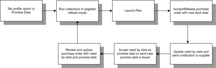

Your material requirement date might be different from the material availability date as provided by the supplier. The planning engine can consider either of the dates while generating a plan. Usually, you use the promise date in the purchase order as the date when the supplier supplies the material. However, in absence of the promise date, the planning engine uses the need by date as specified in the purchase order. If a supplier always meets the need by date irrespective of the promise date, you can set the MSC: Purchase Order Dock Date Calculation Preference profile option value to need by date.
This diagram illustrates the supplier acknowledgement cycle.
To instruct the planning engine which date to use for the arrival of a purchase order delivery (dock date):
Set the MSC: Purchase Order Dock Date Calculation Preference profile option. The valid values for this profile option are Need by Date or Promise Date. If you set the profile option to Promise Date, the planning engine considers the promise date from the supplier as the material arrival date. If you set this profile option value to Need by Date, the planning engine considers the need by date specified in the purchase order as the date of material availability. See MSC Profile Options for more information.
Run collections in the targeted refresh mode
Run the plan on the collected purchase orders to view the promise date and original need by date in the Planner Workbench.
The following steps detail the flow of information:
If you accept the calculated dock date and release the purchase order to Oracle Purchasing, Oracle Purchasing uses the suggested dock date as the new need by date. Oracle Purchasing leaves the original promise date unchanged. It sends a PO change notification to the supplier to acknowledge the rescheduled purchase order.
Using Oracle iSupplier Portal, the supplier can either accept the need by date as the promise date or specify a different promise date. If the supplier accepts the need by date, Oracle iSupplier Portal uses it as the promise date. If the supplier specifies a new promise date, Oracle iSupplier Portal sends a change request notification to the buyer.
The buyer can review and update the need by date and promise date for the purchase order in Oracle Purchasing.
After the next plan run, you can view the suggested dock date, the original need by date, and the new promise date in the Planner Workbench.
If the supplier provides a sales order number at the time of acknowledging the purchase order, Oracle Collaborative Planning creates a sales order that is pegged to the purchase order. The promise date is set as the delivery date. If the supplier changes the promise date or the quantity, an exception is created in Oracle Collaborative Planning.
If the purchase order is not firm or within the planning time fence, Oracle Advanced Planning and Scheduling can recommend rescheduling of the purchase order when the plan is run again.

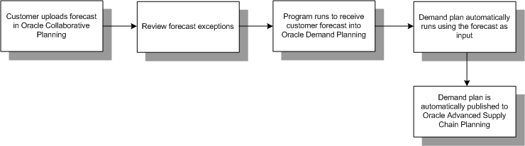

You can set up collaboration between Oracle Advanced Supply Chain Planning and Oracle Demand Planning to automatically launch an unconstrained supply chain plan based on forecast scenarios that you publish.
Set the profile option MSD: Default DP Scenario to a valid demand plan scenario.
Set the profile option MSC: New Forecast Auto Plan to an unconstrained supply chain plan. When the demand plan scenario mentioned in the profile option MSD: Default DP Scenario is published, the unconstrained supply chain plan specified in the profile option MSC: New Forecast Auto Plan starts running.
The following figure illustrates the activities that are performed after the customer uploads the forecast in Oracle Collaborative Planning.
Demand to Supply Planning Automation Cycle
After the customer uploads an order forecast using flat files or the user interface, you can review the exceptions to address the mismatch between the forecast you generated and the customer forecast. The Receive Forecast From Customer program automatically runs to receive the forecast into Oracle Demand Planning. Oracle Demand Planning Engine publishes the new demand plan scenario to Oracle Demand Planning Engine Server. This action automatically launches the unconstrained supply chain plan specified in the profile option.

Suppliers need to upload supply and demand information in Oracle Collaborative Planning. This launches Supply Chain Event Manager to compute material excess and generate shortage exceptions. Supply Chain Event Manager also generates a notification.
Suppliers can upload or enter forecasts into Oracle Collaborative Planning. When the supplier clicks the Send Supply Commit to customer link in the Admin tabbed region, the Receive Supplier Capacity concurrent process runs. This process updates the supplier capacity information on the planning server. If the profile option MSC: New Supply Commit Auto Plan points to a valid plan, the plan is automatically launched.
