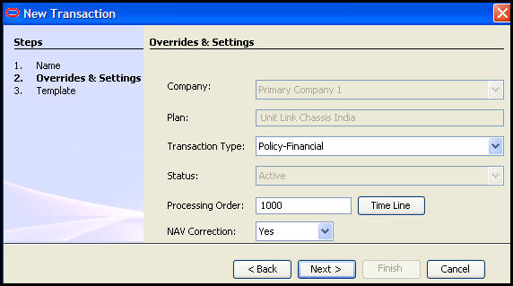

  1. Enter the following items: (Refer to Transaction Type and Processing Order for further information.)
    1. Select the transaction type. A plan type transaction, such as Plan-Financial, when processed will apply to all policies in that plan. A policy type transaction, such as Policy-Financial, when processed will apply only to the policy it is added to. The plan type transaction will reside in the Plan Transactions folder under Transactions in the Main Explorer. The policy type transaction will reside in the Policy Transactions folder under Transactions in the Main Explorer.
    2. Enter the processing order for the transaction.
    3. Select Yes in the NAV Correction drop down box if the transaction is a financial transaction.
    4. Click Next.

Transaction Settings in Wizard
Step 2 of New Transaction Wizard
