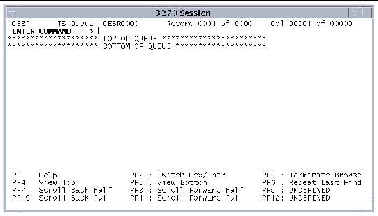

Use the CEBR transaction to browse temporary storage and to retrieve and insert data into intrapartition queues.
To start, type the CEBR transaction; no parameters are accepted. To terminate the transaction, press PF3.
When the transaction starts, it defaults the initial temporary storage queue to CEBRxxxx, where xxxx is equal to the terminal identifier of the terminal issuing the request.
The following figure shows the default CEBR screen.
After CEBR starts, it accepts commands both on a command line and by using the PF keys. The information displayed on the screen depends on the data written to the viewed queue.
CEBR accepts the following commands on the command line:
These function keys are active while in the CEBR transaction:
Switches the display from character to hexadecimal or from hexadecimal to character. |
Searches for the next occurrence of the previous find command. |

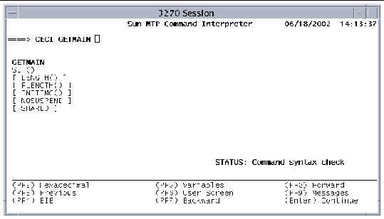

The following figure shows the Syntax screen after you select the GETMAIN command. Note that the status is Command syntax check.
The Syntax screen uses the following symbols:
Options in the option list appear in bold after you type them on the command line. The command line is also in bold. |

1. On the Commands Screen, type a command such as GETMAIN, and press Enter.
The Syntax Screen is displayed with the CECI GETMAIN command. Note that the STATUS is Command syntax check.
a. Type one or more options and arguments on the command line.
You can press Enter after each option or wait until typing all the options.
b. While creating the command, you can press PF5 to display the Variables screen where you can define or view variables, such as &MYSET.
See Variables Screen for more information about defining variables.
c. While creating the command, press PF2 to toggle between hexadecimal and character/decimal display of variable values.
d. Repeat these procedures as many times as necessary to build the complete command.
e. When you finish creating the command, press Enter.
FIGURE 2-4 shows a complete command.

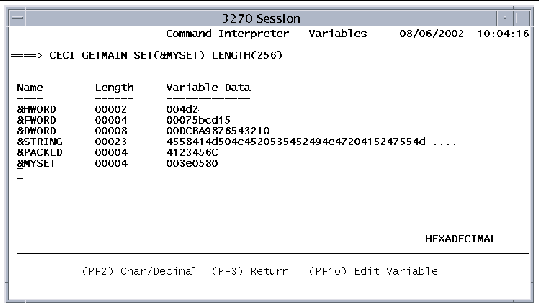

CECI allows you to define variables to use as option arguments in the command syntax. Because the lifetime of the variables you define is equal to the duration of the CECI session, you can use them to carry forward data returned from the execution of one command to subsequent commands.
After you define a variable, you can use it in a command line. When the command syntax is expanded, the value of the variable is substituted for the variable name. Any change to a variable value during execution of the command is reflected on the Syntax and Variables screens.
An example of each variable type is defined when CECI is initialized. You can view the examples by pressing PF5 on the Commands or Syntax screens. The following figure shows a Variables screen (in character/decimal mode) that has the five pre-defined variables and a user-defined variable named &MYSET.
The following function keys are active on the Variables screen:
Toggles the display from character/decimal (the default) to hexadecimal. |
Returns to the previous screen. If you press PF3 without pressing Enter, any changes you made on the Variables screen are lost. |
Opens the Edit Variables screen, described in Edit Variable Screen. |
You can press the Enter key after making any change on the Variables screen or you can press it once at the end of the Variables screen session to process all changes. |

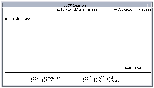

The Edit Variable screen enables you to edit user-defined variables in full screen mode. You can edit all variable types on this screen. You must use this screen to edit Buffer variables whose lengths are greater than the 40-byte limitation of the Variables screen (20 bytes when the display mode is hexadecimal).
1. On the Variables screen, position the cursor on a line containing the variable to edit.
2. Press PF10 to display the Edit Variable screen.
4. Press Enter to accept the change.
5. Press PF3 to return to the Variables screen.
The following figure shows the Edit Variable screen.
The following function keys are active on the Edit Variable screen:
Toggles the display from character/decimal (the default) to hexadecimal. When labeled Decimal/Char, switches the screen from hexadecimal to character/decimal. |

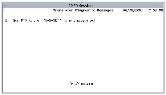

Before executing a command, CECI invokes a translator that checks the syntax of the command line. If the translator detects an error, it displays the following message on the Syntax screen:
You can view diagnostic messages by pressing PF9.
The Translator Diagnostic Messages screen shown in FIGURE 2-12 shows the message generated by the following incorrect command:
Notice the misspelling of DATASET as DAXASET.
Press PF3 to return to the previous screen.

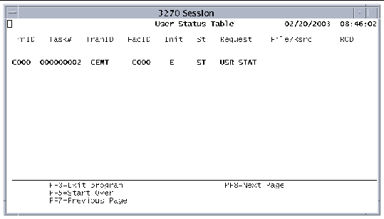

When you execute the CEMT INQ transaction for tasks, such as CEMT INQ TASK ALL, the User Status Table is displayed.
[ D ]
The User Status Table contains the following fields:

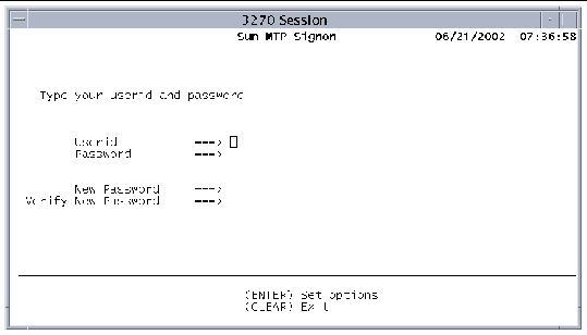

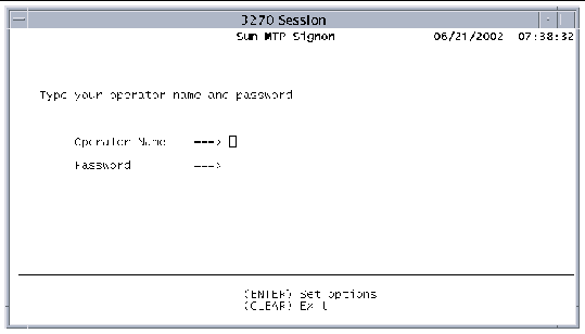

The CESN and CSSN transactions use the SNT to validate the user's ID and password. User programs can access the SNT fields with the EXEC CICS ASSIGN command.
Type CESN alone or with data. If you type CESN alone, the screen in FIGURE 2-15 is displayed.
Security issue: When external security management is enabled (KIXSEC=YES), you cannot use the CESN transaction without a password. See Chapter 9.
[ D ]
When you type, the Password and New Password values are not displayed. To change the password, type the new password in both New Password fields. The Userid, Password, and New Password values are one to eight characters in length. The password is case-sensitive. Refer to the Sun Mainframe Transaction Processing Software Reference Guide for information about setting the password type.
Note - If you use the CESN transaction from a terminal that is already signed on, the previous user is signed off immediately. |
If you choose to enter all data with the CESN transaction identifier, use the format:
CESN USERID=userid,PS=password,[NEWPS=newpassword]
Type CSSN alone or with a password. If you only type CSSN, the screen in FIGURE 2-16 is displayed.
Security issue: When external security management is enabled (KIXSEC=YES), you cannot use the CSSN transaction without a password. See Chapter 9 for more information.
[ D ]
The password is case-sensitive; it must match the entry in the SNT.
If you are unable to log in and are working on an X terminal, press Ctrl-C to terminate the client; PF3 is not active on the signon screen.
If you choose to enter all data with the CSSN transaction identifier, use the format:
CSSN NAME=operator-name,PS=password
