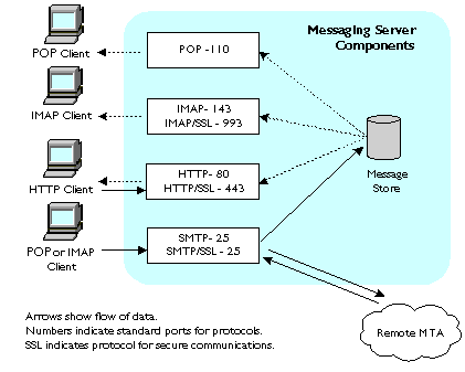

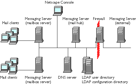

Each installed Messaging Server is one component of the messaging solution implemented for your enterprise. Figure 1.2 is a simplified diagram of the principal components that might be found in an enterprise messaging solution. (Service providers may have additional components, as discussed in Enterprise vs. ISP Topologies.) How your Messaging Server needs to interact with clients, with other Messaging Servers, and with the other components shown in Figure 1.2 will affect how you install, configure, and maintain the server.
Figure 1.2 Potential components of an enterprise messaging solution

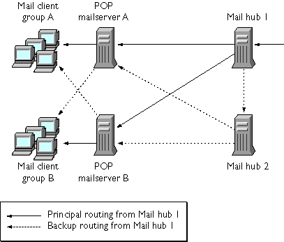

Server software is not perfect, nor are the host machines and network hardware it relies on. Almost any enterprise needs to plan for backup and for failover in case any of its important servers go down.
Therefore, in designing a messaging installation, be sure to consider the consequences of a failure of each individual Messaging Server and its host machine. Usually this means providing extra, redundant machines that can automatically take over a given server's tasks if it should fail. In installations in which messaging is distributed among specialized machines, servers already used to implement distributed functionality and replication can also function as failover servers (see Figure 1.4.)
Figure 1.4 Redundancy in a portion of a messaging installation
Designing your messaging topology for redundancy and setting up automatic failover capability can add greater complexity to an already complex configuration in a large installation.

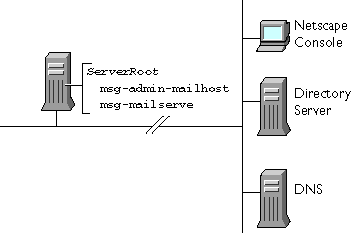

All Services on One Host
A one-host configuration (shown in Figure 1.5) can be practical for smaller installations. It economizes on server hardware at the expense of performance and capacity. (It also provides no backup, should the one server fail.) Nevertheless, it is possible to use a single host machine to house everything. Note that, in this configuration, the single server root (the directory into which all Netscape servers are installed) contains the three required Netscape servers--Messaging Server, Directory Server, and Administration Server--as a single server group (the set of servers managed by a single Administration Server). The single Directory Server in this case manages both the user directory (which contains mail-account information) and the configuration directory (which contains server-configuration information). The DNS service and Netscape Console are also on the same host machine.
Figure 1.5 All messaging-related services on a single host
In this configuration the one host machine must have sufficient performance capacity to handle all services without undue strain. It must also have sufficient storage capacity to hold all messages and all directory information for the enterprise.

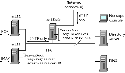

Another common deployment configuration, especially in larger installations, is to implement only certain messaging services on each host machine. As shown in Figure 1.7, for example, a centralized mail hub server, using only SMTP, connects to individual mailbox servers that use only POP or only IMAP to send mail to their users.
Figure 1.7 Mail hub and mailbox servers on separate hosts
This configuration can increase security (because outsiders can connect only at one point, the mail hub), and it allows for optimizing each server machine for the specific service (SMTP, POP, IMAP) that it supports.

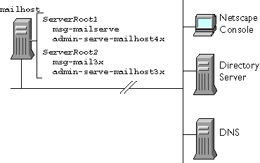

If a single host machine includes Netscape servers that have different version numbers, it may be necessary to create separate server groups, and thus separate server root directories, on the machine. Figure 1.9 shows an example in which some employees in an enterprise are using Netscape Messaging Server 3.0, while others have upgraded to Netscape Messaging Server 4.1. Both servers are running on the same host machine.
Figure 1.9 Two versions of Messaging Server on a single host
This configuration may be necessary because different versions of Messaging Server may require different directory structures or different versions of the Administration Server. The Netscape Server Setup program facilitates this configuration, letting you create a separate server root when you install new servers and leaving an existing server root undisturbed.
This configuration is commonly used for pilot deployment of new server versions, for creating a temporary setup until all users migrate to the newer version, or even for failover protection, with different server instances stored on different physical storage devices.

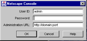

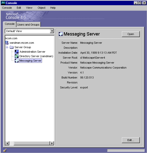

Installation is complete. You can now use Netscape Console (see Using Netscape Console) to continue configuring the server (see Configuring General Messaging Capabilities and Where to Go from Here).
