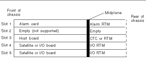

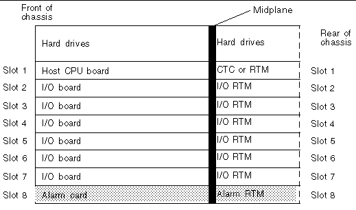

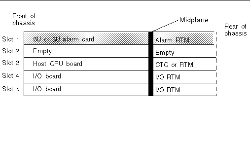

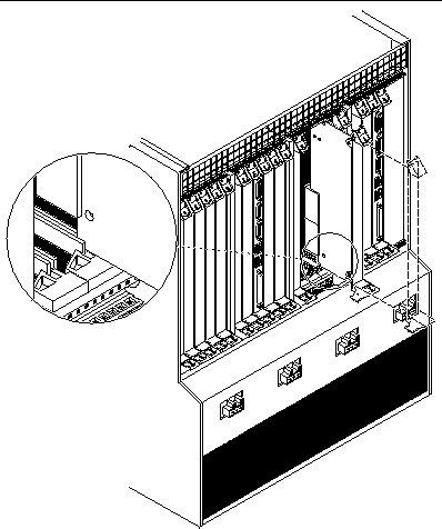

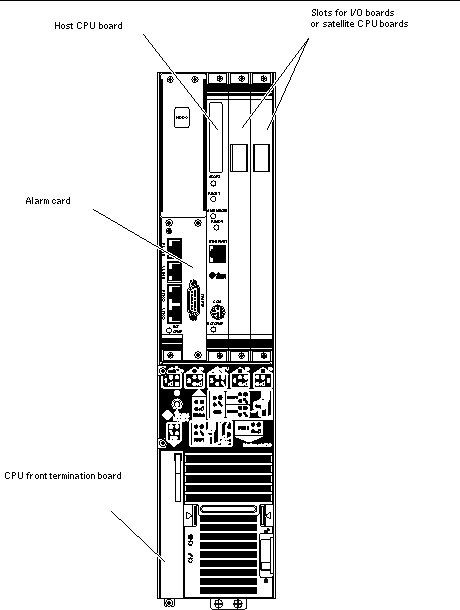

FIGURE 6-1 shows the locations of these boards in the Netra CT 810 server. FIGURE 6-2 shows the locations of these boards in the Netra CT 410 server.

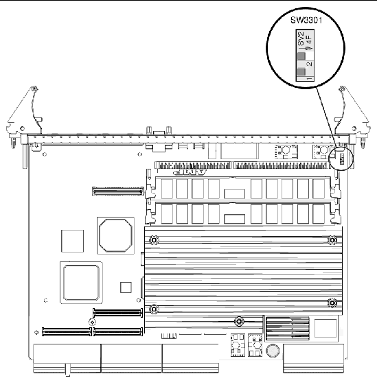

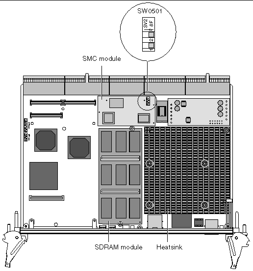

4. If you are installing a Netra CP2140 host CPU board into a Netra CT server, ensure that the switch settings on the SW0501 switches are set for the default, non-high-availability settings. The Netra CT server supports high-availability hot-swap; however, because the alarm card controls the high availability on the Netra CT server, the settings on the SW0501 switches on the Netra CP2140 host CPU board must be set in the default, non-high-availability settings.
Following are the correct settings for the SMC module switch SW0501 for the Netra CT server (see FIGURE 6-3 and FIGURE 6-4):
5. If you want to reconfigure a Netra CP2500 board from another server or slot where the board was used as a CompactPCI switched backplane (cPSB) board, change the SW3301 dip switch settings to reconfigure the board as a cPCI satellite board. See FIGURE 6-5 for an illustration of the correct settings for use as a cPCI board.

FIGURE 6-1 shows the locations of the boards in a Netra CT 810 server. FIGURE 6-2 shows the locations of the boards in a Netra CT 410 server.

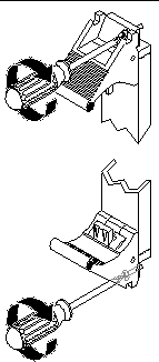

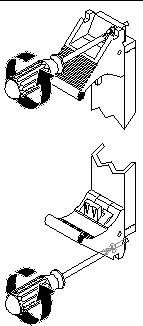

9. Using a No. 2 Phillips screwdriver, loosen the two captive screws inside the board's ejection levers, one on top and one on the bottom (FIGURE 6-6).
10. Unlock the ejection levers.
Caution - Only unlock the ejection levers at this point; do notunseat the board until the LEDs on the system status panel are in the proper state. |
The method you use to unlock the ejection levers varies depending on the model of the ejection lever used on the board; for example, one model uses red tabs at the top and bottom to unlock the board (FIGURE 6-7). Refer to the documentation that came with the board for instructions on unlocking the board.

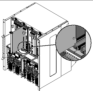

14. Press outward on the two ejection levers on the board to unseat the board from the board cage.
15. Carefully slide the board out of the slot and place it on an electrostatic discharge mat.

2. Locate the board slot where you are installing the board.

9. Keeping the board vertical, slide the board into the slot between the two guides.
The cuts in the handle of the board must align with the square cutouts in the slot. When the board is completely seated in the board cage, the two ejection levers flip inward, and the notches in the ejection levers fit smoothly in the rectangular cutouts in the bottom and top plates.
The method you use to lock the ejection levers varies depending on the model of the ejection lever used on the board. Refer to the documentation that came with the board for instructions on locking the ejection levers.

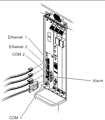

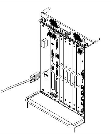

20. Connect the cables to the board.
Tighten the screws on the cable to a torque of 0.23 N.m (2 in.-lb).

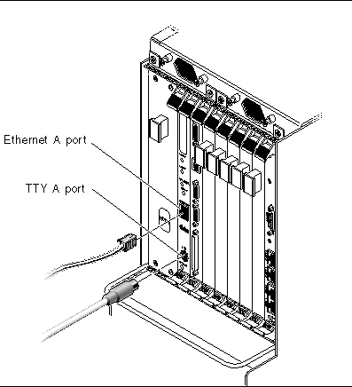

The following figures show the connectors for the boards available for the Netra CT servers:
For the connectors on the satellite CPU and I/O boards, refer to the documentation that you received with those boards.
See Appendix A for connector pinouts for each board, if necessary.

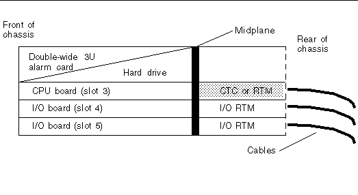

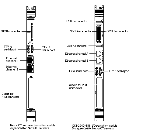

The following rear transition modules extend the ports from the host and satellite boards to the rear:
This section contains procedures for the installation, removal, and replacement of the following hot-swappable modules for the Netra CT 410 server and Netra CT 810 server:
This section explains how to remove and replace host rear transition modules.
The following are the possible pairings of host boards with rear transition modules:

FIGURE 6-16 and FIGURE 6-17 show the connectors on host rear transition modules.

This section describes the pairings of satellite boards and rear transition modules, and it explains how to remove and replace satellite rear transition modules (RTMs).
A satellite rear transition module set consists of two separate boards:
The satellite board is installed from the front of the Netra CT server; however, no cables are connected to the satellite CPU board.
The following are possible satellite board and rear transition module combinations:
The rear transition module extends the ports from the PMCs installed in the satellite CPU board to the PMC I/O module (PIM) installed in the satellite CPU rear transition module. The satellite CPU board must be installed in the same slot at the front of the server for the satellite CPU rear transition module to work. For example, if you install a satellite CPU rear transition module in I/O slot 3 at the rear of a Netra CT 810 server, you must install the accompanying satellite CPU board in I/O slot 3 at the front of the server.
When one of the two components fails, you might not be able to determine which of the components failed. Because of this, you might want to replace both the satellite CPU board and the satellite CPU rear transition module. FIGURE 6-21 and FIGURE 6-22 show graphical representations of how the satellite CPU boards align with the satellite CPU rear transition modules. If you are facing the front of the server, the I/O slots read from left to right, whereas they read from right to left if you are facing the rear of the server.
The I/O rear transition module set consists of two separate boards:
The I/O board contains the application-specific integrated circuit (ASIC) for the associated I/O board and is installed from the front of the server; however, no cables are connected to the I/O board.
The I/O rear transition module extends the ports for a particular I/O board to the rear of the server. The I/O rear transition module and the I/O board must be installed in the same slot at the front of the server for the I/O rear transition module to work. For example, if you install an I/O rear transition module in I/O slot 3 at the rear of a Netra CT 810 server, you must install the accompanying I/O board in I/O slot 3 at the front of the server.
When one of the two components fails, you might not be able to determine which of the components failed. Because of this, you might want to replace both the I/O board and the I/O rear transition module. FIGURE 6-21 and FIGURE 6-22 show graphical representations of how the I/O boards align with the I/O rear transition modules. Note that, if you are facing the front of the server, the I/O slots read from left to right, whereas they read from right to left if you are facing the rear of the server.

b. If you want to reconfigure a Netra CP2500 RTM-S from another server or slot where the board was used as a cPSB satellite transition module, change the SW3301 dip switch settings to reconfigure the board as a cPCI board.
FIGURE 6-5 shows the dip switch settings required for the Netra CP2500 RTM-S to be used as a cPCI board.
