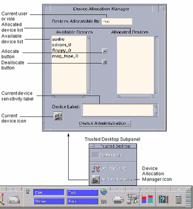

  1. A) Select Allocate Device from the Trusted Path menu.
    This step causes the Device Allocation Manager to be displayed.
    OR
  1. B) Select Device Allocation Manager from the Trusted Desktop subpanel in the Front Panel.
    This is an alternative step for displaying the Device Allocation Manager (see below).
    Figure 4-15 Selecting the Device Allocation Manager from the Trusted Desktop Subpanel
    Graphic
  2. Look in the available device list for the device you wish to use.
    The devices that you are permitted to allocate at your current sensitivity label appear in this list. Table 4-1 shows some typical device names.

  3. Move the device from the Available Devices list to the Allocated Devices list.
    You can accomplish this by:
    • Double-clicking the device name in the Available Devices list
    • Selecting the device and clicking the Allocate (right-pointing) button

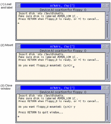

    This step opens a cmdtool window running a clean script. The clean script ensures that there is no data left over on the medium from other transactions.
    Note that the sensitivity label of the current workspace will be applied to the device. Any data transferred to or from the device's medium must be dominated by this sensitivity label.
  4. Follow the instructions in the clean script, which are (1) load and make sure the medium has the correct sensitivity label, (2) mount the device, and (3) press return to close the cmdtool window.
    Figure 4-16 Clean Script During Allocation
    Graphic
    At this point, the medium has been cleaned and the device has been mounted and is ready to be used. The device name now appears in the Allocated Devices list.

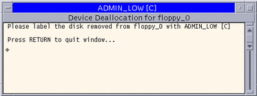

  6. Deallocate the device when you are finished.
    For the sake of security, you should always deallocate a device when you are finished using it. You can accomplish this by:
    • Double-clicking the device name in the Allocated Devices list
    • Selecting the device and clicking the Deallocate (left-pointing) button
    Deallocating a device opens a cmdtool window and runs a clean script that advises you about the labeling of the medium (see below). The script also unmounts the device.
    Figure 4-17 Clean Script During Deallocation
