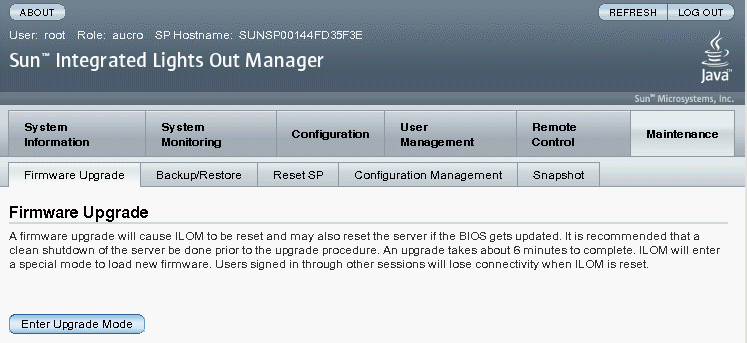

  2. Select Maintenance –> Firmware Upgrade.
    The Firmware Upgrade page appears.
    image:Firmware Upgrade page.
  3. In the Firmware Upgrade page, click Enter Upgrade Mode.
    An Upgrade Verification dialog appears, indicating that other users who are logged in will lose their session when the update process is completed.
  4. In the Upgrade verification dialog box, click OK to continue.
    You are prompted to select an image file to upload.
    image:Upgrade verification dialog box.

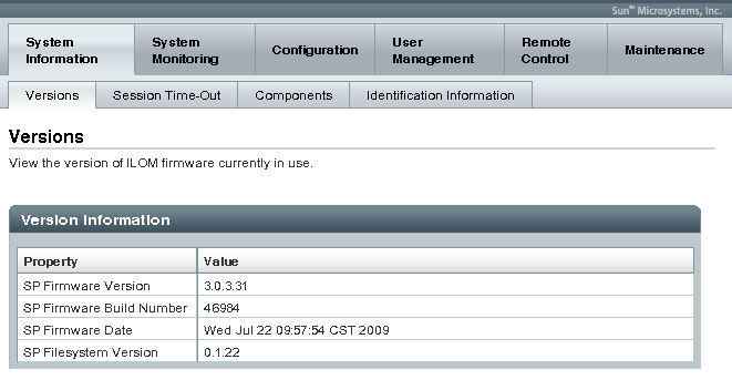

  9. Log in to the SP ILOM web interface.
  10. Select System Information –> Version to verify that the firmware version on the SP or CMM corresponds to the firmware image you installed.
    image:Example of ILOM Versions screen.
