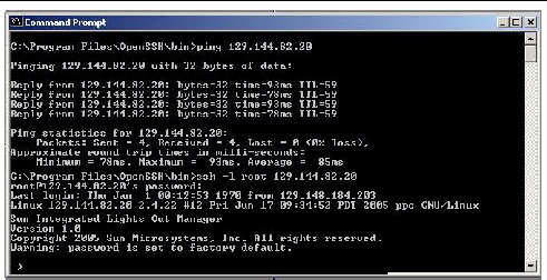

4. Open a session to the ILOM SP using the IP address that you obtained in Step 3.
You can use the CLI or the web interface.
# ssh -l root 129.144.82.20
The default user name is root, which was included in the ssh command. When you are prompted, enter the default password for the SP, changeme. You can then enter commands to manage user accounts or to monitor the status of devices on your server. See the example in FIGURE 2-2.

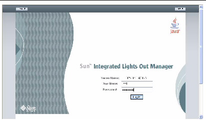

For example, if the IP address for your ILOM SP was 129.144.02.20, you would enter it as shown in FIGURE 2-3. The first web page prompts you for the default username, root, and the default password, changeme.
FIGURE 2-3 Opening a Session With a Web Interface
Graphic showing opening a session with a web interface.

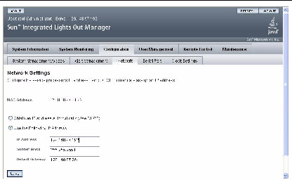

4. Choose the Configuration tab and its Network tab to display information about the current network configuration of your ILOM SP. See FIGURE 2-4.
5. Select the Use the Following IP Address option and type your static IP address information. See the example in FIGURE 2-4.
FIGURE 2-4 Integrated Lights Out Manager Network Settings Page
Graphic showing ILOM web interface with the Configuration and Network tabs chosen, and with the Use the Following IP Address button selected.
