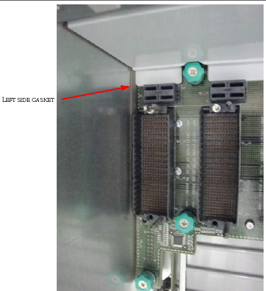

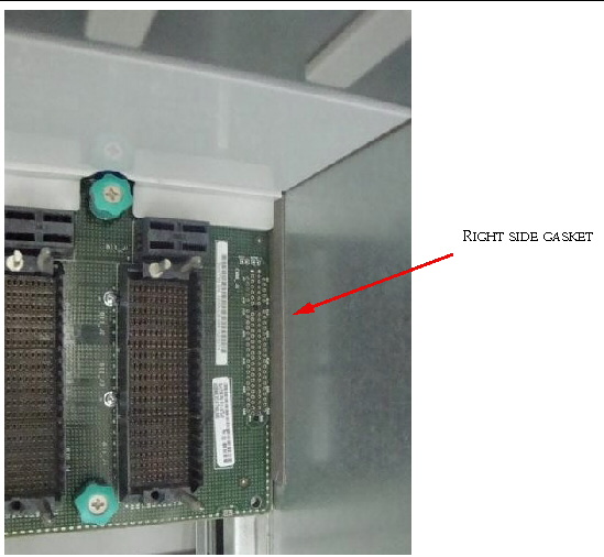

Important Caution for Chassis Midplane Replacement
When replacing a chassis midplane, follow the sequence listed below to avoid damage to the midplane. Refer to the Sun Blade 6048 Modular System Service Manual for detailed instructions on removing and installing a midplane.
To replace the chassis midplane:
1. Remove the chassis midplane.
2. Pull off the gasketing material attached to the left and right sides of the chassis.
See FIGURE 2-1 and FIGURE 2-2 for the positions of the gasketing material in the chassis.
3. Install the new midplane.
Do not re-install the gasketing material.
caution icon Caution - Thermal damage to the chassis can occur. Failure to remove the gasketing material prior to installing the midplane might result in damage to chassis.
FIGURE 2-1 Position of Gasket on Left Side of the Chassis
Position of gasket to the left of the chassis
FIGURE 2-2 Position of Gasket on Right Side of the Chassis
Position of gasket to the right of the chassis
