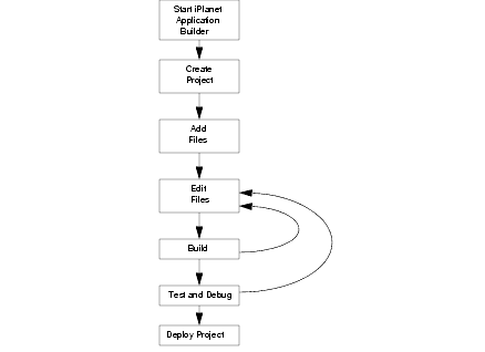

The following flowchart shows the basic steps for developing an iPlanet Application Server application:
Figure 3-1    Development of an iPlanet Application Server
This section summarizes the development process. Separate sections describe each step in more detail, along with a simple example.
Start iPlanet Application Builder.
The remaining sections describe each step of the development process in more detail.
Create a project.
- This step assumes you have completed the preliminary planning and design tasks, as described in "Designing Applications.".
Add files to the project.
- When you create a project, iPlanet Application Builder generates a minimum set of files, and they serve as the project's foundation.
Edit files.
- By reviewing the previously established application design, you know what functionality your application needs, and you know how many web pages the application consists of. These considerations determine what kind of files to add, as well as how many. You can add files one at a time, but you can also use wizards to quickly add a set of files associated with a specific application feature, such as a login page.
Compile individual files or build the entire project.
- As you add files to a project, you can edit them by creating content, by inserting or modifying functionality, or by inserting or modifying the links between them. Different types of files appear in different editor windows. During the editing phase, you use the palette with HTML files. You also use the properties window to review or modify parameter-based information.
Test and debug individual files or the entire project.
- After adding and editing a few files, you may decide to compile the Java files in the project so far. You can compile an individual file, or you can build the project, which compiles all Java files. As indicated in the previous diagram, you may need to return to the editing phase if compilation errors occur.
Deploy the project.
- After you successfully build the project, you can test it on a server to preview runtime behavior. Testing and debugging go hand in hand, because you can run the server in debug mode. As a result of testing and debugging, you may need to continue editing, then build again.

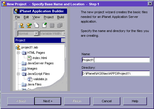

Creating a Project
A project is a container for related files that constitute an application. Once you define application requirements and design the application flow, you are ready to create a project. First, launch iPlanet Application Builder. Then, to create a project, choose "New Project" either from the Welcome dialog box or from the File menu.In either case, the new project wizard appears. This wizard guides you through the creation of a simple project, as shown in the following figure:
The graphic shows the files that the new project wizard can create; the files it actually creates depends on the files you choose to create using the wizard. These files are the foundation of a project. The default files are described in the following table:
Table 3-1 Default Project Files
Implements JavaScript-based validation for form components. For more information, see .
The wizard also creates a project.iab file, which contains information about the files in a project and other information used by the iPlanet Application Builder and the Application Server. This .iab file is the file that you choose when you open an existing project.

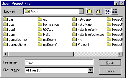

Opening a Project
Opening a project means opening its associated .iab file. You can open a project by using the File menu to choose Open Project, by clicking the Open Project button from the standard toolbar, or by double-clicking one of the files listed in the Welcome dialog box. When you open a file from the Welcome dialog box, you also can select "Browse for more projects" to search the file system for another .iab file.When you search the file system, a dialog box appears:
To open the Sample project, you double-click the Sample folder to list its .iab file. After selecting this file, you can double-click on it or click Open.
Only one project can be open at a time. If you try to open a second project when a project is already open, the first project closes after prompting you to save any changed files.

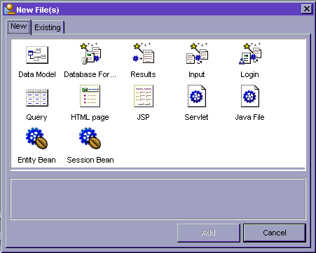

Creating Files
To create files, you can either pull down the Project menu and choose Add Files, or you can pull down the File menu and choose New and then choose Files. In either case, the New Files dialog box appears:
To create files, either double-click an icon, or select an icon and click Add. You can use the New Files dialog box to create the following individual files:
You can also use the following wizards to create various sets of files:

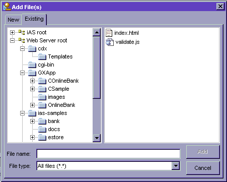

Adding Existing Files
Files that were created outside of iPlanet Application Builder are not automatically tracked by a project's .iab file (and are therefore not considered part of a project) unless you add these files explicitly using iPlanet Application Builder. The files you add must exist within the iAS applications directory tree or in the web server's document directory.To add files that were created outside of iPlanet Application Builder, perform the following steps:
Using your operating system, copy the files to the appropriate directory:
Copy HTML pages (static files), JavaScript files, and images to your web server's document directory.
In iPlanet Application Builder, display the Add Files dialog box by pulling down the Project menu and choosing Add Files. You can also choose New then Files from the File menu and select the Existing tab.Copy other files (queries, data models, Java source, Java Server Pages) to your project root.
Locate and select one or more files to add to the project.
Double click to add a file or click Add.

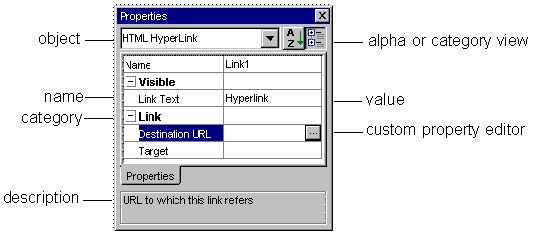

Viewing Properties
View and edit properties by using the Properties window.The object whose properties are being displayed appears in the top drop-down box. Property names appear in the left column, and their corresponding values appear in the right column. When a property is selected, its description appears in the description box at the bottom of the window.
Some properties have special features to help you edit their values. For more information, see Editing Properties.
Click the alphabetical view button
to view properties in alphabetical order. Click the category view button![]()
to view properties in order by category.The following illustration shows the Properties window in category view:
You can view the properties of any object in your project.

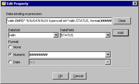

Editing Complex Data Expressions
A RowSet/RowField combination yields one column of data from a query. You can provide more than one column of data in a given data-binding, however, by using a custom-built data expression that states which RowSets and RowFields appear in the single display.To use a custom property editor to create a complex data expression, click the custom property editor button
in the data expression property definition. The custom property editor, shown below, appears:
In general, follow these steps for each RowSet/RowField combination you need in your expression:
Choose a RowSet and a RowField.
Choose a format mask, if needed.
Add any text or HTML markup, such as punctuation or spacing, between fields.
- The expression for that field, represented as <rdbm:field>, is added to the "Data-binding expression" box. At runtime, this expression is replaced with dynamic data.
When you have added all the <rdbm:field> tags you require, click OK to insert the data expression into your JavaServer Page.
- For example, if you add two RowFields called LastName and FirstName, you might want to add a comma and space between them by first adding LastName, then adding a comma and a space after the expression, then finally adding FirstName. The final product might look something like the following expression (note the comma after the valIn.LastName tag):
- <rdbm:field query="query" name="LastName"/>, <rdbm:field query="myquery" name="FirstName"/>

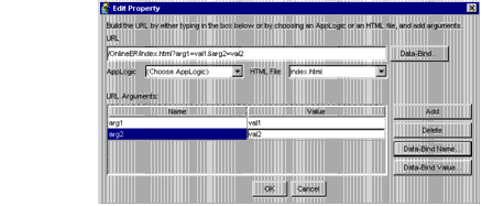

Editing Link URLs
A link URL is a target for a hypertext link. The target can be an HTML page, a servlet, or any other web object accessible from the user's browser.
To specify a link URL, click the custom property editor icon. The following illustration shows the resulting dialog box, with some sample data:
You can specify an object in your project by selecting an HTML page or a servlet from the drop-down boxes, or you can enter a URL by hand in the URL text box.
To add arguments (name/value pairs linked with = and separated by &), click Add and specify a name and value.
If this link is in an HTML page, you can bind any part of the URL to dynamic data from a servlet by clicking the associated Data-Bind button. Create a data-binding expression using the resulting dialog box as described in Editing Complex Data Expressions.

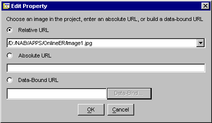

Editing Image URLs
The source code for an image on an HTML page or template is located by a URL. The URL can be relative to the page, or a fixed, absolute address. If the URL is in a JSP, it cannot be relative to the page; it must be either absolute or relative to the application root. If the image resides on a JSP, the source can be determined dynamically by a data binding.
To edit an image URL, click the custom property editor for the Image Source or Low Res. Source property.
To insert a relative URL to an image in your project, choose an image from the drop-down box.
To insert an absolute URL, click the Absolute URL radio button and enter the URL.
If this image is in an HTML template, you can determine the URL with dynamic data from a servlet by clicking the Data-Bound URL radio button and then clicking the associated Data-Bind button. Create a data-binding expression using the resulting dialog box as described in Editing Complex Data Expressions.

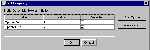

Editing List Items
Form list components, such as Drop-Down List, List Box, and Radio Button Group, are often populated by dynamic data in templates. On static pages or in templates where the list options are not dynamically generated, you can edit lists that are not data-bound by selecting the List Items property and clicking the custom property editor icon.The following dialog box helps you create list items:
Set up list items by creating name/value pairs. If you want an item to be selected by default at runtime, click the Selected checkbox for that option. To add or delete an item, click the appropriate button on the right. When you are finished editing list items, click OK, or click Cancel to abandon changes.
The Drop-Down List component creates a drop-down list with an HTML select statement with the attribute size=1. This implies that only one option can be selected at a time. If you check the Selected checkbox for more than one option, behavior at runtime is undetermined. In iPlanet Navigator 4.x, the drop-down box becomes a scrolling list one item high.
Similarly, to enable multiple values to be initially selected in the List Box component, you must ensure that the Multiple property is set to true.

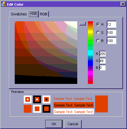

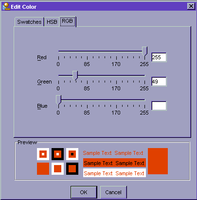

Editing Colors
Some properties indicate a color, which must be specified using either RGB (a hexadecimal number representing a combination of red, green, and blue) or HSB (a number representing hue, saturation, and value).You can edit color properties by specifying HSB values. The custom color editor helps you choose colors using either method. Click the tab corresponding with the method you prefer. When specify a color in one mode, the other mode is updated. In both tabs, the selected color is shown in the rectangle on the bottom right.
The following illustrations show the color property editor in HSB mode:
