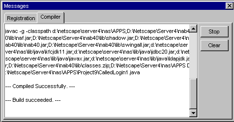

The Messages window (usually located just below the Properties window) is an information window that displays the associated compilation errors, warnings, and other data about your servlets.
To compile a single file, perform the following steps:
  1. Select the desired Java code file.
  2. Choose Compile file from the Build menu.
    Messages from the compiler appear within the output message window of iPlanet Application Builder, as shown in the following illustration. If the compiler finds an error, the location of the error is shown. The messages box that iPlanet Application Builder displays allows you to double-click on a line giving the position of a compile error; iPlanet Application Builder then displays that specific line of code.
    Click Stop to stop the compile process; click Clear to reset the message window.
    If the servlet contains no syntax errors, iPlanet Application Builder displays the Compiled Successfully message.
To compile all your Java files, perform the following steps:
  1. From the Build menu, choose Build Project.
    Messages from the compiler appear within the output message window of iPlanet Application Builder. If the compiler finds an error, the location of the error is shown. The messages box that iPlanet Application Builder displays allows you to double-click on a line giving the position of a compile error; iPlanet Application Builder then displays that specific line of code.
  2. Click Stop to stop the compile process; click Clear to reset the message window.

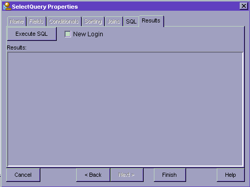

Testing Queries
iPlanet Application Builder enables you to test your queries before you deploy your application.
To test a query, perform the following steps:
  1. From the File menu, choose Open to open the desired query file or double-click the query file in the project map window or within the Project window.
  2. Click the Query Properties Results tab.
    iPlanet Application Builder displays the following dialog box:
  3. To execute the associated SQL code for the specified query, click Execute SQL. Note that you can also right-click the query file from the Project window and select Test to perform this action or from the Test menu, select Test MyQuery_Name.
    If you check New Login, iPlanet Application Builder displays a dialog box that enables you to specify the following information:
    • driver
    • data source
    • user name
    • password
    If input parameters are required for this query, iPlanet Application Builder displays a dialog box for you to specify them. Note that you must place string parameters in single quotes if the query doesn't supply them.
  4. Type the appropriate information for these fields and click OK.
  5. To test the SQL for a new login, click New Login.
    If the SQL code contains :<variables>, iPlanet Application Builder displays a dialog box for you to enter the associated input parameters.
  6. Click Finish if you are satisfied with the test results; otherwise, continue to edit the associated query SQL until you obtain the correct results. If iPlanet Application Builder cannot parse your SQL, all other query editing tabs are disabled except the SQL and Results tabs.
