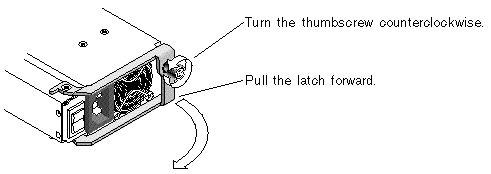

2. Turn the thumbscrew at the top of the power supply latch counterclockwise until the thumbscrew is disengaged from the power supply.
3. Pull the latch forward about 45 degrees to disconnect the power supply/fan module from the midplane.

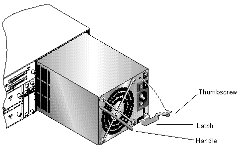

4. Use the power supply handle to pull the power supply/fan module out of the chassis.
