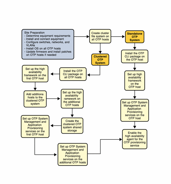

This section provides summaries of the high-level tasks that you will perform as part of the Open Telecommunications Platform site preparation, installation, configuration, and run time processes.
The following diagram illustrates the sequence of the high-level tasks for site planning, installation and configuration of the Open Telecommunications Platform software.
