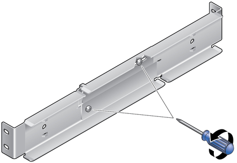

Note - The front-to-back rail spacing must be at least 392 mm (15.43 in.) and not more than 504 mm (19.84 in.) from the outside face of the front rail to the outside face of the back rail.
See Rack Cautions.

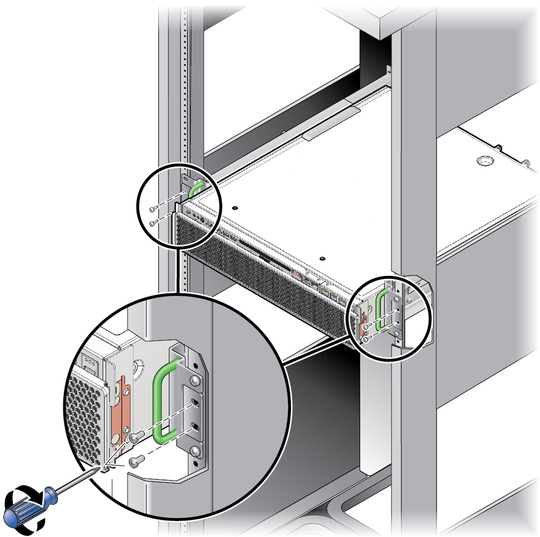

Using two screws, secure the front of the rail in the rack. The size of the screws varies, depending on your particular rack.
Do not completely secure the rear flanges to the adjustable rails. You will use these flanges to set the rack depth for the server in a later step.
The side rails can accommodate rack rail setbacks (the distance from the front of the rack to the rack rail) of 50 mm, 75 mm, or 100 mm, depending on the type of rack you are installing the server into.
If the rack is especially shallow, you can flip the rear flanges around so that they rest flush against the rear of the server.
