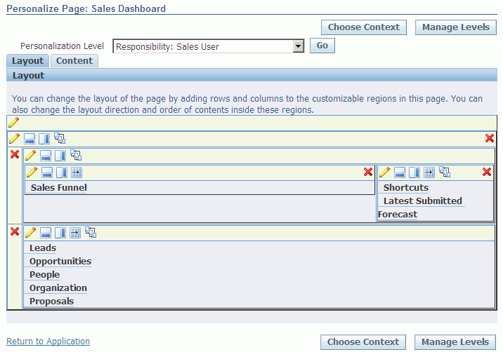

Layout Mode
The Layout mode of the Page Layout Personalization page renders boxes around each region on the page regardless of whether the region is a flexible layout or not. Control icons that allow you to configure a region, however, are displayed only for boxed flexible layout regions. The actual content of a boxed flexible layout region is not displayed. Note that in this particular example, the instruction text and region immediately below the Update Customer header is not a flexible layout region, therefore its content is fully displayed.
In the Layout mode, flexible layout content is simply represented as a header title within each flexible layout box. This frees up screen space so that all nested levels of flexible layout regions can be represented on the page without further drilling.
The Layout Mode Task Flows section below describes the personalizations you can accomplish in the Layout Mode.
If you wish to exit from the Page Layout Personalization page, select the Return to Application link at the bottom of the page to return to the original page.
Layout Mode of the Page Layout Personalization page for the Sales Dashboard page.

Reorder the children of a region
the picture is described in the document text
Launches the Reorder Contents page where you can reorder the children of the current region.
Add content to a layout region
Launches the Add Content page, allowing you to select predefined resource content from a catalog. The new content is added as the last child of the current layout region. You can add content to a layout region only if the layout has no other layout children.
