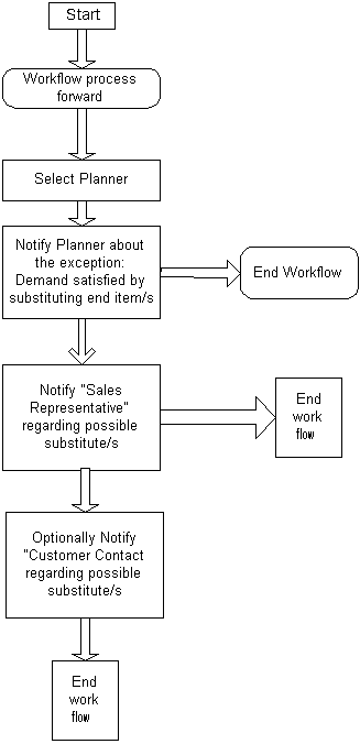

Follow work flow procedure to enable execution

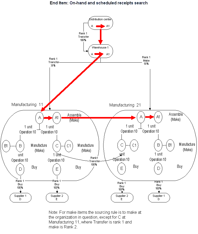

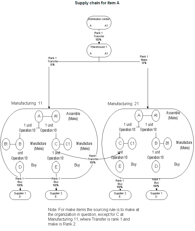

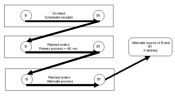

The section contains description of how substitution logic functions. It contains information about:
Searching the supply chain
Chaining
A demanded item or a substitute item could be available within the same organization or in a different organization within the supply chain. You can take advantage of availability of supply (both requested item and substitute items) across the supply chain and use up the inventory effectively before placing orders to make or buy the item. To search for demanded item or substitute items, the planning engine looks for demanded and substitute items within the same organization before looking in other organizations to find them.

An important point to note here is the direction of search when multiple levels of sources are involved. If you consider the following diagram, the Atlanta facility sources from Dallas and Miami, Dallas sources from Dallas-1, and Miami sources from Miami-1.

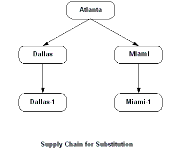

Supply Chain for Substitution
If you have item A and a substitute item A1 in all the organizations in the supply chain and if you have demand in Atlanta, the search follows the sequence mentioned below:
Look for on hand and scheduled receipts of item A and substitute A1 at Atlanta
Look for on hand and scheduled receipts of item A and substitute A1 at Dallas
Look for on hand and scheduled receipts of item A and substitute A1 at Miami
Look for on hand and scheduled receipts of item A and substitute A1 at Dallas-1
Look for on hand and scheduled receipts of item A and substitute A1 at Miami-1
The search across organizations is guided strictly by sourcing rules, bills of distribution, and the corresponding ranks for the sources. Summarizing the search process, Oracle APS looks for the demanded item (requested item) and all its possible substitutes within a facility and it continues to look for demanded item (requested item) and its substitutes in other facilities searching breadth first. Referring to the diagram, the search will follow:
Atlanta, Dallas, Miami, Dallas-1, and Miami-1
It is very important to note that the breadth-first search method is used in constrained plans. In optimized plans, the search is entirely driven by costs i.e., item costs, penalty costs for satisfying demand late, transportation costs etc. An optimized plan suggests transfers and substitutes based on the overall objective of the plan and costs mentioned above.

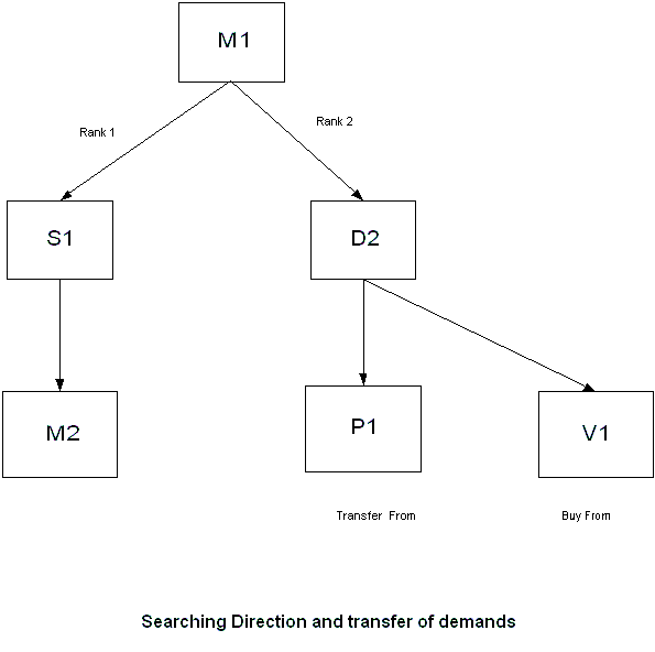

A supply chain is shown in the diagram below. In the diagram M1, S1, D2, M2, D2, and P1 are Organizations. V1 is a supplier. Organization M1 sources from S1 and D2 in a ranked order. Organization D2 sources from three different sources. (Make at, Transfer from, Buy From). Your desired search sequence is M1, S1, D2, M2, P1 and V1.
Figure title
The following tables show supply and demand for the organizations in the diagram.
In this example, you have two items; A and A1. A can use A1 supply due to substitution rules. Both item A and A1 are enabled in all organizations. Assume that you do not have any supplies at Organization M2, P1 and supplier V1.

For each occurrence of the exception message: Demand Satisfied by Using End Item Substitution, a workflow is initiated and sent to the planner associated with the original item. At this point you can end the workflow or notify the Sales Representative or the Customer Contact of the substitution.
Following is a diagram of the workflow initiated by the planning engine. You will notice that there is not an alternative to change the line item based on the workflow. Users can manually change the line items as long as the orders are in a pre-booking stage.
Workflow Initiated by the Planning Engine
The heading of the workflow is Demand Satisfied by Substituting End Items. The following details are shown in the workflow:

The diagram below indicates the planning logic for a component B with B1 as the substitute component. As shown in the diagram, Planning will look for projected available supply of item B (on hand and existing supplies) and then projected available supply for item B1. After that, Planning will recommend creating a planned order for item B using primary BOM/Routing and alternate resources. Planning will then generate planned orders for item B1 using primary BOM/Routing and alternate resources. If additional supply is needed, Planning will use the alternate BOM/Routing for item B and then for item B1 before looking to source items B and B1 from an alternate source/facility.
Planning Logic for Substitute Component

There is high demand placed on the distribution center
For optimized plans, cost effectiveness at each node across the given supply-chain is the same
Supply Chain for Item A
The planning engine searches on-hand quantity and schedules receipts (item A and end item substitute A1) across each tier before creating new planned orders for the demanded item. (Please refer to End Item Substitution chapter). To look for on-hand quantity and scheduled receipts of the demanded item and the end-item substitute, ASCP uses the search logic as specified below.
Distribution center for item A
Distribution center for item A1
Warehouse 1 for item A
Warehouse 1 for item A1
Manufacturing 11 for item A
Manufacturing 11 for item A1
Manufacturing 21 for item A
Manufacturing 21 for item A1
The following diagram illustrates the tier-by-tier search logic for on-hand quantity and scheduled receipts for end items.
Figure title
If there is no on-hand/scheduled receipts for either A and A1 or on-hand quantity is not adequate to satisfy demand, then ASCP will create the planned orders to satisfy net demand for A, B, C, D and E in the following method:
When creating planned orders for A:
Transfer A from Warehouse 1 to Distribution Center
Make A at Manufacturing 11 using primary resource and primary BOM/Routing and Primary components B (Refer to Planning for B at Manufacturing 11), C (Refer to Planning for C at Manufacturing 11), D (Refer to Planning for D at Manufacturing 11), and E (Refer to Planning for E at Manufacturing 11)
Make A at Manufacturing 11 additionally using alternate resource
Make A at Manufacturing 11 additionally using substitute components (B1, C1 if needed)
Make A at Manufacturing 11 using Alternate routings/BOM
Make A at Manufacturing 21 using primary resource and primary BOM/Routing and Primary components (B (Refer to Planning for B at Manufacturing 21), C (Refer to Planning for C at Manufacturing 21), D (Refer to Planning for D at Manufacturing 21), E (Refer to Planning for E at Manufacturing 21)
Make A at Manufacturing 21 using alternate resource
Make A at Manufacturing 21 using substitute components (B1, C1)
Make A at Manufacturing 21 using Alternate routings/BOM
Use on-hand/scheduled receipts for B in Manufacturing 11
Use on-hand/scheduled receipts for B1 in Manufacturing 11
Make B at Manufacturing 11 using primary Resources, BOM/Routing and component D (Refer to Planning for D at Manufacturing 11)
Make B at Manufacturing 11 using alternate resources
Make B1 at Manufacturing 11 using primary Resources, BOM/Routing and components
Make B1 at Manufacturing 11 using alternate resources
Make B at Manufacturing 11 using alternate BOM/Routing
Make B1 at Manufacturing 11 using substitute components
Make B1 at Manufacturing 11 using alternate BOM/Routing
Use on-hand for B in Manufacturing 21
Use on-hand for B1 in Manufacturing 21
Make B at Manufacturing 21 using primary Resources, BOM/Routing and component D (Refer to Planning for D at Manufacturing 21)
Make B at Manufacturing 21 using alternate resources
Make B1 at Manufacturing 21 using primary Resources, BOM/Routing and components
Make B1 at Manufacturing 21 using alternate resources
Make B at Manufacturing 21 using alternate BOM/Routing
Make B1 at Manufacturing 21 using substitute components
Make B1 at Manufacturing 21 using alternate BOM/Routing

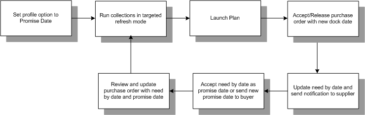

This diagram illustrates the supplier acknowledgement cycle.
To instruct the planning engine which date to use for the arrival of a purchase order delivery (dock date):
Set the MSC: Purchase Order Dock Date Calculation Preference profile option. The valid values for this profile option are Need by Date or Promise Date. If you set the profile option to Promise Date, the planning engine considers the promise date from the supplier as the material arrival date. If you set this profile option value to Need by Date, the planning engine considers the need by date specified in the purchase order as the date of material availability. See MSC Profile Options for more information.
Run collections in the targeted refresh mode
Run the plan on the collected purchase orders to view the promise date and original need by date in the Planner Workbench.
The following steps detail the flow of information:
If you accept the calculated dock date and release the purchase order to Oracle Purchasing, Oracle Purchasing uses the suggested dock date as the new need by date. Oracle Purchasing leaves the original promise date unchanged. It sends a PO change notification to the supplier to acknowledge the rescheduled purchase order.
Using Oracle iSupplier Portal, the supplier can either accept the need by date as the promise date or specify a different promise date. If the supplier accepts the need by date, Oracle iSupplier Portal uses it as the promise date. If the supplier specifies a new promise date, Oracle iSupplier Portal sends a change request notification to the buyer.
The buyer can review and update the need by date and promise date for the purchase order in Oracle Purchasing.
After the next plan run, you can view the suggested dock date, the original need by date, and the new promise date in the Planner Workbench.
If the supplier provides a sales order number at the time of acknowledging the purchase order, Oracle Collaborative Planning creates a sales order that is pegged to the purchase order. The promise date is set as the delivery date. If the supplier changes the promise date or the quantity, an exception is created in Oracle Collaborative Planning.

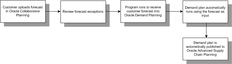

You can set up collaboration between Oracle Advanced Supply Chain Planning and Oracle Demand Planning to automatically launch an unconstrained supply chain plan based on forecast scenarios that you publish.
Set the profile option MSD: Default DP Scenario to a valid demand plan scenario.
Set the profile option MSC: New Forecast Auto Plan to an unconstrained supply chain plan. When the demand plan scenario mentioned in the profile option MSD: Default DP Scenario is published, the unconstrained supply chain plan specified in the profile option MSC: New Forecast Auto Plan starts running.
The following figure illustrates the activities that are performed after the customer uploads the forecast in Oracle Collaborative Planning.
Demand to Supply Planning Automation Cycle
After the customer uploads an order forecast using flat files or the user interface, you can review the exceptions to address the mismatch between the forecast you generated and the customer forecast. The Receive Forecast From Customer program automatically runs to receive the forecast into Oracle Demand Planning. Oracle Demand Planning Engine publishes the new demand plan scenario to Oracle Demand Planning Engine Server. This action automatically launches the unconstrained supply chain plan specified in the profile option.
