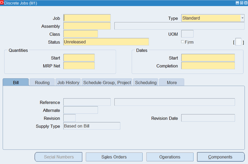

A discrete job is a production order for the manufacture of a specific (discrete) quantity of an assembly, using a specific standard routing and operations.
If you have Oracle Shop Floor Management installed, you can use lot based jobs in your manufacturing. A lot based job follows a network routing. Network routings provide flexibility in choosing the next operation which, in turn, determines the series of operations the job moves through. See: Creating a Network Routing and Creating a Lot Based Job in the Oracle Shop Floor Management User's Guide.
You can build released as well as unreleased revisions and engineering items. You can also add engineering items as material requirements. The system can automatically update your jobs following an engineering change order (ECO).
You can create ECOs and pass down the information to unreleased jobs to specify a cumulative quantity, a range of jobs, or implement changes for specific lots. You can also add, change, or disable - items, operations, resources, and attributes. See: Defining ECO Revised Items in the Engineering User's Guide.
Material control helps you manage the flow of component material from inventory to jobs. Bills of material can be used to create job material requirements. You can use reports and views to help you control material activities.
You can assign a predefined bill of material or routing to a non-standard job or create one manually. You may use any bill or routing for the job, including one that does not match the assembly item of the job.
When you define discrete jobs, you can create discrete job operations, resource requirements, and material requirements either concurrently or interactively. Interactive processing loads all bill of material and routing information while you wait, returning control to you after the process is complete. Concurrent processing spawns a background process that loads all bill of material and routing information and returns control to you immediately.
Standard discrete jobs control the material, resources, and operations required to build an assembly and collect its manufacturing cost.
Non-standard discrete jobs control material and collect costs for miscellaneous manufacturing activity. They may or may not build an assembly. This type of activity can include rework, field service repair, upgrade, disassembly, maintenance, engineering prototypes, and other projects. See: Overview of Non-Standard Discrete Jobs

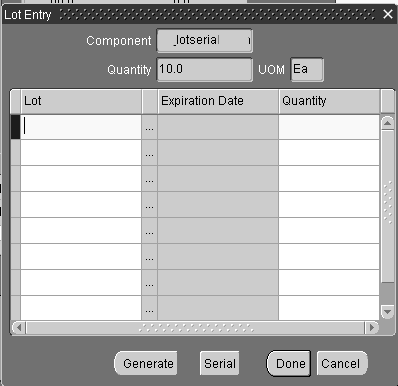

You can build jobs for assemblies under lot control, serial control, or both lot and serial control.
You can track your jobs using serial control throughout the manufacturing process. This enables you to assign, perform serial transaction entry, import serial numbers, and print serial number labels. This functionality is supported through Oracle Mobile Supply Chain Applications. See: Serial Number Tracking Throughout Manufacturing

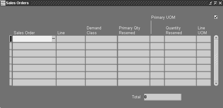

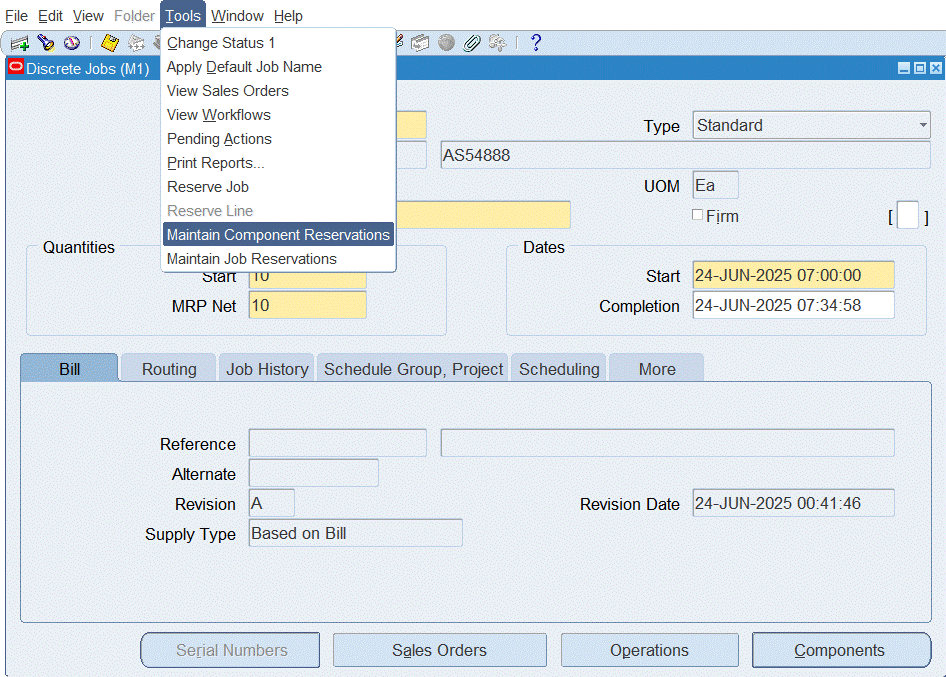

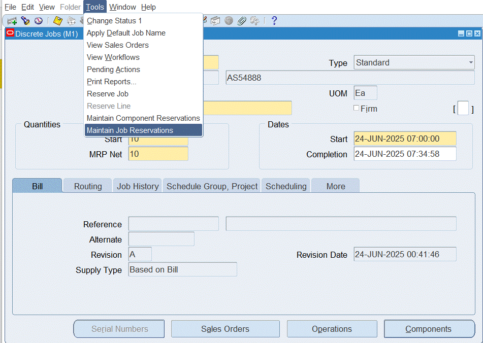

The Item Reservation window in Oracle Inventory is used to create reservations for material based on discrete jobs as a source of supply and demand. The Item Reservation window shows WIP material demand and supports creating reservations with WIP discrete jobs using the Demand Type value of Job or Schedule - Discrete Job. This Demand Type enables WIP material demand to be reserved for component items for discrete jobs ensuring that the material is available You can reserve component items automatically at the time of work order creation, or reservation can be initiated manually from the discrete job.
Additionally, material reservations for jobs can be initiated automatically at the time of job creation or job release using Work in Process parameters.
You can also reserve completed serialized assemblies for demand: a reservation record is created by selecting and reserving specific serialized assemblies against a sales order line. See: Item Reservations, Oracle Inventory User's Guide

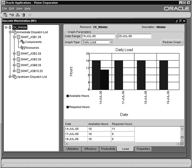

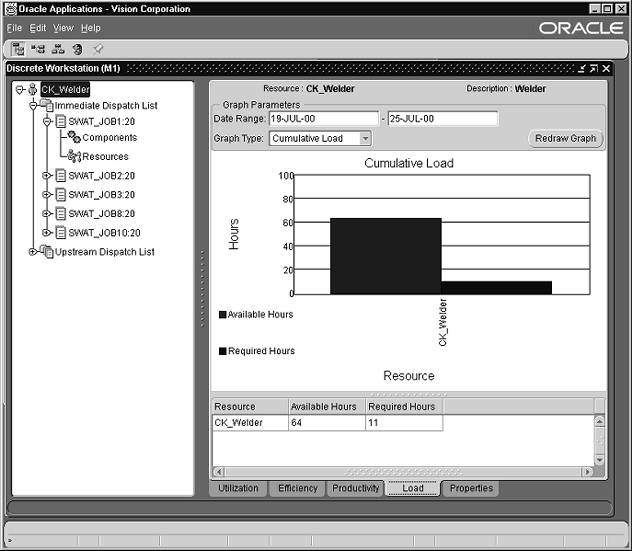

You can view broad information, such as the utilization, efficiency, productivity, and load on the resources within a department or on a specific resource across all departments. You also can obtain detailed component and resource information on each individual job scheduled for the department or resource. You can perform move, completion, and other common transactions directly on the workstation's tabs, or open their corresponding Work in Process windows directly from the workstation. There is also a link to Oracle Project Contracts records associated with specific jobs.

View the utilization, efficiency, productivity, and load on the resource from all departments in table and graph format

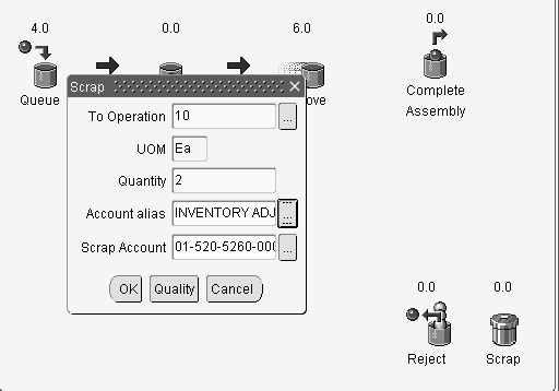

Scrap assemblies

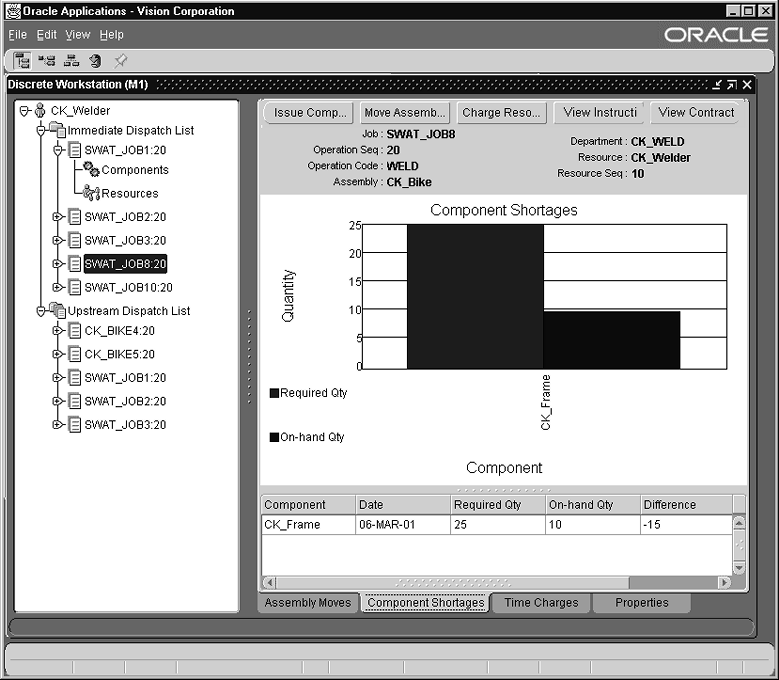

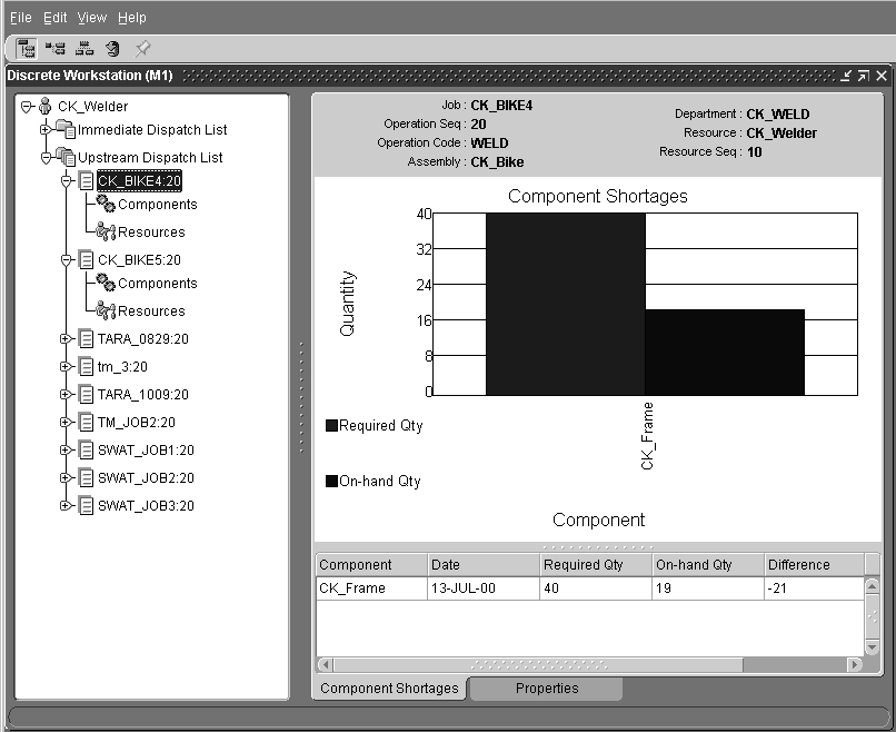

View job component shortages

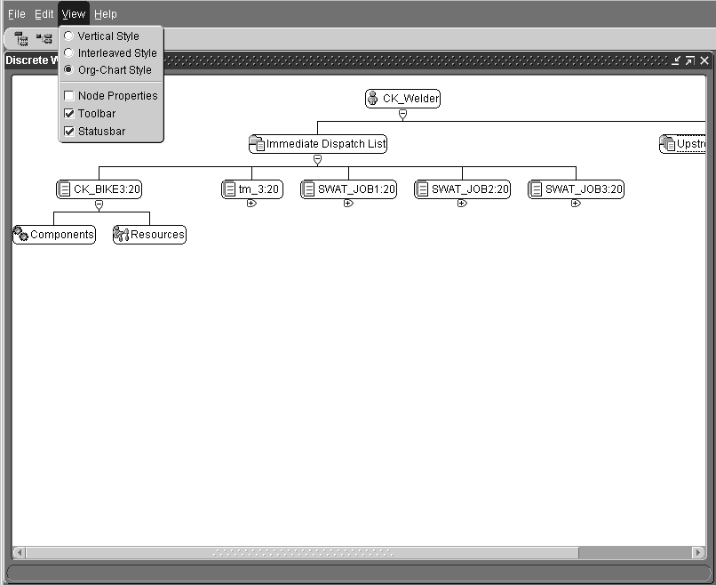

You can choose to view the information on the workstation tree in Vertical (the default), Interleaved (horizontal), or Org Chart (organization chart) format. These choices are available through tools on the toolbar, or as menu selections under the View menu.
To view the tree in Interleaved or Org Chart format, you may need to widen the left pane to see the full display. You can use your mouse to drag the right side of the pane towards the right side of the window, or you can hide the tabs so the window's full width can be used to display the contents of the left pane.
To hide the right pane of the workstation:
Select the View menu, and remove the check mark from the Node Properties check box. The right pane is hidden.
To again display the right pane of the workstation:
Select the View menu and place a check mark in the Node Properties check box. The right pane is displayed.

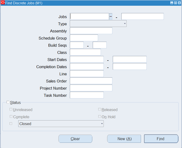

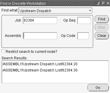

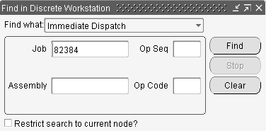

You can search for records on the tree. After entering search criteria on the Find in Discrete Workstation window, and choosing Find—a list of nodes meeting your criteria display on this window. Select a node to display that information on the workstation canvas.
To find records on the Discrete Workstation
Navigate to the Find in Discrete Workstation window.
In the Find what field, select a dispatch type: upstream or immediate.
Enter search criteria. You have the option to enter values in the Job, and corresponding Operation Sequence fields, or Assembly and corresponding Operation Code fields.
You have the option to search records in one node only. Select a note and search criteria, and check Restrict search to current node.
Choose Find. Choose Stop to end the search program while it is compiling.
A listing of nodes meeting your search criteria displays in the window.
Select a node to display that information on the workstation window.

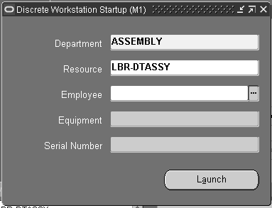

To launch the Discrete Workstation
Navigate to the Discrete Workstation to open the Discrete Workstation Startup window.
In the Department field, select the department to view.
To view all of the job operations scheduled in a department, select only the department
Select a Resource to view the job operations assigned to a resource associated with a specific department.
If you are using resource instances, you can select a defined Employee value for labor type resources—or an Equipment value for machine resources.
Optionally, select defined Serial Number values for machine type resources.
Choose Launch to display the Discrete Workstation.

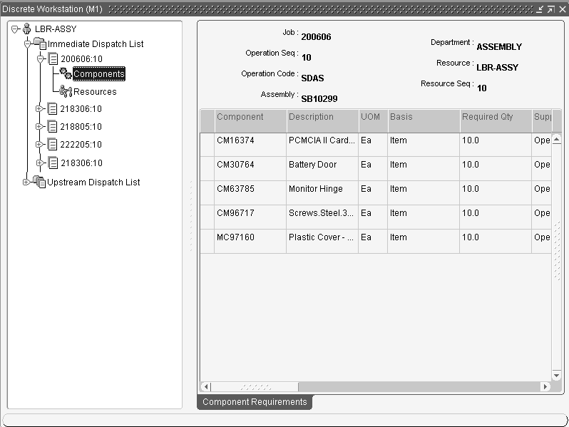

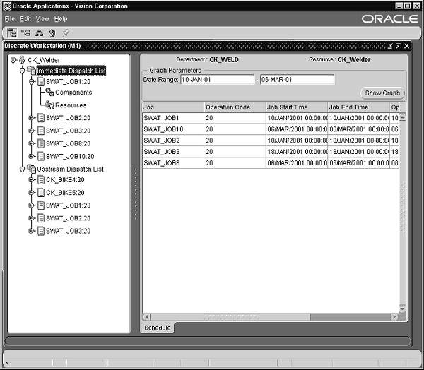

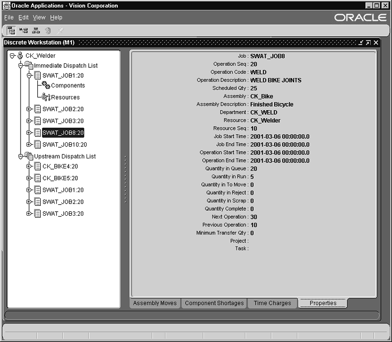

The first, topmost branch on the Discrete Workstation tree displays information for the department or the resource that you selected when you launched the workstation. Listed below it are its two main branches:
The Immediate Dispatch List branch, which displays all of the job operations that are ready to be worked on in the department or by the resource (there is a quantity of assemblies in its queue).

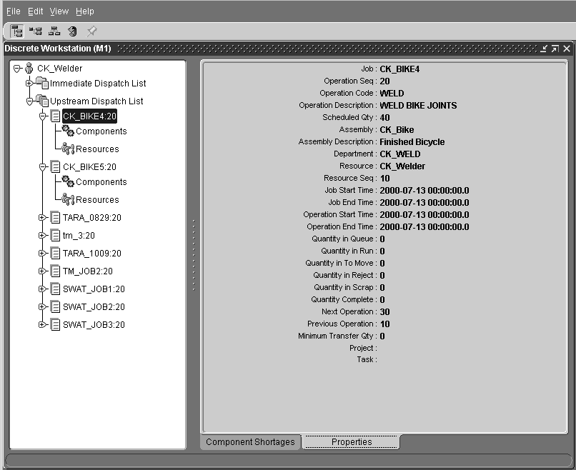

The Upstream Dispatch List branch, which displays all of the job operations that are to be worked on in the department or by the resource in the near future (there is a quantity of assemblies ready to be moved in the previous operation).
Expanding any of the individual job operation branches under either main branch displays two additional branches, the components and resources branches for that job.
The branch names displayed on the Discrete Workstation are automatically generated by the system. They contain the name of the job (which you created when you defined the job in the Discrete Jobs window), and the number of the operation, separated by a colon. For example: BIKE_Assy1:20 is the BIKE_Assy1 job at operation 20.

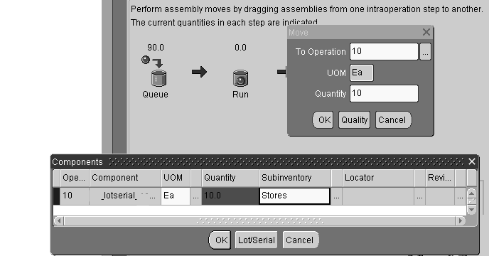

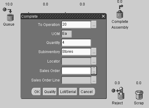

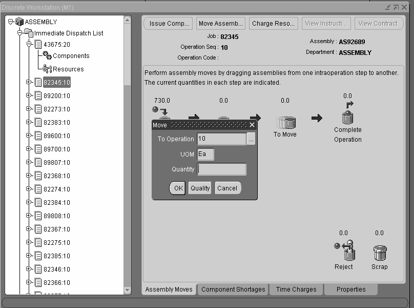

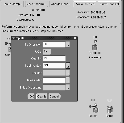

From the Discrete Workstation, you can issue components, move assemblies, complete assemblies and operations, and charge resources without having to return to the main menu. You can either perform the transactions directly on the workstation tabs, or open the appropriate Work in Process window for that transaction.
To issue components to a job from the workstation, you choose the Issue Components button, which opens the WIP Material Transactions window. All relevant job information is automatically defaulted into the window from the workstation. See: Component Issues and Returns.
During move and completion transactions, you can access the Enter Quality Results window when there are available collection plans. Choose Quality on the Move or Complete dialog box to navigate to this window.

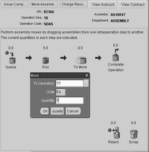

You can perform simple assembly Move transactions directly on the Assembly Move tab graphic using the mouse. The graphic displays a bucket for each intraoperation step, and uses a red ball to represent the assembly quantity. You have the option to move quantities across more than one operation in a routing. See: Moving Assemblies on the Workstation

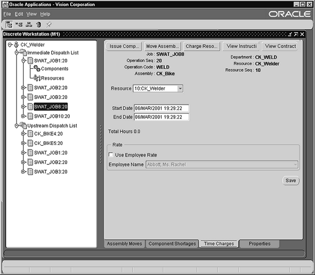

Resources are automatically charged when you move assemblies, unless you set them up to be charged manually. If you are set up to charge resources manually, you charge them on the Resource Transactions window, which you an open directly from the workstation by choosing the Charge Resources. All relevant job information is automatically defaulted into the window from the workstation.
You also can use the workstation Time Charges tab to charge person and machine time to a resource. On this tab, you select the resource that you want to charge, and enter the Start and End Dates, and the workstation calculates the time. The time is charged at the standard rate unless you select the Use Employee Rate check box, which charges the time at the employee rate.
See: Charging Resources Manually, and Charging Resources with Move Transactions.

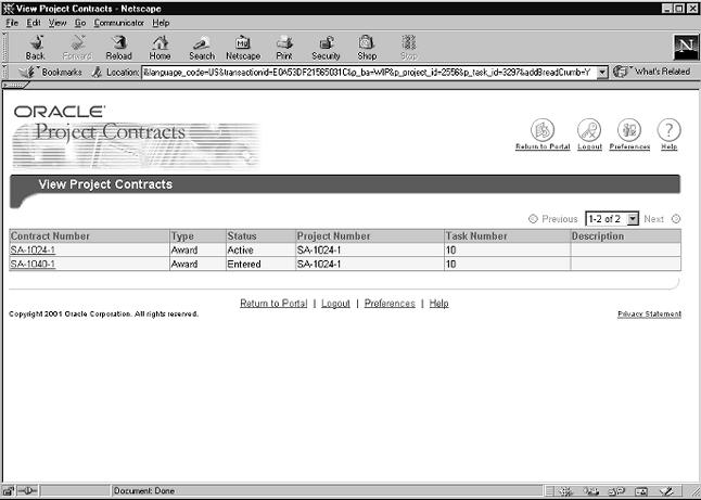

You can view Oracle Project Contracts information for jobs that have an associated contract. The View Contracts tab is enabled only when Oracle Project Contracts is installed; and the discrete job has a project and, if applicable, corresponding task referenced.
When you select a job in the hierarchical tree, and then select View Contracts - the contracts associated with this job display including detail information about contract number, type, status, related project number and task, and description.
You can select the contract number to display the flowdown details which can include system attributes, terms and conditions types, article subjects, and standard note types.

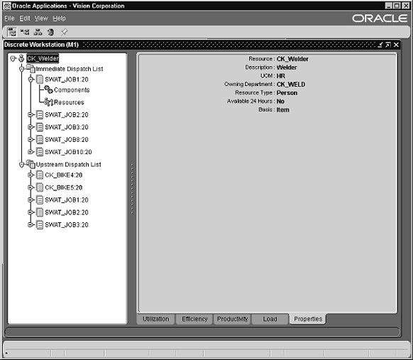

The topmost branch of the tree displays the name of either the department or the resource that you selected when you launched the workstation. Your choice affects which jobs are displayed, as described below:
If you launch the workstation by selecting a department, but do not select a resource, the workstation branches display all of the job operations scheduled to be worked on in that department. You can identify whether you are viewing information for a department or a resource by the graphic preceding the name. Department names are preceded by a graphic of a building.
If you launched the workstation by selecting a department and a resource, the workstation branches display only the job operations scheduled to be worked on at or by that resource. If you selected a person resource when you launched the workstation, the name of the resource on this branch will be preceded by a graphic of a person; machine resources are preceded by a graphic of a conveyor belt.
You can also launch the workstation using a specific instance to display dispatch lists by individual machine or person.
When you select this branch, five tabs of information are displayed in the workstation's right pane. Four of the tabs provide tables and graphs that show you the utilization, efficiency, productivity, and load of the resources within the department or on a specific resource from across all departments that use the resource. The fifth tab displays a list of the department's or resource's properties.

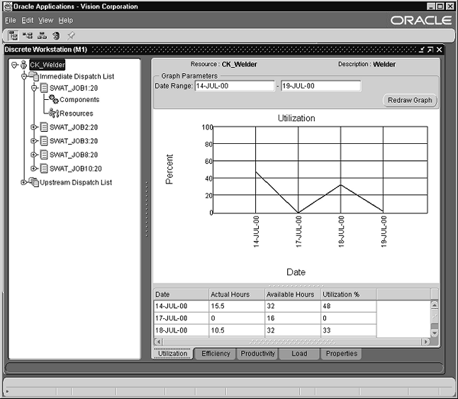

The Utilization tab displays in graph and table format, the department's or resource's daily percent utilization during the past five days (the default date range), or during a date range that you select. The top section of the tab displays the name of the department or resource and its description, and provides you with two Date fields that you can use to change the date range of the graph.
The Utilization graph displays as a percentage the hours the department or resource was actually used compared to the hours it was available to be used. It shows the daily percent utilization of the resources within the selected department, or of a particular resource across all departments, depending on whether you chose to view a department or a department/resource when you launched the workstation.
The utilization formula is: Utilization = Actual Hours / Available Hours.
The default view for the graph displays information for the last five working days, however, you can change the date range (you are restricted to dates in the past). If you change the graph dates, you use the Redraw Graph button to refresh (update) the display.
The following information on the graph is also displayed in a table below the graph:
Date: a day in the selected date range (the default date range is the last five working days)
Actual Hours: the actual hours charged
Available Hours: the hours defined in Bills of Material resource definitions
Utilization Percent (%): Actual Hours / Available Hours

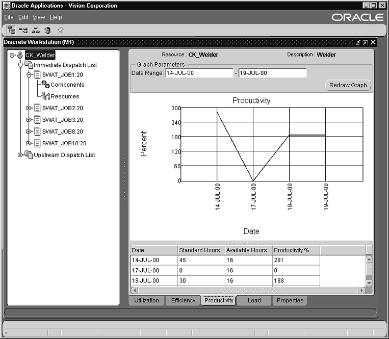

The Efficiency tab displays in graph and table format the efficiency percentage of the department or resource. It shows the daily percent efficiency of the resources within the selected department, or of a particular resource across all departments, depending on whether you chose to view a department or a department/resource when you launched the workstation. The top section of the tab displays the name of the department or resource and its description, and contains two Date fields that you can use to change the date range for the graph.
The Efficiency graph is a line graph that represents the daily percentage of hours the department or resource is actually being used compared to how many hours it was expected to be used. The default date range for the graph is the last five working days, however you can change it (you are restricted to dates in the past). If you change the date range of the graph, you use the Redraw Graph button to refresh (update) the display.
The Efficiency formula is: Efficiency = Actual Hours / Standard Hours
The information from the graph is also displayed in a table below the graph:
Actual Hours: the actual hours charged to the resource
Standard Hours: the number of hours that were expected to have been charged as defined in the routing
Efficiency Percent (%): Actual Hours / Standard Hours
The Productivity tab displays the daily productivity of the department or resource in graph and table format. It shows the percent productivity of the resources within the selected department or of a particular resource across all departments, depending on whether you chose to view a department or a department/resource when you launched the workstation. The top section of the tab displays the name of the department or resource and its description, and provides you with two Date fields that you can use to define the date range for the graph.
The Productivity graph displays the daily percentage of hours the department or resource was expected to be used compared to the number of hours it was available to be used. The default date range for the graph is the last five working days, however you can change it (you are restricted to dates in the past). If you change the graph's dates, you must choose the Redraw Graph button to refresh (update) the display.
The Productivity formula is: Productivity = Standard Hours / Available Hours
Productivity Percent (%): Standard Hours /Available Hours
The Load Tab displays a bar graph that represents the load versus the capacity of the resource. It shows the percent load versus capacity of the resources within the selected department or of a particular resource across all departments, depending on whether you chose to view a department or a department/resource when you launched the workstation. The top section of the tab displays the name of the resource and its description, and provides you with two Date fields that you can use to define the date range for the graph.
On this tab, you can view the load on the department or resource on the two graphs, the Cumulative Load and Daily Load graphs, which you select from the Graph Type field's list of values.
The Cumulative Load graph displays the cumulative available and required hours for the department or resource across the entire date range. The default date range for the graph is the last five working days, however you can change it (you are restricted to dates in the past). If you change the date range of the graph, you use the Redraw Graph button to refresh (update) the display.
The following information from the graph is also displayed in a table below the graph:
Department or Resource: the name of the department or resource that you selected at launch
Available Hours: calculated from Bills of Material resource definitions. It represents the number of hours that can be worked during the given date range.
Required Hours: calculated from the scheduled start/end times and the usage rates. It represents the number of hours required to be worked on any scheduled jobs during the given date range.
The Daily Load graph displays the available and required hours for the resource by day. The default date range for the graph is the last five working days, however you can change it (you are restricted to dates in the past). If you change the date range of the graph, you use the Redraw Graph button to refresh (update) the display.
Required Hours: calculated from the scheduled start/end times and the usage rates. It represents the number of hours that are required for any job operations scheduled during the given date range.
The Properties tab for the department or resource provides you with the resource, description, UOM (Unit of Measure), owning department, resource type, whether or not the resource is available 24 hours, and the basis:
The Immediate Dispatch List is the first of the two main branches on the Discrete Workstation's navigation tree. When you select the Immediate Dispatch List branch itself, the Schedule tab is displayed. This tab lists all of the job operations on the tree in a table, along with their job and operation start and end times.
Listed below the Immediate Dispatch List branch are all of the current job operations that need to be worked on at the department or resource that you selected when you launched the workstation. Selecting an individual job operation branch displays the job operation's Components and Resources branches.
Each of the Immediate Dispatch List branches displays tabs of information about the job operation. Further, the tabs contain buttons that you can use to perform common transactions, and one that enables you to view attachments. All of these branches, tabs, and buttons are described in the sections that follow.
The Schedule tab lists all of the job operations on the Immediate Dispatch List and provides you with the job name, operation code, and operation start and end times. The top of the tab displays the name of the department and resource that you selected when you launched the workstation. There also are two Date fields that you can use to select a different date range for the jobs that appear on the graph (the last five working days are the default dates for the graph). If you change the default dates, you must choose the Show Graph button to refresh (update) the display.
Job operations listed under the Immediate Dispatch List branch have assembly quantities in their Queue intraoperation step, and thus are jobs that you can work on immediately. Any job operation listed on the tree in red text and preceded by an icon of a stoplight, however, has been put on hold.

The top section of the Assembly Moves tab displays the job that you selected, its operation sequence, operation code, assembly, department, resource, and resource sequence:
The Assembly Moves tab displays an interactive graphic that you can use to perform simple Move and Completion transactions. It consists of buckets that represent Work in Process intraoperation steps, and a red ball graphic that represents the assembly quantity for the job. You use the mouse to perform simple move and transactions on the graphic.
The tab also displays three buttons, the Issue Components, Move Assemblies, and Charge Resources buttons, which you can use to open Work in Process transaction windows. You also can download operating instructions by choosing the View Instructions button.
Moving Assemblies: you use the mouse to perform simple move transactions by dragging the red ball graphic from one bucket to another. When you drag the red ball a small window opens so that you can enter the assembly quantity that you want to move. The assembly quantities that you move at each intraoperation step are displayed above the step's bucket.
Completing Assemblies: you can complete assemblies on the Assembly Tab if you are at the last operation on the routing. The completed assembly is then moved into the completion subinventory designated on the routing. You also can complete and over-complete assemblies on the Move transactions window, which you open by choosing the Move Assemblies button.
Completing Operations: at any operation other than the last operation, you can complete the operation, and the assembly is moved into the Queue of the next operation. You complete assemblies and operations when you drag the red ball graphic into the Complete Assembly or Complete Operation bucket on the tab's interactive graphic.
For information on performing these transactions, see Discrete Workstation Transactions
The Components Shortages tab displays in graph and table format a comparison of the components required for a job operation to the quantities of components on-hand. You can choose the Issue Components button on the tab, which opens the WIP Material Transactions window so that you can issue components to the job.
The top section of the Component Shortages tab displays the job that you selected, its operation sequence, operation code, assembly, department, resource, and resource sequence:
The Component Shortages bar graph compares the job operation's required quantity to its on-hand quantity. The graph only displays job operations that have fewer components on-hand than are required for the operation.
The graph provides you with the following information, which is also presented in a table below the graph:
Component: the name of the component
Date: the date where a shortage occurred
Required Quantity: the number of components required for the job operation
On-Hand Quantity: the number of the components required for the job operation that are in inventory
Difference: the Required quantity minus the On-Hand quantity
If an operation has been set up to allow manual resource charging, you can use the features on the Time Charges tab to manually charge both person- or machine-type resources to the operation.
You can charge resources directly from the Time Charges tab or you can charge them on the Resource Transactions window, which you can open by choosing the Charge Resources button. When you charge resources on the Resource Transactions window, the job, assembly, and other information from the workstation are automatically defaulted in the fields. The steps for manually charging resources on the Time Charges tab are listed below. For information and instructions on manually charging resources on the Resource Transactions window, see: Charging Resources Manually.
To manually charge resources on the Time Charges tab
In the Resource field, open the drop-down box and select the resource to which you are charging time.
The first resource on the list is the resource that you selected when you launched the workstation. Select this resource if you are charging time for a person-type resource. All other resources listed are machine-type resources assigned to that operation.
In the Start Date field, enter the start date and time for the period of time that you are charging to the resource. The date must be the current or a future date (if an invalid date is entered the field color changes to red).
In the End Date field, enter the end date and time for the period of time that you are charging to the resource. The date must be either the same as the Start Date or a future date (if an invalid date is entered the field color changes to red).
Note: When you change the start and end dates and times, the system calculates the total hours for that period and displays them directly below the End Date field.
In the Rate block, check the Use Employee Rate check box ONLY if you are charging an employee's time to the operation at the employee's rate. If you do NOT check the check box, the employee's time will be charged at the standard rate (the default).
From the drop-down list for the Employee Name field, select the employee for whom you are charging time. The list only displays the names of employees assigned to the resource whose employee rate has already been set up in the system.
Choose the Save button on the tab to save your entries.
The Properties tab for jobs in the immediate dispatch list provides you with the following information: job, operation sequence, operation code, operation description, scheduled quantity, assembly, assembly description, department, resource, resource sequence, job start time, job end time, operation start time, operation end time, quantity in Queue, quantity in Run, quantity in To Move, quantity in Reject, quantity in Scrap, quantity complete, next operation, previous operation, minimum transfer quantity, project, and task.
The Components branch displays the Component Requirements tab. This tab lists all of the components required for the job operation.
The header of the Component Requirements tab for jobs in the immediate dispatch list displays the job, operation sequence, operation code, assembly, department, resource, and resource sequence.
The tab's table provides the following information about the component:
Component
Description
Basis
Required Quantity
Supply Type
Date
Subinventory
Locator
Quantity Issued
Quantity Per Assembly
Inverse Usage
Yield
Comments

You can perform simple assembly Move transactions directly on the Assembly Move tab. You move assembly quantities by dragging the red ball to the bucket at that step. You have the option to move quantities across more than one operation in a routing.
You can also navigate to the Move Transactions window. You open the window directly from the workstation by choosing the Move Assemblies button on the Assembly Moves tab. All relevant job information is automatically defaulted into the window from the workstation.
To move assemblies on the Discrete Workstation
Navigate to the Discrete Workstation, the Assembly Moves tabbed region.
Select an assembly in the tree hierarchy to display the operation steps in the Assembly Moves region.
With your cursor, select the red ball at the step you want to move, and drag it to your move location.
The Move dialog window displays. The To Operation field defaults to the current operation.
You have the option to move quantities across more than one operation in a routing—for operations eligible to you. Select the list of values tag in the To Operation field to display the Find dialog box.
Select an operation, and Choose Find.
Note: If the Autocharge flag is enabled, each operation must be in the same department to cross over operations. See: Count Point and Autocharge Fields, Oracle Bills of Material User's Guide, and Adding and Updating Operations
Enter a quantity.
The assembly quantity at each intraoperation step is displayed numerically above the step, and changes to reflect the number of assemblies moved in and out of that step.
If quality collection plans exist for this assembly, choose Quality to navigate to the Enter Quality Results window. See: Entering Quality Results Directly, Oracle Quality User's Guide
Choose OK to save your work.
You can capture account information when scrapping assemblies. Enter values in the To Operation and Quantity fields. If the Require Scrap Account parameter is enabled, you must also enter either a value in the Account alias or Scrap Account field.

You can complete assemblies on the Assembly Moves tab if you are at the last operation on the routing. The completed assembly is then moved into the completion subinventory designated.
To complete assemblies on the Discrete Workstation
With your cursor, drag the red ball to the bucket of the last step of the operation—at the Complete Assembly icon.
The Complete dialog window displays.
Enter the number you are completing in the Quantity field.
In the Subinventory field, you have the option to specify the completion subinventory. Select the list of values tag to display the Find dialog box to choose a value
In the Locator field, specify locator information if applicable. Select the list of values tag to display the Find dialog box to choose a value.
If applicable sales orders are attached to this job, you can select values in the Sales Order and Sales Order Line fields.
The window refreshes with the completed quantity displaying next to the Complete Assembly graphic icon.
When a job with outside processing operations is changed to complete, closed, or canceled status - an informational warning message displays if open purchase orders or requisitions exist for any of the operations.
Changing a job status to completed, closed, or canceled is prevented if open reservations exist. If you attempt one of these transactions for a job linked to a sales order, an error message displays. You have two options in order to continue:
Unlink the sales order reserved to this job
Reduce the job quantity of the job to equal the completed quantity

The Discrete Workstation enables backflushing of lot and serial controlled items during move transactions and completion transactions. When you are performing a completion transaction and choose OK, the system automatically explodes the bill of material and accesses the Components dialog window. Components under serial number, or lot and serial number control, require entry of these values. On this window, the Quantity field displays the background in the color red if data entry is required. Backflushing lot and serial controlled items on the Discrete Workstation enables you to:
Access the Lot Entry or Serial Entry windows directly from the workstation
View a visual indication of the required data entry
Over or under issue Pull components requiring lot and serial number entry
See: Lot and Serial Number Backflushing, and Backflush Supply Subinventories and Locators
To enter operation completion transactions for serial, or lot and serial components on the Discrete Workstation
During operation completion transactions, when moving quantity to the last step of the operation, the Move dialog box displays. Enter the number you are completing in the Quantity field.
If quality collection plans exist, choose Quality to navigate to the Enter Quality Results window. Entering Quality Results Directly, Oracle Quality User's Guide
The Components dialog window displays. This window displays fields for the Operation, Component, Unit of Measure, Quantity, Subinventory, Locator, and Revision.
You can change the default information for Unit of Measure and Subinventory.
In the Quantity field, if information is required, it displays with a background color of red. The default is the required quantity. If you have enabled the Allow Quantity Changes During Backflush parameter—you can change the quantity. Otherwise, you must transact the Quantity Required value. See Backflush Transaction Options
Choose Lot/Serial to assign lot and serial numbers.
The Lot Entry window displays to select or assign lot information, if required. Otherwise, if only serial number values are required, the Serial Entry window displays.
Enter lot information, if applicable. See: Assigning Lot Numbers, Oracle Inventory User's Guide
Choose Serial to access the Serial Entry window, see: Assigning Serial Numbers, Oracle Inventory User's Guide
Choose Done to save your work, and return to the workstation canvas.
To enter completion transactions for serial, or lot and serial assemblies on the Discrete Workstation
During assembly completion transactions, when moving quantity to the last operation, the Completion dialog box displays. Enter the completion information for this assembly.
Choose Lot/Serial to assign lot and serial numbers. The Lot Entry window displays to select or assign lot information, if required. Otherwise, if only serial number values are required, the Serial Entry window displays.
Choose Serial to access the Serial Entry window. Enter the serial number information, see: Assigning Serial Numbers, Oracle Inventory User's Guide
The Upstream Dispatch List branch is the second of two main branches on the Discrete Workstation. The tab for the Upstream Dispatch List branch itself is blank. If there are jobs for future dispatch at that department or resource, expanding the tree displays them on a list below this branch. When you select a job operation from the tree, the workstation also displays the operation's Components and Resources branches.
Job operations on the Upstream Dispatch List display two tabs of information, the Component Shortages and Properties tabs. The job operation's Components branch displays the Component Requirements tab, and its Resources branch displays the Resource Requirements tab.
Detailed information on each of these tabs is provided in the sections that follow.
For detailed information on each tab, see the following topics:
Job operations on the Upstream Dispatch List have assembly quantities in the To Move intraoperation step of the previous operation. These job operations are scheduled to be worked on in the near future at the resource you are viewing.
Each branch under the Upstream Dispatch List represents one job operation, and each job operation is supported by two branches of information: its Components branch, which displays the operation's Component Shortages and Properties tabs, and its Resources branch, which displays its Resource Requirements tab.
The Component Shortages tab displays a comparison of the components required for a job operation to the quantities of components on-hand.
The top section of the Component Shortages tab displays the following information about the department and resource: job, operation sequence, operation code, assembly, department, resource, and resource sequence.
The Component Shortages bar graph for jobs in the upstream dispatch list compares the job operation's required quantity to its on-hand quantity. The graph only displays job operations that have fewer components on-hand than are required for the operation.
Date: the date where the shortage occurred
The Properties tab for jobs in the upstream dispatch list displays the following information:
Job
Operation Sequence
Operation Code
Operation Description
Scheduled Quantity
Assembly
Assembly Description
Department
Resource
Resource Sequence
Job Start Time
Job End Time
Operation Start Time
Operation End Time
Quantity in Queue
Quantity in Run
Quantity in To Move
Quantity in Reject
Quantity in Scrap
Quantity in Complete
Next Operation
Previous Operation
Minimum Transfer Quantity
Project
Task

Component
Description
Basis
Required Quantity
Supply Type
Date
Subinventory
Locator
Quantity Issued
Inverse Usage
Yield
Comments
Selecting the Resources branch opens the Resource Requirements tab. This tab lists all of the resources required the job operation.
The top section of the Resource Requirements tab for jobs in the upstream dispatch list provides you with the job, operation sequence, operation code, assembly, department, resource, and resource sequence.
The table provides the following information about the resource (you may have to scroll to see all of the columns of information):
Sequence
Resource
Assigned Units
Type
Description
UOM
Basis
Usage Rate
Start Date
Completion Date

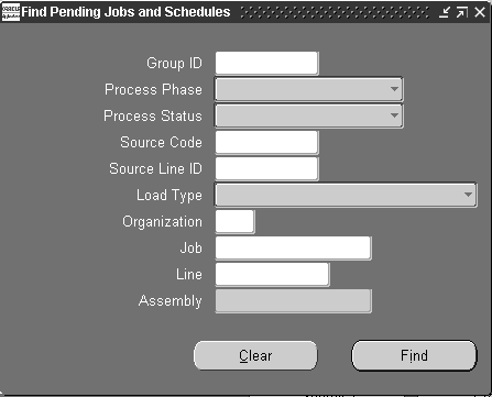

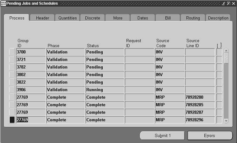

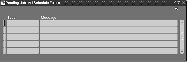

Signals to create discrete jobs and repetitive schedules are processed by the WIP Mass Load program.
When discrete jobs and repetitive schedules are created in response to kanban replenishment signals, they are automatically loaded into the Work Order Interface and automatically processed. If the replenishment signal creates a discrete job, the kanban card is referenced on that job; however, if the replenishment signal creates a repetitive schedule, the kanban card is not referenced. Once the discrete job or repetitive schedule has been successfully loaded, the status of the kanban card is updated to In process.
When kanban replenishment jobs and schedules fail validation and processing, they are automatically deleted from the interface table. The reason for their failure is noted on the Job and Schedule Interface report, which is automatically printed each time the Mass Load program is run. When imported, non-kanban job and schedule information that fails validation or processing is marked. You can use the Pending Jobs and Schedules window to view, update, and resubmit this information.

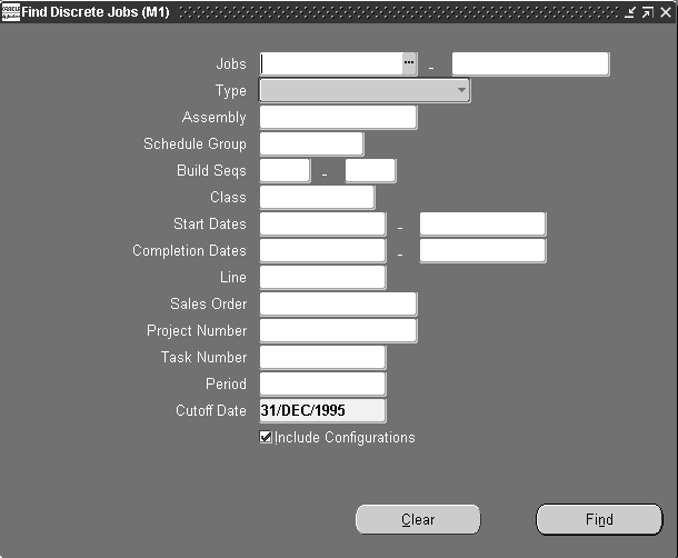

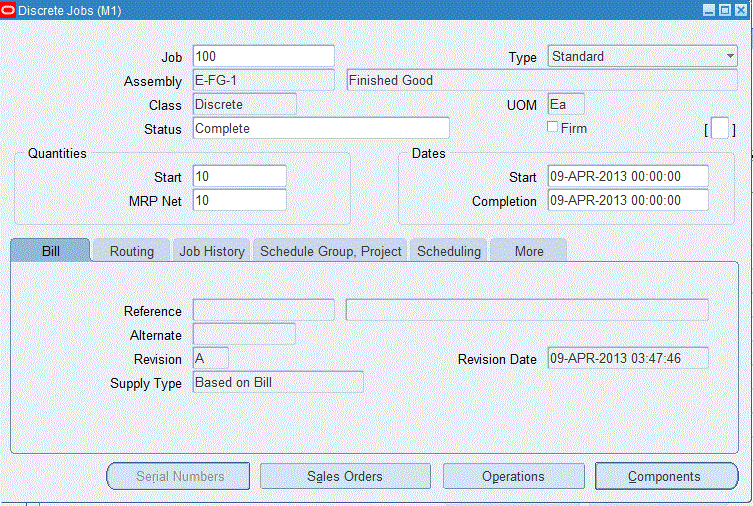

To define a discrete job
From the Discrete navigation menu selections, click Discrete Jobs and then select an organization. The Find Discrete Jobs window appears.
Find Discrete Jobs Window
Click New to open the Discrete Jobs window.
You can define discrete jobs one-at-a-time in the Discrete Jobs window. This method is described below. You can, however, also define several jobs simultaneously using the Discrete Jobs Summary folder window.
Note: The following nine fields cannot be accessed in the Discrete Jobs Summary folder window even if included in your user folder: bill and routing Alternates, bill and routing Revisions and Revision Dates; Completion Subinventory and Locator; and Supply Type. If you need to change the values that are defaulted into these fields, navigate to the Discrete Jobs detail window.
Enter or generate the Job name.
You can generate a default Job name by choosing Apply Default Job Name from the Tools menu or by simply pressing the tab key. If you do enter the job name, it must be unique and alphanumeric.
Note: Default job names can only be automatically generated by the automatic sequence generator if a prefix has been specified for the WIP:Discrete Job Prefix profile option.
Select the job Type, either Standard or Non-Standard. See: Standard Versus Non-Standard Discrete Jobs.
If defining a standard discrete job, select the job Assembly.
The assembly is the item you are building. If a primary bill of material, primary routing, or both exist for this assembly, they are defaulted.
You cannot select an assembly that has a primary routing that is Flow related. If you do, a warning is displayed and you are prompted to enter another routing designator.
See: Creating a Flow Routing, Oracle Flow Manufacturing User's Guide.
Assemblies are optional for non-standard discrete jobs, however, you must enter them for non-standard discrete jobs with routings if you want to track shop floor move and resource transactions.
If you set the WIP:See Engineering Items profile option to Yes, you can define jobs for engineering items.
Note: If you are defining a job for an ATO sales order, you must enter an ATO item.
Note: You can define discrete jobs for assemblies that do not have components and for assemblies that have components with disable dates less than or equal to the current date.
See: WIP Accounting Class Defaults, Discrete Accounting Classes, and Accounting Class Defaults on the Discrete Jobs Window
When you define a job, its status defaults to Unreleased but can be changed to Released or On Hold. See: Discrete Job Statuses.
Check the Firm check box to firm your job. You cannot firm a non-standard discrete job.
Firming a discrete job prevents MRP from suggesting rescheduling and replanning recommendations when changes to supply or demand occur. If replanning is required, the MRP planning process creates new jobs to cover the new demand. See: Firm Order Planning, Oracle MRP User's Guide.

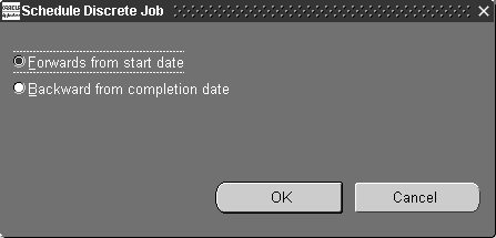

To schedule a discrete job with a routing
Enter or select either the Start or Completion date and time.
If you enter a start date and time the completion date and time are automatically forward scheduled based on the assembly's routing. Similarly, if you enter a completion date, the start date and time are automatically backward scheduled based on the assembly's routing. You can enter a past due start date to forward schedule a job that should have started before the current date. You cannot enter a start date and time greater than the completion date and time.
You can use the start date of the job to default bill and routing revisions and revision dates. If a start date is not entered, bill and routing revisions and revision dates default based on fixed and variable lead times of the assembly.
To initiate material reservations for a job
In the Discrete Jobs window, select the Tools menu.
Create reservations by selecting one the following choices from the Tools menu:
Reserve Job: Creates a high-level reservation of all components in a discrete job, depending on how the component supply type is set up in the Material Reservations section of the WIP Material parameter. Your choices are pull, push, or both supply types. See: Material Reservations
Maintain Component Reservations: Navigate to the Inventory Item Reservation window to create a detailed reservation using subinventory, locator, lot, and serial number. The Item Reservations window does not validate supply type or time fence values. See: Item Reservations, Oracle Inventory User's Guide
Note: On the Discrete Jobs window, you can also click Components to open the Material Requirements window for the selected job, and then from the Tools menu, select Reserve Line to reserve a component line. See: Viewing Component Requirements
To create, update, and delete high-level component reservations for multiple discrete jobs, you can run the Manage Component Reservations for Discrete Jobs concurrent program. See: Managing Component Reservations
To initiate material reservations for a job supply to another job as demand:
You can manually reserve a discrete job supply for another discrete job as demand in both Inventory and WMS organizations. A discrete job as a supply can be reserved to a sales order demand or to a job operation component as demand. The application validates that the sum of reservation quantity from both sales order and discrete job demand does not exceed the supply discrete job quantity.
Select a job in the Discrete Jobs window and then select the Tools menu.
From the Tools menu, select Maintain Job Reservations.
The Item Reservations window opens.
On the Item Reservation window to reserve a discrete job supply for another discrete job as demand, enter values for the following in the Demand tab:
Item - Select the subassembly item as the component for the assembly job.
Demand Type - Select a discrete job as the demand type.
Demand Header Number - Select from the list of valid discrete jobs that have the subassembly item as the component for the assembly job.
Line - Select the line number.
In the Supply tab, enter values for the following:
Supply Source Type - Select a discrete job as the supply source type.
Supply Header Number - Select from the list of valid discrete jobs that have the subassembly item as the component.
Enter values for the Need By Date, UOM, and the Quantity fields.
Click Save.
Note: You cannot decrease the job quantity to be less than the quantity that you have reserved.
Also note that discrete jobs with reservations cannot be cancelled, closed, or changed to the Complete-No Charges due to unfulfilled sales orders or work orders linked to the discrete job. You can change the status to Cancelled, Closed, or Complete-No Charges only after you delete the reservations.

To define schedule group and project information
On the Schedule Group, Project tab, select the Schedule Group.
You have the option to assign discrete jobs to any active schedule group. See: Defining Schedule Groups
Enter a Build Sequence identifier. See: Build Sequencing.
You can select any active production line. Production lines are optional for discrete jobs. They are not used for scheduling or transactional purposes. However, if you do select a production line, the combination of schedule group, build sequence, and production line must be unique.
Select a Project and, if required, a task.
You can only select a project if the current organization's Project References Enabled parameter is set in Oracle Inventory. You must select a task if the Project Control Level parameter is set to Task and you have entered a project. See: Organization Parameters Window, Oracle Inventory User's Guide and Creating Projects, Oracle Projects User's Guide.
Enter the Unit Number. This enables you to associate an end item model/unit effectivity number with the item.
You must have Oracle Project Manufacturing installed, the item must be under model/unit effectivity control, and you must have a model/unit number associated with it to enable this functionality. If the item is not under model/unit number control, this field is disabled. See: Model/Unit Effectivity, Oracle Project Manufacturing Implementation Manual.
Note: You can update unit effectivity through Mass Load for discrete jobs that are unreleased and project related.
Save your work.
If you are defining a discrete job, you must save the job before viewing component requirements and operations for that job.
To change a saved job

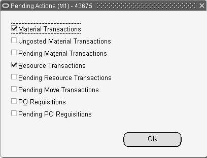

To view pending job information
You can determine if there are any pending transactions or documents for a job using the Pending Actions window. See: Viewing Pending Job Transactions.
To view operations:
Choose Operations The Operation window appears and the job's operations are displayed. You can optionally view the components required at a selected operation by choosing Components. See: Viewing Job and Schedule Operations.
To view component requirements
Choose the Components button. The Material Requirements window appears and the job's components are displayed. See: Viewing Component Requirements and Viewing Component ATP Information.
Note: When no routing exists, all components default to operation sequence of 1.
To view outside processing workflows
To link an ATO sales order to a standard discrete job
See: Linking ATO Sales Orders and Discrete Jobs.
Note: The Sales Order button is disabled if you are changing a production kanban job.

The Sales Order window shows the reserved quantities linked to this job. However, you can select View Sales Orders from the Tools menu to navigate to the Job Details page in the Manufacturing Execution for Discrete Manufacturing product to view both reserved and fulfilled quantities of sales orders.

Choose the Sales Orders button. The Sales Order window appears.
Select one or more sales orders.
You can select multiple sales orders as long as the total quantity allocated does not exceed the job quantity. You cannot select a sales order that has order lines that are currently being satisfied by a Flow schedule.
Note: You can attach a sales order to a job before entering an assembly, start quantity, or demand class for a job. Work in Process defaults the assembly, start quantity, or demand class based upon the sales order you specify.
If you enter a line that also specifies a shipment number, the sales order shipment number is entered in the Ship Number field. You can specify a sales order line that does not include a sales order shipment number.
Enter the Quantity Allocated.
This is the quantity of the sales order, line number, and shipment number combination that the discrete job fulfills.
Save your work.

To view an ATO sales order linked with a discrete job
Choose Find from the Query Menu. See: Finding Discrete Jobs.

To navigate to the Item Reservation from Work in Process to create serial reservations
Navigate to the Discrete Jobs window and select a specific record.
Select Maintain Component Reservations from the Tools menu to access the Item Reservation window.
You have the ability to create detailed reservations for items by subinventory, locator, lot, and serial number from the Item Reservation window after the job is created or released.

You can perform serialized move transactions through Oracle Mobile Supply Chain Applications using a mobile device. The location of the assembly on the routing determines the window used for the transactions. For example, jobs not serialized do not require serial entry - and serialized jobs require serial number entry before you can proceed. This functionality uses the following rules:
Before reaching the serialization start operation, move transactions are performed using the window where serial number entry is not available.
Once a serialized assembly moves to the Queue of the serialization start operation, move transactions are performed using a window requiring serial number entry.
The current location of the assembly (the From Operation and Step), and the setting of the Default Intraoperation Step for Assembly Moves parameter - is used as the default destination for the To Operation and Step.
The default destination is the next occurrence of the step that you selected for the parameter setting. The next occurrence is in either the current operation, or the next countpoint operation - depending on the From Step. Default information can be changed. For example:
If the From Operation and Step is 20 Queue, and the parameter is set to Run, 20 Run is the default value for the To Operation.
If the From Operation and Step is 20 Queue, and the parameter is set to Queue, 30 Queue is the default if 30 is a countpoint operation.
Before the serialization start operation, where serial number entry is not available, you can move both backward and forward. However, when moving forward, an assembly must be moved to Queue of the serialization start operation before it can move forward. Starting from that point, the serial number represents a specific assembly and serial number entry is required.

Only one assembly can be moved or completed per transaction.

Moving assemblies between routing operations and intraoperation step. See: Performing Move Transactions.

You can find then view, release, change, reschedule, or close discrete jobs. You can also query to find jobs to purge.
To find one or several discrete jobs to view, release, change, reschedule, or close
When the Find Discrete Jobs window appears, enter your search criteria.
You can query by Job name, job Type (standard or non-standard), Assembly, Schedule Group, a range of Build Sequences, accounting Class, a range of Start Dates, a range of Completion Dates, Sales Order, Project Number, Task Number, or job Status. You can combine or omit criteria as required.
Note: Querying to find jobs does not validate the records returned. For example, querying to find a range of jobs to close does not return only those jobs in that range that can be closed.
Choose the Find button.

To view component requirements:
From either the View Discrete Jobs or View Discrete Jobs Summary windows, choose the Components button. The Material Requirements window appears and the job's components are displayed. See: Viewing Component Requirements and Viewing Component ATP Information.
To view sales orders that are linked to a standard discrete job:
From either the View Discrete Jobs window, choose the Sales Order button. See: Linking ATO Sales Orders and Discrete Jobs.

You can use the Transaction Summary window to determine if there are pending transactions or unprocessed documents associated with a job. You cannot purge or close jobs if pending transactions or unprocessed documents exist. In some instances, you also cannot change a job from one status to another. For example, you cannot change jobs from a Released to an Unreleased status if pending information exists.
To view pending transactions and conditions for a job
Select a queried job in the Discrete Jobs, View Discrete Jobs, Close Discrete, or Purge Discrete Jobs window. See: Finding Discrete Jobs.
Choose Pending Actionsfrom the Tools menu to invoke the Pending Actions window.
If a restriction exists, the check boxes indicating the type of restrictions is marked. An explanation of each restrictive condition follows:
Material Transactions: Components have been issued to the job and there are records in the WIP_REQUIREMENTS_OPERATIONS table. You can view information about issues material in the Material Requirements. See: Viewing Material Requirements and Viewing Component Requirements.
Uncosted Material Transactions: There are uncosted transaction records in the MTL_MATERIAL_TRANSACTIONS table. You can check to see if transactions are uncosted, the costed indicator is off, using the Material Transactions window. See: Viewing Material Transactions, Oracle Inventory User's Guide and Oracle Inventory Electronic Technical Reference Manual (eTRM) .
Pending Material Transactions: There are unprocessed material transaction records in the MTL_MATERIAL_TRANSACTIONS_TEMP table. You can view, update, and resubmit these records in the Pending Transactions window in Oracle Inventory. See: Viewing Pending Transactions, Oracle Inventory User's Guide.
Resource Transactions: Resources have been charged and there are records in the WIP_OPERATIONS_RESOURCES table.
Pending Resource Transactions: There are pending resource and overhead transaction records in the WIP_COST_TXN_INTERFACE table. You can view and resubmit these records using the Pending Resource Transactions window. See: Processing Pending Resource Transactions .
Pending Move Transactions: There are pending move transaction records in the WIP_MOVE_TXN_INTERFACE table. You can view and resubmit these records using the Pending Move Transactions window. See: Processing Pending Move Transactions a.
PO Requisitions: There are purchase requisitions in the PO_REQUISITION_LINES table. See: Reviewing Requisitions, Oracle Purchasing User's Guide and Oracle Purchasing Electronic Technical Reference Manual (eTRM) .
Pending PO Requisitions: There are unprocessed records in the PO_REQUISITION_ INTERFACE table. See: Requisition Import Process, Oracle Purchasing User's Guide .

You can change discrete jobs using the Discrete Jobs and Discrete Jobs Summary windows. The status of the job determines if and what information can be changed. See: Discrete Job Status Control.
You can increase or decrease the job quantity with no restrictions if the job is unreleased. If the job is released and work has begun on the assembly, you cannot decrease the job quantity lower than the number of assemblies that have already passed the Queue intraoperation step of the first operation. If a sales order is linked to the job, you cannot decrease the job quantity lower than the order quantity. The material requirements and job dates are automatically adjusted based upon the quantity change. If the job's assembly is an MPS-planned item, the update process automatically adjusts the MPS relief quantity.
You can reschedule standard and non-standard jobs to respond to changes in plans or unexpected downtime by changing their start and/or completion dates and times. Jobs might require rescheduling when capacity or material schedules change, or when standards change. See: Rescheduling Discrete Jobs.
You can change the status of a discrete job although some changes from one status to another are disallowed and others are conditional. See: Job and Repetitive Schedule Status Changes.
Prerequisites
To change discrete jobs
Change jobs in either the Discrete Jobs or Discrete Jobs Summary folder window. From the Discrete Jobs Summary window, you can choose the Open button to navigate to the Discrete Jobs window.

To reschedule a discrete job with a routing after changing a start quantity
After changing your start quantity and saving your work, the Schedule Discrete Job window appears.
Select a scheduling method:
Forwards from start date: The completion date is cleared and the job is forward scheduled using the start date and time.
Backwards from completion date: The start date is cleared and the job is backward scheduled using the completion date and time.
Manual: For jobs without routings and operations, you have the option to reschedule by accepting the current job start and completion dates.

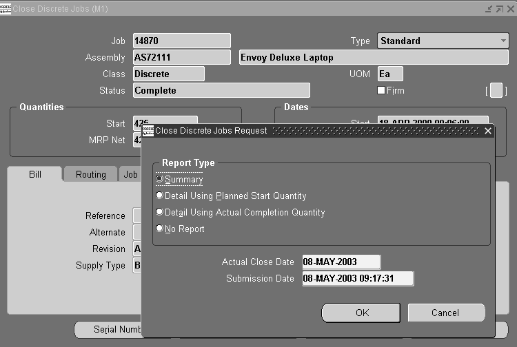

You can change the status of a group of discrete jobs using the Change Status option from the Tools menu. This mass change capability can be used for a variety of purposes such as releasing jobs to production and putting jobs on hold.
To change the status of several Discrete jobs
Choose Find from the Query menu. See: Finding Discrete Jobs.
The Discrete Jobs Summary window appears with the results of the query.
In the Discrete Jobs Summary window, select and deselect jobs as required. .
Choose Change Status from the Tools menu. .
The Change Status window appears.
Choose a status. See: Discrete Jobs Statuses and Job and Repetitive Schedule Status Changes.
Choose OK.
Save your work.

You can use the Pending Actions window to determine if pending transactions or conditions exist for a job. Some status changes are disallowed when pending information exists. See: Viewing Pending Job Transactions.
Related Topics

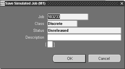

To save a simulated job
Choose Save Simulated Job from the Tools menu. The Save Simulated Jobs window appears.
Enter the Job Name.
If a prefix has been entered for the WIP:Discrete Job Prefix profile option, the automatic sequence generator generates a default job name. This name can be overwritten. See: Profile Option Descriptions.
The following fields are defaulted as follows:
Class: If a default accounting class can be found, it is used. If one cannot be found, you must assign an accounting class to the job in the Discrete Jobs window. See: WIP Accounting Class Defaults and Discrete Accounting Classes.
Status: The status defaults to Unreleased. See: Discrete Job Statuses.
Note: The above defaults can be changed using the Discrete Jobs window. See: Defining Discrete Jobs Manually
Descriptions can be used to identify jobs on standard reports. They can be up to 240 characters of alpha numeric text. They are optional.
Optionally, enter the a descriptive flex value for the job. See: Setting Up Descriptive Flexfields.
Save your work.
Note: Values for the following fields are derived or defaulted but can be changed using the Discrete Jobs window. See: Defining Discrete Jobs Manually
MRP Net Quantity: Derived from the job start quantity.
Supply Type: Defaults to Based on Bill. See: Supply Types.
Firm Planned option: Defaults to off (not automatically firmed).
Completion Subinventory and Locator: For jobs with routings, defaults from the routing.
Lot Number: For lot controlled job assemblies, defaults based on how the WIP Default Lot Number Type parameter is set. See: Material Parameters.
You can also use the Discrete Jobs window to enter values for optional fields: Demand Class, Project, Task, Schedule Group, Build Sequence, and Production Line.

Simulated Component Reservations
When simulating a job, you can view the simulated exploded bill of material and routing of the assembly for the given job when the Material Reservation parameters are configured.
When the WIP parameter Automatic Reservations is set to at Job Creation, when you select Components in the Simulated Job window - the Reserved Quantity column is populated with the reservation quantity if on hand quantities are available.
Inventory reservations are not created, and there is no reduction in on hand quantity until the simulation is saved as an actual job.
When the WIP parameter Automatic Reservations is set to at Job Release or None, the Reserved Quantity column is not populated.
You complete job assemblies into inventory using the Completion Transactions and Move Transactions windows. You also use these windows to return completed assemblies back to jobs. When you complete or return assemblies, any remaining quantities are automatically updated.
Note: You can also complete Work in Process assemblies using the Inventory Transaction Interface and the Open Move Transaction Interface.
Note: The ability to stop completion transactions if all the push type components have not been issued to the job can be set in a profile option, see: WIP:Validate Push Components at WIP Completion
Over-completing and over-moving assembly quantities
You can complete an assembly quantity into inventory that is greater than the job start quantity, or move an assembly quantity that is greater than the quantity at an intraoperation step, whether or not the assemblies have a routing. This is referred to as an over-completion, and it is useful when your production process yields more assemblies than planned.
Note: You also can over-complete assemblies using the Inventory Transaction Interface and the Open Move Transaction Interface, but you must explicitly specify the over-completion transaction quantity, as it will not be derived by Work in Process.
To be able to over-complete assemblies on jobs, you must:
Set up a tolerance level to restrict the number of assemblies that can be over-completed
Enable the over-completion feature by checking the Over-completion check box on the Completion Transaction or Move Transaction windows when completing assemblies
When you over-complete assemblies to Discrete jobs, all resources are charged and any backflush components are backflushed.
Over-completion Tolerance
You must set up a tolerance level for the quantity of assemblies that can be over-completed. The tolerance level is used to validate the over-completion quantity. If a completed quantity is greater than the tolerance allows, the transaction will fail.
You can set up tolerances at three levels: at the organization level by setting the Default Over-completion Tolerance Percent parameter, at the item level by setting Oracle Inventory item attributes, or at the job or schedule levels when defining jobs and schedules. If you do not set up a tolerance at either the item or job or schedule level, the default over-completion tolerance percent parameter is used to validate over-completion assembly quantities. If you do not enter a value for this parameter, it defaults to zero, and you will be unable to over-complete assemblies. Instead, you will receive a message telling you that you cannot over-complete because there is no tolerance. For more information on over-completion tolerance levels, see: Assembly Over-completions
Over-Completions from the Completion Transaction and Move Transaction windows
Once you set up tolerance levels, you enable over-completion on the Completion Transaction and Move Transaction windows by selecting the Over-Completion check box before performing the transaction. For instructions, see: Completing and Returning Assemblies and Performing Move Completion/Return Transactions.
You can specify any completion subinventory and, if required, locator when you complete or return assemblies with a completion transaction. If you complete or return assemblies using move transactions, the subinventory and locator that you assigned (if any) to the job is used. You can complete or return partial job or schedule quantities to different subinventories and locators. The status of a discrete job is automatically updated to complete when your cumulative quantity completed equals the job quantity.
Quantities Reserved to Sales Orders
You can reserve over-completion quantities from jobs linked to sales orders when using the Completion Transactions and Move Transactions windows. The sales order number for each completion line must be entered. This reserves the surplus amount, otherwise the over-completion is unreserved excess inventory. See: Linking Sales Orders and Discrete Jobs.
When you complete assemblies, all components with the supply type of Assembly pull are automatically backflushed. When components for assemblies under lot control, serial number control, or lot and serial control are backflushed upon assembly completion, you must assign lot and/or serial numbers to the components.
Note: The Work in Process parameter, Allow Quantity Changes During Backflush, provides the ability to over or under issue pull components requiring lot and serial number entry for assembly moves and completions; see: Backflush Supply Subinventories and Locators
You cannot complete assemblies from a job if a shop floor status that prevents shop floor moves has been assigned the To move intraoperation step of the last operation. In this case, you must assign a status that allows shop floor moves in order to complete the assemblies.
When a job or schedule with outside processing operations is changed to complete status - an informational warning message displays if open purchase orders or requisitions exist for any of the operations.
Changing a job status to completed is prevented if open reservations exist. If you attempt one of these transactions for a job linked to a sales order, an error message displays. You must reduce the job quantity, or unlink the sales order to continue the transactions. See: Linking ATO Sales Orders and Discrete Jobs
You must have an assembly and job quantity to complete a non-standard discrete job. You can complete an assembly quantity greater than the job start quantity, with or without a routing, as long as the quantity is within the tolerance set. For some non-standard jobs, such as those used for disassembly or equipment maintenance, there is no need to complete assemblies.
When you complete assemblies from final assembly orders using a completion transaction, reservations are automatically transferred from the job to the subinventory and locator based on sales order line delivery due dates. You may override the automatic transfer. When returning completed assemblies back to a final assembly order, you must enter the sales order line and delivery information so that the system knows which reservations to transfer from inventory to WIP.
Under standard costing, assemblies are received into inventory at standard cost and the job is relieved of costs at standard. Under average costing, assemblies are received and the job relieved of costs at average.
For a serialized item returned to stock, validations occur to prevent re-issuing to a different job. At the time of completion, serialized assemblies and components are available from stock if they have specific values set for discrete assemblies and components in the Serial Numbers window in Oracle Inventory:
See: Serial Number Validations for Component Returns and Assembly Completions

The form function parameter, WIP_WIPDJMDF_CLOSE. enables the Unclose option in the Tools menu. If you do not want Unclose to display in the menu, set the parameter to No. See: Security Functions.
To find one or more jobs to view, close, or reopen
Navigate to the Close Discrete Jobs window. The Find Discrete Jobs window appears.
Query to find one or more jobs. See: Finding Discrete Jobs.
The Close Discrete Jobs Summary window appears with the results of your query. Option: to navigate to the Close Discrete Jobs window, choose the Open button.
You can view information about the jobs you intend to close from either the Close Discrete Jobs or the Close Discrete Jobs Summary window. You can view job operation information by choosing the Operations button and component requirement information by choosing the Components button, see: Viewing Job and Schedule Operations, Viewing Component Requirements, and Viewing Component ATP Information. You can also view sales orders that are linked to standard discrete jobs by choosing the Sales Orders button, see: Linking ATO Sales Orders and Discrete Jobs.
To close discrete jobs
Navigate to the Discrete Jobs Summary window. If more than one job is displayed in the Discrete Jobs Summary window, select the jobs to close. .
You can only close jobs with statuses of Cancelled, Complete, Complete - No Charges, Failed Bill Load, Failed Close, Failed Routing Load, On Hold, Released, and Unreleased.
Choose Close from the Tools menu. The Close Discrete Jobs Request window appears.
Select a Report Type.
Reports are printed per the Report Type specified, after the close process computes job close variances. If your organization uses standard costing, the Discrete Job Value Report - Standard Costing is printed when standard discrete jobs and non-standard asset jobs are closed. If your organization uses average costing, the Discrete Job Value Report - Average Costing is printed. The Expense Job Value Report is printed when expense non-standard jobs are closed regardless of your costing method. It is always printed in detail format regardless of the Report Type option specified. For more information about these reports see: Discrete Job Value Report and Expense Job Value Report.
Report Type options and formats are as follows:
Summary: Lists each job and includes job header, period-to-date summary, and cumulative-to-date summary information. The system also lists summary elemental account values for each job.
Detail Using Planned Start Quantity: Lists each job using the planned start quantity of the job to calculate the material usage variance. A detail report includes the following: job header, material, resource, resource-based and move-based overhead costs, completion, scrap, and job close variance transactions. It also includes period-to-date and cumulative-to-date summary information.
Detail Using Actual Completion Quantity: Lists each job using the actual completion quantity of the job to calculate the material usage variance. A detail report includes the following: job header, material, resource, resource-based and move-based overhead costs, completion, scrap, and job close variance transactions. It also includes period-to-date and cumulative-to-date summary information.
No Report: Does not print a report.
Select an Actual Close Date. The system date is the default.
The actual close date must be later than the most recently dated material, resource, or move transactions associated with the selected job or jobs. It must also be in an open accounting period. If it is not, the last date of the most recent open accounting period is defaulted.
Select a Submission Date and time. The system date and time is the default.
Choose OK to submit the request.
You can use the Pending Actions window to determine if there are pending or uncosted transactions associated with a job. You cannot close jobs if pending or uncosted transactions exist. See: Viewing Pending Job Transactions.
From Close Discrete Jobs Summary window choose the Sales Order button. See: Linking ATO Sales Orders and Discrete Jobs.

To print reports for a selected job
You can use the Pending Actions window to determine if there are pending transactions or conditions associated with a job. You cannot purge jobs if pending transactions or unprocessed documents exist. See: Viewing Pending Job Transactions.
From the Purge Discrete Jobs Summary window choose the Sales Order button. See: Linking ATO Sales Orders and Discrete Jobs.
To select which discrete jobs to purge and/or report:
From the jobs displayed, select which to include in the purge. You can select and deselect jobs as required. .
Choose Purge from the Tools menu.
The Purge Options window appears. See: Specifying Purge Options.
Related Topics
After selecting which jobs/schedules to purge in the Purge Jobs or Purge Repetitive Schedules window, you can choose from the following action type options:
| Variable | Description |
| Purge and Report | Purges the selected jobs/schedules and prints a report. |
| Report Only | Prints a report listing the selected jobs/schedules but does not purge them. |
| Purge Only | Purges the selected jobs/schedules but does not print a report. |
If you choose to the print a report, you can choose whether the report is printed in Full, Summary, or Exception format.
Note: Printing a report before submitting a purge request allows you to view the records you have selected, but does not give you any indication of whether the selected jobs/schedules meet the purge conditions.
Prerequisites
To purge information for the selected jobs or schedules and print a report
From the Purge Options window, choose the Purge and Report action. This is the default option.
Choose the level of detail to include in the report. The options are as follows:
Full: The report lists all job and/or schedule records selected for the purge, the table and number of rows affected as well as those records that cannot be purged because of purge rule violations. Full is the default option.
Summary: The report lists all job and/or schedule records selected for the purge but in a tabular form. The table and row detail is omitted although exception information is included.
Exception: The report lists only those job and/or schedule records that cannot be purged because of purge violation rules. Exception information is included.
Choose OK to submit the purge and print the report.
You can determine if there are any pending transactions or conditions for a job using the Pending Actions window. See: Viewing Pending Job Transactions.

To find job and schedule interface records:
Navigate to the Pending Jobs and Schedules window. The Find Pending Jobs and Schedules window appears.
Enter your selection criteria.
You can find all records with a specific Group ID. You can also find all records that have a specific Process Phase (Validation, Explosion, Creation, or Complete), Process Status (Pending, Running, Error, or Complete), Source Code, Source Line ID, Load Type (Create Standard job, Create Repetitive Schedule, Update Discrete Job, or Create Non-standard Job), or are for a specific Organization. You can also search for a specific Job, Assembly, or Line and Assembly.
Choose the Find button. The Pending Jobs and Schedules window appears with the results of your query.
To view job and schedule interface records:
For each record, you can view the following information using the Pending Jobs and Schedules window's tabbed regions:
Process: Group ID, Phase, Status, Request ID, Source Code, and Source Line:
Header: Load Type, Organization, Job, Line, Assembly
Quantities: Discrete Start and Net Quantities, Repetitive Daily Quantity and processing Days, and Total Quantity (both discrete and repetitive)
Discrete: Class, Lot Number, Schedule Group, Build Seq, Project Number and Task
More: Status, Firm planned option, Demand Class, Scheduling Method, Unit Number
Dates: First Unit Start Date, First Unit Completion Date, Last Unit Start Date, and Last Unit Completion Date
Bill: Reference, Alternate, Revision, Revision Date, Supply Type
Routing: Reference, Alternate, Revision, Revision Date, and Completion Subinventory, and Completion Locator
Description: Description and Created By
To view error details for failed job and schedule records:
In the Pending Jobs and Schedules window, select the failed (Status=Error) record.
Choose the Errors button. The Pending Job and Schedule Errors window appears.
All errors for the selected record are displayed. The Type indicates whether the failed record produced an Error or a Warning. The Message explains why the transaction failed. Using these messages you can determine what fields need to be updated.

To select and resubmit pending job and schedule records
From the queried records displayed, select which to resubmit. .
You can only resubmit records with a processing status of Error. If you do not mark a row for re-submission, you can still update it but the WIP Mass Load Program does not process it again when polling the Open Job and Schedule Interface table.
Note: Although Assemble to Order (ATO) jobs with errors are listed in the Pending Jobs and Schedules window, ATO jobs cannot be resubmitted in this window. Correct the errors for failed records, and resubmit them using the all flash array program.
Choose the Submit from the Tools menu.
Resubmitting records resets their process status flags to 1 (Pending), and nulls their Group ID. The next time the WIP Mass Load Program polls the Open Job and Schedule Interface table, these records are reevaluated.
