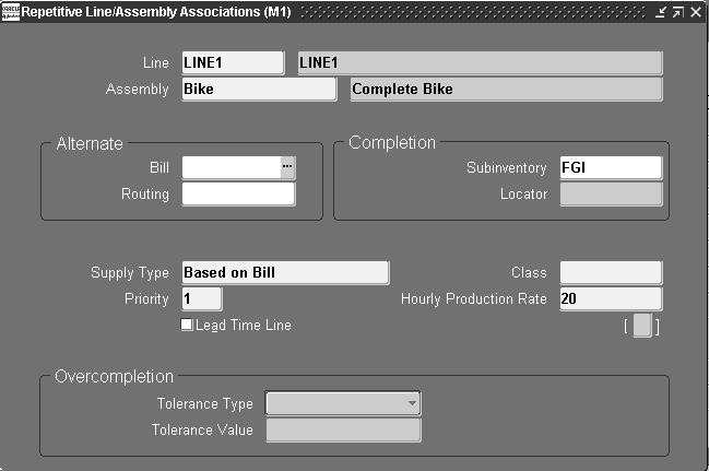

Line/assembly associations establish a link between an assembly and the production line on which it is manufactured. You can define any number of line/assembly associations. You can also update and delete line/assembly associations.
Your repetitive assembly/line associations guide your repetitive production process. You can build the same assembly on different production lines. You can also build different assemblies on the same production line. Building different assemblies on the same production line makes it possible to aggregate, by production line, material requirements for a number of assemblies.
For each assembly on a line, you can enter a primary or alternate bill and a primary or alternate routing. If you change routings for an assembly on a line and there are open repetitive schedules, the new routing must have the same operations as the prior routing.
If you plan to over-complete assemblies, you can set a tolerance level, which restricts the number of assemblies that can be over-completed on the schedule.
Prerequisites
To add a line/assembly associations
Navigate to the Repetitive Line/Assembly Associations window. The Repetitive Line/Assembly Associations summary window appears.
Note: You can associate several lines and assemblies simultaneously using the Repetitive Line/Assembly Associations Summary window. You can, however, also associate lines and assemblies one-at-a-time in the Repetitive Line/Assembly Associations window.
Choose the New button to open the Repetitive Line/Assembly Associations window.
Select the production Line where you build the repetitive assembly, then the assembly or select the Assembly then the production line.
You cannot update the name of a production line after you have assigned it to a repetitive assembly nor can you delete a production line that supports repetitive schedules.
To assign an alternate bill or alternate routing to the line/assembly association
Select the alternate Bill of material. See: Primary and Alternate Bills of Material, Oracle Bills of Material User's Guide
You can select an alternate bill if alternates have been defined for the assembly. If the WIP:See Engineering Items profile option is set to Yes, you can select engineering items as alternates. .
Select the alternate Routing. See Primary and Alternate Bills of Material, Oracle Bills of Material User's Guide.
You can select an alternate routing if alternates have been defined. If the WIP:See Engineering Items profile option is set to Yes, you can select engineering routings as alternates.
To enter a completion subinventory and locator
Select the completion Subinventory and, if required by the subinventory, the Locator.
Assemblies are completed or returned into or from this subinventory and locator. If the assembly has a routing, the completion subinventory and locator are defaulted from the routing but can be overwritten.
Note: You can override the completion subinventory and locator you specify here when you complete or return assemblies using the Completion Transactions window.
Note: You must specify a completion subinventory and locator if you plan to complete or return assemblies using the Move Transactions window since the subinventory and locator specified here are automatically used for those transactions.
To enter a supply type, accounting class, line priority, and hourly production rate
Select the Supply Type. See: Supply Types.
The supply type defaults to Based on Bill. This supply type indicates that component requirements are supplied based upon their individual supply types. You can override this default by choosing one of the following supply types: Push, Assembly Pull, Operation Pull, Bulk, or Supplier. .
Accounting classes can also be defaulted based on the assembly item's category default WIP class. You can override these defaults with any active repetitive accounting class. See: WIP Accounting Class Defaults and Repetitive Accounting Classes.
Enter a numeric line Priority.
You must specify a line priority for each line/assembly association. Planning uses line priority to determine which line to create repetitive schedules on. Repetitive schedules are created on the highest priority line first. For example, if you build the same assembly on two lines and the first line has a priority of 1 and the other a priority of 10, planning creates repetitive schedules on the first line - the one with a priority of 1 - first.
Enter the Hourly Production Rate of assemblies on the production line.
The maximum hourly rate for the production line is the default. The repetitive line scheduling method also uses the production rate to calculate how fast the line runs in terms of completed assemblies per hour. The production rate for any assembly on the line must be less than the maximum hourly rate on the line.
Check the Lead Time Line check box to indicate which production line Oracle Bills of Material is to use to calculate the processing lead time for the repetitive assembly. Oracle planning products use the calculated lead time in its planning process.
If you do not select a lead time line for the repetitive assembly, the lead time rollup process in Bills of Material does not calculate a lead time for this repetitive assembly. There is no requirement to specify a lead time line.
To set the tolerance level for over-completing assemblies:
In the Overcompletion region, select the Overcompletion Tolerance Type. The options are Percent or Amount. If you do not select a Tolerance Type, it signifies no tolerance, and you will not be able to over-complete assemblies on this job.
In the Overcompletion Tolerance Value field, enter the corresponding value for the Overcompletion Tolerance Type. If you did not select an Overcompletion Tolerance Type, you will not be able to enter a value in this field or over-complete assemblies on this job.
To change line/assembly associations
Navigate to the Repetitive Line/Assembly Associations Summary window.
Choose Find from the Query Menu.
In the Find Repetitive Line/Assembly Associations window, select either a Line to find all Line/Assembly associations for that line, select an Assembly to find all Line/Assembly associations for that Assembly, or select a Line and Assembly.
Select the Line/Assembly association to change and choose the Open button.
Change Line/Assembly association information as required.

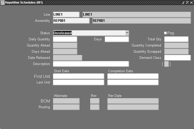

To define a repetitive schedule:
Navigate to the Repetitive Schedules window. The Repetitive Schedule Summary window appears.
Choose the New button to open the Repetitive Schedules window.
Note: You can define several repetitive schedules simultaneously in the Repetitive Schedules Summary window. You can, however, also define repetitive schedules one-at-a-time using the Repetitive Schedules window.
Select the production Line and the repetitive Assembly.
You can select any production Line and associated Assembly. The routing, bill, accounting class, supply type, and completion subinventory/locator defined for the Repetitive Line/Assembly Association selected are defaulted. See: Associating Lines and Assemblies.
Select the schedule Status.
When you define a repetitive schedule, its default status is Unreleased but can be changed to Released or On Hold. See: Repetitive Schedule Statuses.
Enter the Daily Quantity for the repetitive schedule.
If you do not enter the daily quantity, enter the number of processing days and the total quantity.
The number of completed assemblies you plan to produce on the schedule each day. This quantity is effective from the schedule start date to the schedule end date.
Enter the number of Days for the repetitive schedule. Use decimal numbers to indicate partial days (up to 6 decimal places).
This is the number of days that the repetitive schedule requires, from the first assembly completion date through the last assembly completion date, to manufacture the total number of assemblies.
If you enter the number of days, the total quantity is automatically calculated based on the daily quantity. If you do not enter the number of days, enter the daily quantity and total quantity.
Enter the Total Quantity of assemblies that you plan to manufacture with this schedule.
If you enter the total quantity, the processing days are calculated based on the daily quantity. If you do not enter the total quantity, enter the daily quantity and number of processing days.
You can select any enabled and active demand class. Demand classes are not required. See: Overview of Demand Classes, Oracle MRP User's Guide and Creating Demand Classes, Oracle MRP User's Guide.
Check the Firm check box to firm your schedule.
Firming repetitive schedules prevents MRP from suggesting rescheduling and replanning recommendations when changes to supply or demand occur. Firming a repetitive schedule locks in that schedule's daily quantity as the recommended daily quantity for future schedules using that line/assembly association. See: Firm Order Planning, Oracle MRP User's Guide.
Descriptions can be used to identify repetitive schedules on standard reports. They can be up to 240 characters of alpha numeric text. They are not required.
To schedule a repetitive schedule with a routing or a fixed lead time repetitive schedule without a routing
Select a First Unit Start Date (FUSD) or First Unit Complete Date (FUCD) or a Last Unit Start Date (LUSD) or Last Unit Complete Date (LUCD).
Only one date (FUSD, FUCD, LUSD, or LUCD) is required for repetitive assemblies with routings and repetitive assemblies without routings that are associated with production lines that have Fixed lead time. The repetitive schedule is automatically forward or backward scheduled based upon the dates entered.
To schedule a repetitive schedule without a routing that has a routing-based lead time
Select the FUSD and FUCD or select the LUSD and LUCD.
A set of start or completion dates is required for repetitive schedules without routings that are associated with production lines that have Routing-based lead times. The system uses the processing days to schedule the dates not entered.
To assign bill of material and routing revisions and dates
Select the bill of material Revision.
The bill of material defaults based on the repetitive line and assembly selected. You can however, select an alternate revision and revision date and time if alternates have been defined.
You can update the bill revision as long as the repetitive schedule remains unreleased. You can update the revision for standard bills or alternate bills. See: Item and Routing Revisions, Oracle Bills of Material User's Guide.
You can explode item revisions that have associated ECOs with Release, Schedule, and Implement statuses. If you set the WIP:Exclude ECOs profile option to None, you can also explode revisions for ECOs that have an Open status. See: Implementing ECOs in the Oracle Engineering User's Guide..
Select the bill Revision Date and time.
You can update the bill revision date for standard bills or alternate bills. You can update the bill revision date as long as the repetitive schedule remains unreleased.
The routing defaults based on the repetitive line and assembly selected. You can, however, update the routing revision as long as the schedule remains unreleased. See: Item and Routing Revisions, Oracle Bills of Material User's Guide
Select the routing Revision Date and time.
You can update routing revision dates for standard and alternate routings. You can update the routing revision date as long as the schedule remains unreleased. If you do not enter a revision date, the system uses the first unit start date (FUSD).
Save your work.

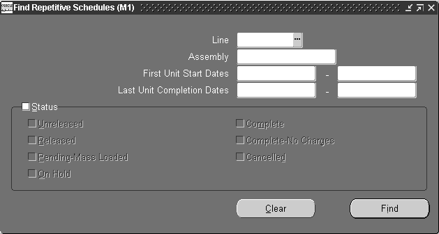

You can find then view, release, change, and reschedule repetitive schedules. You can also find then purge information associated with repetitive schedules.
To find one or several repetitive schedules to view, release, change, or reschedule
When the Find Repetitive Schedules window appears, enter your search criteria.
You can query by assembly Line and Assembly, a range of First Unit Start Dates, a range of First Unit Completion Dates, and Status. You can combine or omit criteria as required.
Note: Querying to find repetitive schedules does not validate the records returned. For example, querying to find a range of schedules to release does not return only those jobs in that range that can be released.
Choose the Find button.

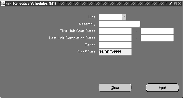

To find one or several repetitive schedules to include in your purge
You can query by assembly Line and Assembly, a range of First Unit Start Dates, or a range of First Unit Completion Dates.
Select an accounting Period or enter a Cutoff Date for the purge.
You can query by closed accounting Period. When you select an accounting period, the end date of that period is defaulted as the purge Cutoff date and cannot be overridden.
If you do not select an accounting Period, the cutoff date of the most recently closed accounting period is defaulted. You can override this date with any date in a closed period.
Note: When purging repetitive schedules, the date a repetitive schedule was changed to Complete-No Charges or Cancelled is compared to the purge cutoff date. Only repetitive schedules that were set to Complete-No Charges or Cancelled on or before the cutoff date are purged.
Note: If you enter a cutoff date that is earlier than the date a repetitive schedule was changed to Complete-No Charges or Cancelled, the system purges only the repetitive schedule detail and transaction information up to the date you enter.

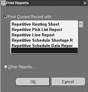

You can print any one of the following reports:
To print a report for the current repetitive schedule
From the Repetitive Schedules or View Repetitive Schedules window choose Print Reports from the Tools menu. .
The Print window appears.
Select the name of the report and choose OK
When you choose OK, a concurrent request to print the report is submitted. You can view the status of concurrent requests. See: Using the Concurrent Requests Window, Oracle E-Business Suite User's Guide.
Choose the New button to navigate to the Repetitive Schedules window.
Select the production Line and Assembly.
Select a FUSD or FUCD or a LUSD or LUCD.
Save your work.

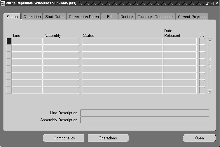

To find repetitive schedules to purge
Navigate to the Purge Repetitive Schedules window. The Find Repetitive Schedules window appears.
Query to find one or more repetitive schedules. See: Finding Repetitive Schedules.
The Purge Repetitive Schedules Summary window appears with the results of your query.
To print reports for the queried records
To view operations and operation requirements for a selected repetitive schedule
From either the Purge Repetitive Schedules or Purge Repetitive Schedules Summary window choose the Operations button.
The operations, if any, required for the schedule are displayed. See: Viewing Job and Schedule Operations.
To view component requirements for a selected repetitive schedule
From either the Purge Repetitive Schedules or Purge Repetitive Schedules Summary windows choose the Components button.
The component materials, if any, required the schedule are displayed. See: Viewing Component Requirements.
