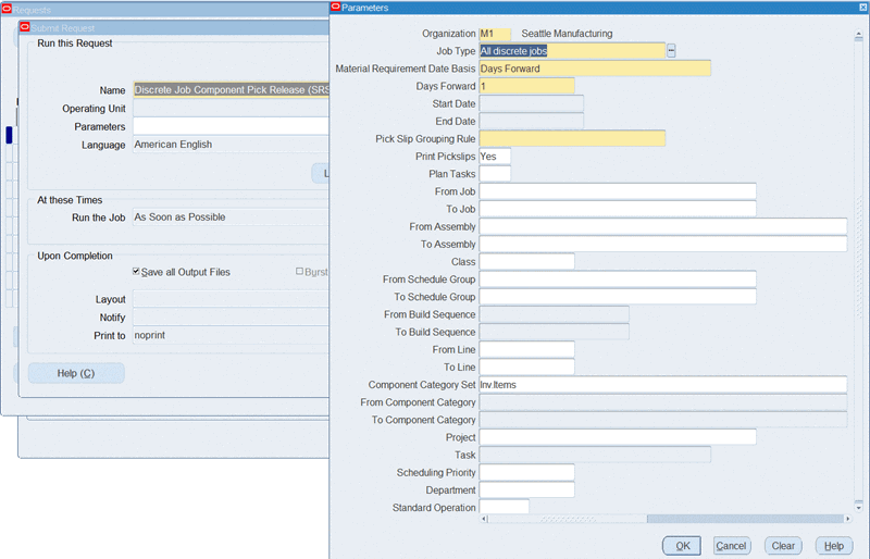

Quantity to Release calculations for Component Pick Release transactions

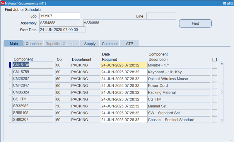

From the Main tabbed region of the Material Requirements region, select the Component to update or add.
You can add items with Push, Assembly Pull, Operation Pull, Bulk, Phantom, and Supplier supply types. If you add Phantom items, their supply types are changed to Push. Supply types are also changed to Push if you add Assembly Pull items to jobs or schedules without bills of material. Similarly, if you add Operation Pull items to jobs or schedules without routings, their supply types are changed to Assembly Pull.
You can add engineering items as requirements if you have the WIP:See Engineering Items profile option set to Yes. See: Profile Option Descriptions and Engineering Bills of Material and Routings in the Oracle User's Engineering User's Guide.
In the case of non-standard discrete jobs, you can add the primary assembly as a component. In other words, the job assembly requires itself. This is useful when you use non-standard jobs to manage rework or disassembly. See: Rework Assemblies and Disassemble Assemblies.
You can add items that already exists as job or schedule component requirements if you add them at a different operation sequence.
If adding a component, select the Operation Sequence number. See: Overview of Routings, Oracle Bills of Material User's Guide and Creating a Routing, Oracle Bills of Material User's Guide.
You can only add components at existing operations. The operation sequence identifies where the material is required.
If you add a requirement to a job or schedule without a routing, the system displays 1 as the default operation sequence. This value cannot be updated.
For jobs with routings, the system displays the start date of the operation as the default. For repetitive schedules with routings, the system displays the first unit start date of the operation as the default. You can update the date required with a date that lies between the start and completion dates of the operation.
For jobs and schedules without routings, the systems displays the scheduled start date of the job or the first unit start date of the schedule as the default. You can update the date required with a date and time that lies between the start date and time and completion date and time of the job or schedule.

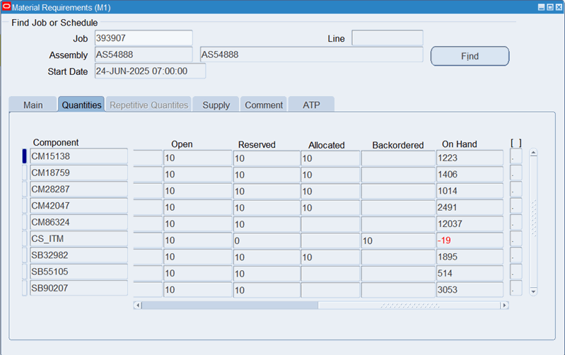

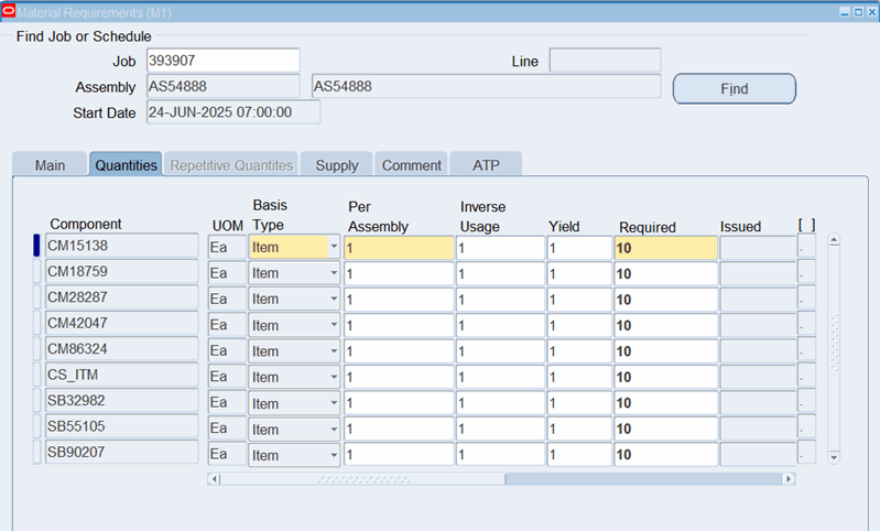

In the Quantities tabbed region, the default Basis Type of the component displays from the bill of material. This field is used for calculating component requirements. You can change this value, your choices are:
Item: Usage quantity is the amount required per job or schedule, and multiplied by the job quantity.
Lot: Usage quantity is taken directly from the bill of material and not multiplied by job quantity, component usage is fixed per lot. See: Fixed Component Usage
Enter the Per Assembly Quantity, or the Required Quantity for the component.
Required Quantity field is calculated based on basis type.
If you are adding a component, the per assembly quantity defaults to 1 and the required quantity is derived from the job or schedule quantity and displayed in the component's primary UOM. It can be updated. If you update the per assembly quantity, the required quantity is automatically calculated.
The Inverse Usage and Yield fields are used in cases where decimal quantities may inflate requirements or cause variances in rounding calculations. The Inverse Usage and Yield fields default to the value of 1. You can edit these fields to fit your manufacturing requirements. See: Component Yield and Shrinkage and Inverse Component Usage
You can view the following quantity details:
Issued: View the issued component quantity.
Open: View the amount of component quantity that is open.
Reserved: View the amount of quantity reserved for a component.
Allocated: View the component quantity allocated during pick release.
Backordered: View the backordered component quantity allocated due to insufficient on-hand quantity during pick release.
On Hand: View the available quantity that is on hand.

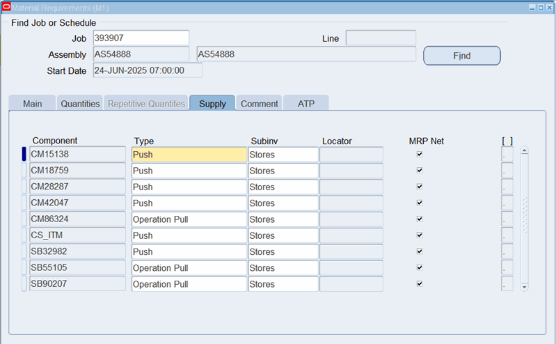

In the Supply tabbed region, select the Supply Type. See: Supply Types.
When you add components, the supply type specified for the item in Oracle Inventory is normally defaulted. If the item does not have a supply type, the supply type defaults to Push.
Supply type selection is restricted based on the type and makeup of the job or schedule. You cannot, for example, change the supply type of a Push component to Assembly Pull if the job or schedule has no routing.
If the component's supply type is Assembly Pull or Operation Pull, you must select the supply Subinventory, and if required by the supply subinventory, the supply Locator. See: Supply Subinventory and Locator Fields, Oracle Bills of Material User's Guide.
Check the MRP Net check box to include material requirements as demand in the calculation of net requirements. See: Net Work in Process, Oracle MRP User's Guide.
If a negative quantity for a standard discrete job or repetitive schedule is entered, this check box is disabled.
For non standard-jobs with a negative quantity, the MRP check box is enabled. However, Oracle planning nets the negative requirement as supply rather than demand.
When initially creating non-standard discrete jobs, this flag is unchecked. You must manually mark the check box for components to be considered as demand by Oracle planning applications.

You can view material requirements for individual discrete jobs and repetitive schedules using the View Material Requirements window. You can also view material requirements across jobs and schedules using this window.
To find and view material requirements

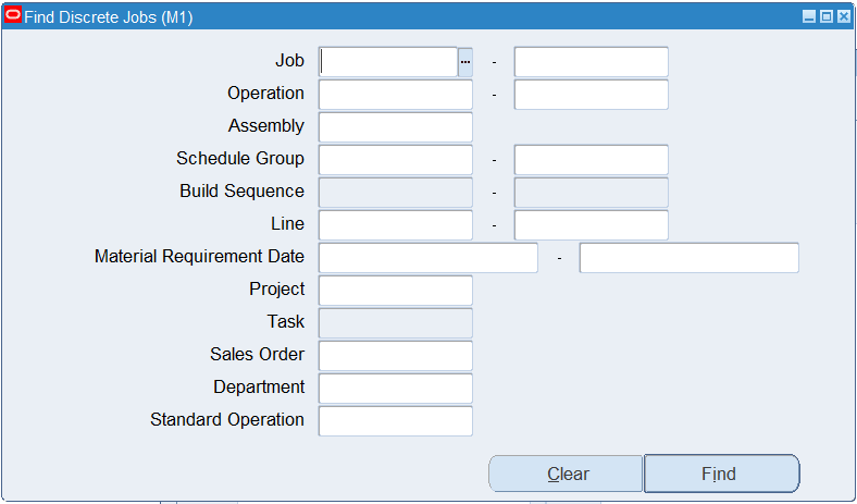

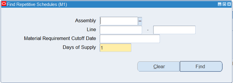

Navigate to the View Material Requirements window. The Find Material Requirements window appears.
You can view requirements for jobs and schedules of a specific status (Unreleased, Complete, Released, On Hold, Complete-No Charges). You can view all requirements for a specific component or all components required from a specific subinventory/locator. You can also view components required on a specific date or within a range of dates. Lastly you can view open or negative requirements.
Enter any combination of search criteria and choose the Find button. The results display in the View Material Requirements window.
You can view the following information in View Material Requirements window's tabbed regions:
Main: Component, Operation Sequence, Department, Date Required, Comments
Note: You can view Component Descriptions using the Material Requirements window. See: Adding and Updating Material Requirements
Quantities: Component, UOM, Per Assembly, Basis Type, Inverse Usage, Yield, Required, Issued, Open, and On Hand

Supply: Component, (Supply) Type, Subinventory, Locator, and MRP Net flag

You can view job and repetitive schedule component requirements by choosing the Components button from the Discrete Jobs, Simulate Discrete Jobs, View Discrete Jobs, Close Discrete Jobs, Purge Discrete Jobs, Repetitive Schedules, View Repetitive Schedules, and Purge Repetitive Schedule windows. You can also view component requirements for a specific job or repetitive schedule operation by choosing Operations, then the Components button from any of these windows. From the Discrete Jobs, Simulate Discrete Jobs, and View Discrete Jobs windows, you can optionally view ATP component information.
Note: Oracle Work in Process does not support Enforce Integer Rounding.
To view component requirements for the current job, schedule or operation
Choose Components, the Material Requirements window (in view only mode) appears.
You can view material requirements across jobs and schedules using the View Material Requirements window. See: Viewing Material Requirements.
The tabbed regions in this window show the following information:
Main: Component, Operation Sequence, Department, Date Required, Component Description.
Quantities: Component, UOM, Basis Type, Per Assembly, Inverse Usage, Yield, Required, Issued, Open, Reserved, and On Hand.
Repetitive Quantities: Component, Per Assembly, Required Today, Issued Today, Ahead or Behind Quantity, Days.
Supply: Component, (Supply) Type, Subinventory, Locator, and MRP Net flag.
Comment: Component, comment
ATP: Component, ATP Allowed flag and ATP Rule
Note: This region is accessible only if you are viewing material requirements using a window that allows ATP checking in the Material Requirements window.
To initiate material reservations for a component
On the Material Requirements window, select the Tools menu.
You can reserve components by selecting one the following choices:
Reserve Line: Creates a reservation for a specific component line in a discrete job, depending on how the component supply type is set up in the Material Reservations section of the WIP Material parameter. Your choices are pull, push, or both supply types. See: Material Reservations
Maintain Component Reservations: Navigate to the Inventory Item Reservation window to create a reservation using subinventory, locator, lot, and serial number. The Item Reservations window does not validate supply type or time fence values. See: Item Reservations, Oracle Inventory User's Guide
Note: To create material reservations for a job or to reserve a discrete job supply for another discrete job as demand, see: Defining Discrete Jobs Manually.
To create, update, and delete high-level component reservations for multiple discrete jobs, you can run the Manage Component Reservations for Discrete Jobs concurrent program. See: Managing Component Reservations
Note: Reserved quantity calculations are based on the component supply type:
For Pull supply types, the reserved quantity is the quantity per assembly, multiplied by the job quantity. The required quantity is not considered.
For Push supply type, the required quantity is always the reserved quantity.
Save your work.
To view component ATP for jobs and repetitive schedules
If the Check ATP button is enabled in the Material Requirements window, you can check the ATP status of components. See: Viewing Component ATP Information.
Note: The Check ATP button is only enabled if you choose the Components button from the Discrete Jobs, Simulate Discrete Jobs, View Discrete Jobs, or View Repetitive Schedules window, or if you choose the Operations button, then the Components button from any of these windows.
You can only check the ATP status of the components that have their ATP Allowed flag set. This flag is automatically set if the Check ATP attribute for that item is set. See: Defining Items, Oracle Inventory User's Guide and Order Management Attribute Group, Oracle Inventory User's Guide.
You can view the ATP status of several component records at one time by choosing multiple records. If you choose Select All from the Edit menu, only those components that have their ATP Allowed flag set are highlighted. If you specifically select components that do not have this flag set, you are warned that the components that you have selected are not Check ATP enabled. You must deselect these components before proceeding. .

To run the Manage Component Reservations for Discrete Jobs concurrent program:
Navigate to the Submit Requests page.
In the Name field, select Manage Component Reservations for Discrete Jobs.
Use the Parameters window to define the request.
Enter the organization.
Enter other parameters to filter your request. Note the descriptions for the following parameters:
Select Yes to include or No to exclude jobs the following:
Unreleased Jobs
Released Jobs
On Hold Jobs
Completed Jobs
Standard Jobs
Non-standard jobs
Select Yes to include or No to exclude the following supply types:
Push Supply Type
Operation Pull Supply Type
Assembly Pull Supply Type
Use the other available fields to specify a range using Assembly, Lines, Schedule Group, Component, and Component Category. You can also enter a project.
The Component Category Set defaults as Inventory items.
In the Component Required within Days field, enter the number of days. The default is 7 days.
In the Reservations field, select from the following:
Create Only New Reservations
Delete All Reservations
Update All Reservations
The default value for the Reservations field is Update All Reservations.
In the Submit Request window click Submit.
Use the Requests window to confirm that the program runs successfully.

To query jobs or schedules for component picking
Navigate to the Component Pick Release window.
The Find window displays fields pertaining to the specific job or schedule type. Select query criteria. You can combine or omit criteria as required.
Discrete Jobs: You can query by range of jobs, operations, schedule groups, build sequences, lines, and material requirement dates. If you are using Oracle Projects or Project Manufacturing, you can search by project number and task number. You can also search using assembly number, sales order information, department, and standard operation. See: Defining Discrete Jobs Manually,
For discrete jobs only, you have the option to pick by a operation sequence range in a single job - or across multiple jobs. All components in the operation sequence range selected are displayed on the Component Pick Release window. This feature is valuable in manufacturing environments where pick releases based on the timing of operations is not feasible, because operation start times are unpredictable.
The Material Requirement Date field is used to search requirements based on a range of Date Requirement values entered on the Material Requirements window.
Note: The Material Requirements Date limits the date components are picked. For example, if you set this date for July 1, and you have requirements for June 1 and August 1 - the system will not consider the August 1 requirements. Set this date to consider material requirements and lead times.

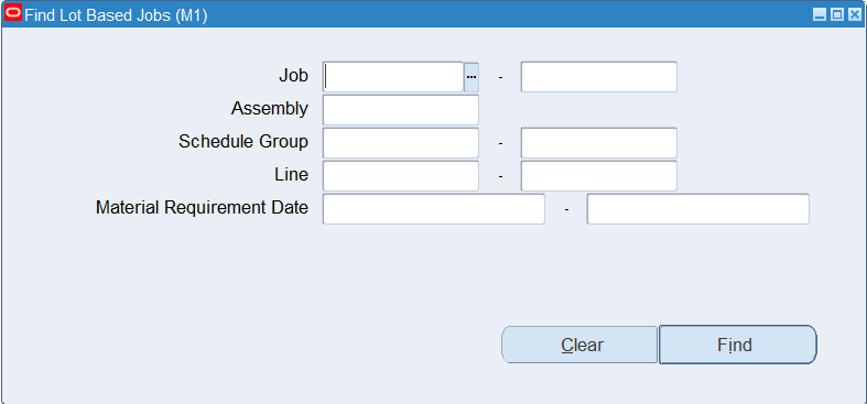

Lot Based Jobs: You can query by Job name, Assembly, Schedule Group, and production Line. See: Creating a Lot Based Job in the Shop Floor Management User's Guide.
The Material Requirement Cutoff Date field is used to search for component records. The Date Requirement value entered on the Material Requirements window is used as the basis.
Note: The material requirements cutoff date limits the date components are picked. For example, if you set this date for July 1, and you have requirements for June 1 and August 1 - the system will not consider the August 1 requirements. Set this date to consider material requirements and lead times.
Repetitive Schedules: You can query by Assembly, production Line, and Material Requirement Cutoff Date. See: Overview of Creating Repetitive Schedules
The Days of Supply value is multiplied by the daily production rate and component quantity per assembly to calculate the pick quantity. If the open quantity is less than the value entered here, the open quantity is used instead.

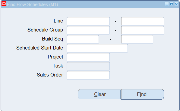

Flow Schedules: You can query by flow Line, Schedule Group, Build Sequence, or Sales Order. If you are using Oracle Projects or Project Manufacturing, you can search by Project Number and Task Number. See: Line Scheduling Workbench Options Window, Oracle Flow Manufacturing User's Guide
Choose Find to display the Component Pick Release window.

To display detail windows of one of the records-expand the job or schedule node in the navigation tree, and select a record. Select the job or schedule to display the summary window.
The information on this window includes Job number, Description, Status, Assembly, Schedule Group Name, Build Sequence, Unit Number, job dates, Release Material flag, and Pick Set.
Select a component to display detail information on this item.
The detail window displays fields for Component, Description, Revision, Operation Sequence, Operation Code, Required Quantity, Quantity to Release, Back Order Quantity, Basis, Supply Type, and Required Date.
Additional Information: The Revision field is null unless you are using Inventory allocation rules, or Warehouse Management rules based picking to choose previous revisions.

To submit requests for component picking
Navigate to the Component Pick Release (SRS) window to display the Parameters window.
Select a program from the following submit request programs, depending on the job or schedule type you are picking:
Discrete Job Component Pick Release (SRS)
Repetitive Schedule Component Pick Release (SRS)
Lot Based Job Component Pick Release (SRS)
Flow Schedule Component Pick Release (SRS)
Component Pick Release Submit Requests Program
In the Organization field, select an organization code from the list of values.
In the Job Type field, select from the following:
Standard discrete jobs
Non-standard discrete jobs
All discrete jobs
In the Material Requirement Date Basis field, select from Date Range or Days Forward.
In the Days Forward field, enter the number of days in the future to consider requirements for this pick release.
For example, if this value is 1, and your program is scheduled to run daily-it will pick up requirements for jobs and schedules up to one day forward. Any new material requirements added today are picked up by the concurrent program when it is scheduled to run next.
Select a rule in the Pick Slip Grouping Rule field.
The grouping rule is used to group tasks based on the pick method. Rules are defined on the Pick Slip Grouping Rules window in Oracle Inventory. See: Pick Slip Grouping Rules, Oracle Inventory User's Guide
In the Print Pick Slips field, select a value of Yes or No to indicate if you want to print the Move Order Pick Slip Report as part of this component pick release.
If this is an Oracle Warehouse Management organization, in the Plan Tasks field, select a value of Yes or No to indicate if you want to release tasks at the time of the pick release.
Yes indicates that the concurrent program will plan tasks and pass this data to the Inventory Pick Release API.
If this pick release is for repetitive schedules, enter a value in the Days of Supply field.
The Days of Supply value is used to calculate the pick quantity. This value is multiplied by the daily production rate, and component quantity per assembly. If the open quantity is less than the value entered here, the open quantity is used.
Optionally, select and enter information for class, component category set, project, task, scheduling priority fields. You can also specify from and to ranges for job, assembly, schedule group, build sequence, line, and component category.
If this pick release is for discrete jobs, select a value in the Department and Standard Operation fields.
Choose OK to display the Submit Request window.
Choose Submit. See: Submitting a Request, Oracle E-Business Suite User's Guide.
Jobs that meet the criteria entered are released when your request is run.
Note: If errors occur in the processing, the concurrent program continues to process the other records in the batch, but ends in a warning displaying a list of records that failed.
