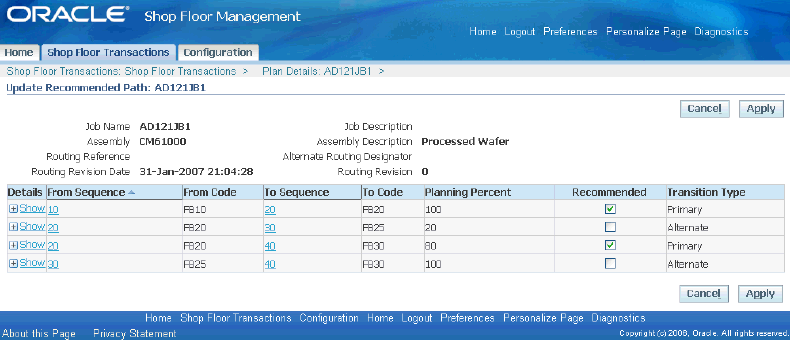

Changing the recommended path of a job to any other valid intended path for future operations.

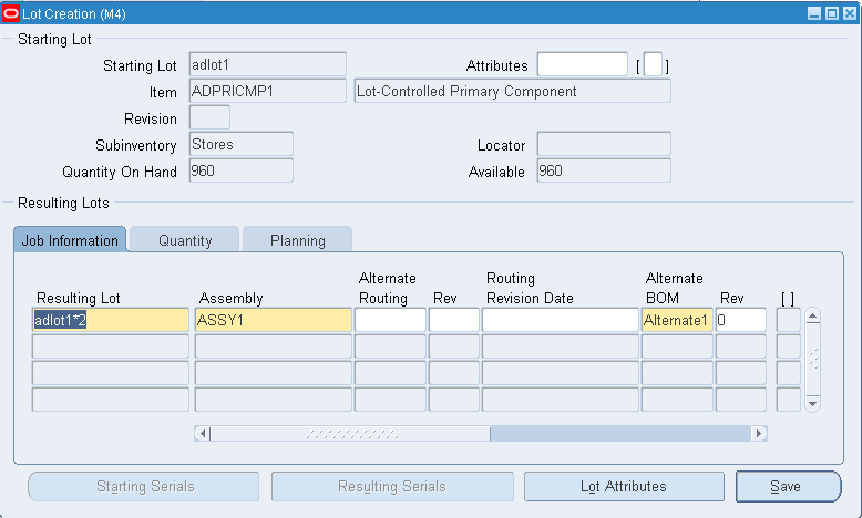

With this new functionality you have the choice to create lots with the same name as the earlier sector.
Default Job Name in Lot Creation form
When you create a lot in Lot Creation form, you have the option of job names being defaulted with the same name as that of the parent lot or different name from that of the parent lot. If you set Reuse Job Name to No, then the newly created jobs will have names with the job separator appended to the parent lot name. If Reuse Job Name is set to Yes, then the newly created jobs will be defaulted with the same name as the parent lot, provided there is only one resulting job. If there are multiple resulting jobs, then the first job will have the same name as the parent lot and the remaining jobs will have names appended with job separator.

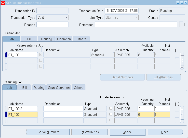

When you cancel a job or perform WIP lot transactions like split, merge, complete scrap, and job completion on a job, the job name will be appended with sector extension.
If the parameter Reuse Job Name is set to Yes the job name will be appended with sector extension.
If the parameter Reuse Job Name is set to No, then the job name will not be appended with sector extension.

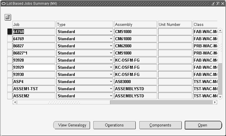

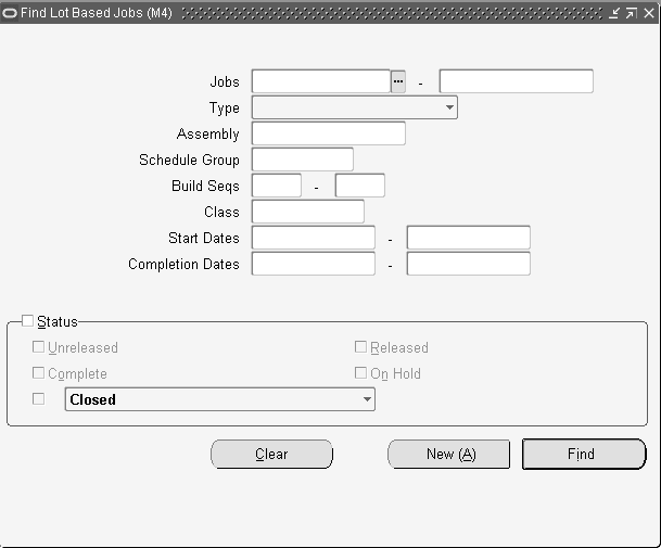

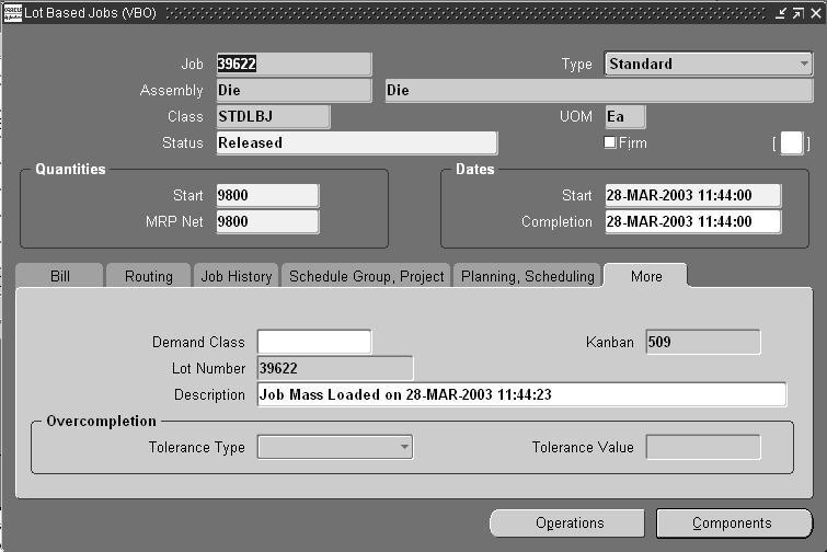

To find lot based jobs
Navigate to the Lot Based Jobs window.
The Find Lot Based Jobs window displays.
Enter your search criteria.
You can query by job name, assembly, accounting class, a range of start dates, a range of completion dates, or job status. You can combine or omit criteria as required.
Choose Find to display the Lot Based Jobs Summary window.
Select a lot based job and choose one of the following actions.
View Genealogy to view historical informations in the Lot Genealogy window, see: Displaying Genealogy and Where used Views.
The Operations window is used to view the resource requirement for the lot-based job.
The lot-based job provides the resource details for the first operation during job creation and the resource requirement for the other operations are shown whenever the job is moved to this operation.
Components to access the Material Requirements window displaying all the components for this job
Open to display the details of this job in the Lot Based Jobs window.

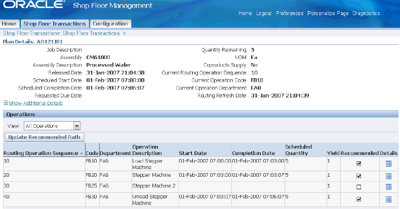

You can choose Plan Details from the Tools menu to open the UI and view the planned operation details.

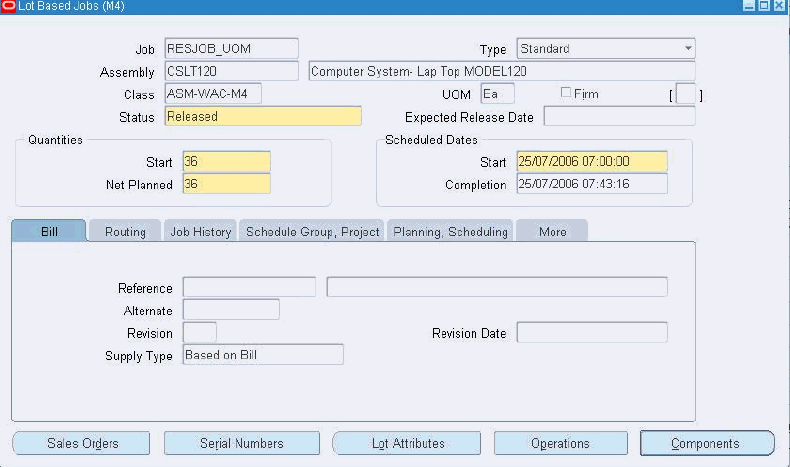

Creating Lot Based Jobs
To create lot based jobs
Navigate to the Lot Based Jobs window. The Find Lot Based Jobs window displays.
If you are creating a new lot, Choose New (A). The Lot Based Jobs window opens.
Enter the name of the job in the Job field.
Oracle Work in Process discrete jobs and Shop Floor Management lot based jobs must not use the same value for Job name. In the Job Type field, the value defaults to standard. Oracle Shop Floor Management uses both standard and non-standard jobs.
As you proceed with the manufacturing process, the job name changes as lots are created, split, renamed, and completed. While creating lots, the name cannot exceed 80 characters.
Note: Do not use the same character value for both the job completion separator, and in a segment of the job name. When lots are completed the resulting lot designation is the original lot number, followed by the job separator value, followed by the lot sector extension. Using the same character value creates an error in the resulting lot name.
Select the assembly in the Assembly field.
Select the job status in the Status field.
When you define a job, its status defaults to Unreleased but can be changed to Release or On Hold.
Use the Firm indicator to firm this job.
Firming a job prevents planning suggestions for rescheduling. However, lot based jobs are not considered in the Oracle Master Scheduling and MRP, but are planned in Oracle Advanced Supply Chain Planning. This field is not used by non-standard jobs.
In the Quantities region, enter the Job quantity of the job or lot in the Start field.
When you enter a Job start quantity for the Lob Based job using bills and routings, the component material requirements and resource equipment for the First Operation will be exploded into this Job.
You can change the quantity on jobs without transactions.
In the MRP net field, the quantity is derived from the job start quantity.
Oracle Shop Floor Management does not integrate with Oracle Master Scheduling/MRP. This field supports Oracle Advanced Planning and Scheduling, applications.
In the Dates region, enter a value in either the Start or Completion field.
If you enter a start date, the completion date is forward scheduled. Similarly, if you enter a completion date, the start date is backward scheduled.
Save your work.

If you choose Launch Plan Details from the Tools menu, then you can view all planned operation details.

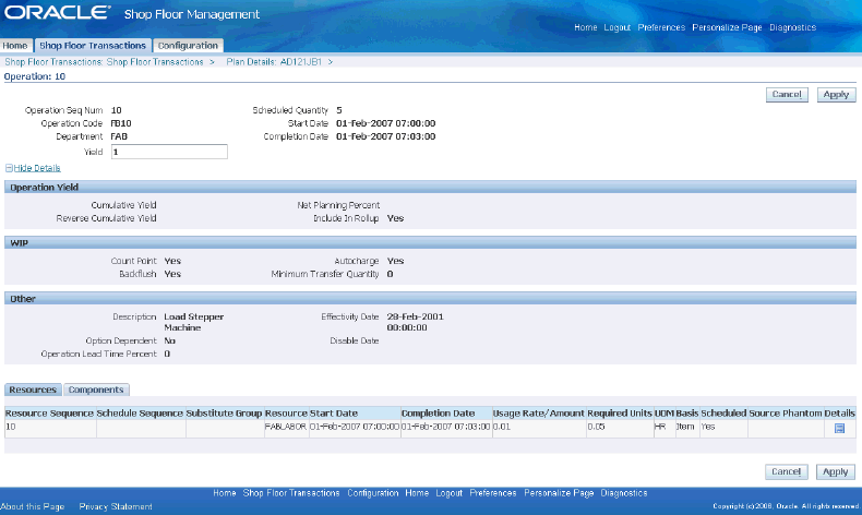

To view the components of all the operations:

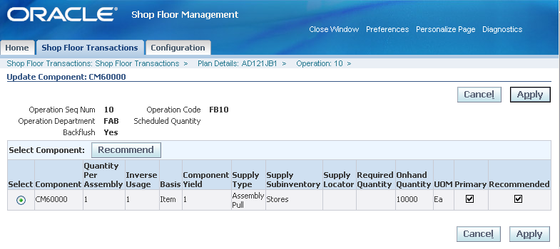

Click on the Tools menu and select the option Plan Details. The Plan Details page appears.
Click on the Details icon for the corresponding Routing Operation Sequence. The Operation page for that particular routing sequence appears.
Click on the Components tab to view the components available for that particular operation.

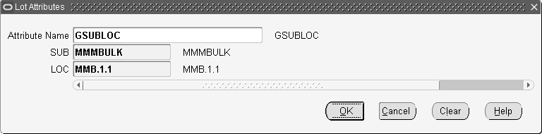

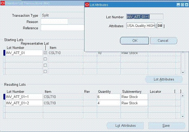

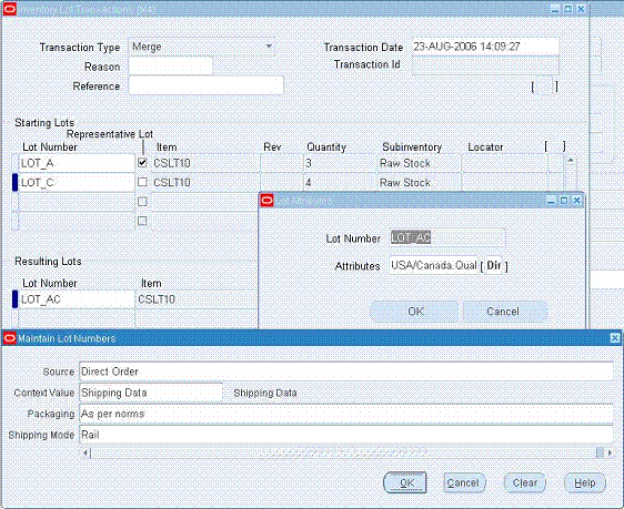

Viewing, Entering, and Updating Lot Attributes
To view, enter, and update lot attributes
Choose Lot Attributes. The Lot Attributes window appears and displays the lot number and attributes of this job.
If you are entering or updating lot attributes, then enter or update attributes with appropriate values for Warehouse Management and Inventory attributes based on the lot attributes setup that you or your system administrator have completed.
Choose OK to save and return to the Lot Based Jobs window.
Choose Cancel if you do not want to save the lot attribute changes.
If you are only viewing the lot attributes without making changes, then you can choose OK or Cancel.
Save your work.
Note: If you do not enter a required segment value, then an error message appears. If you wish to view detailed information for an error message, then you must execute the concurrent request Get Messages using the parameter DB_TO_RUNTIME with a specific Language.

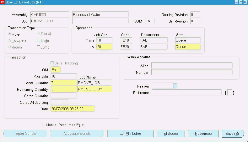

Select the Partial check box if you want to move a job partially to the next operation in sequence, when required, or within an operation from one intraoperation step to another. Partial check box is clear by default.
Enter the quantity (from the Available quantity) you want to partially move to the next operation in the Move Quantity field.
The original job with the partial quantity moves to the specified next operation, the split part (child job) of the original job will remain at the same operation level with the difference in the original quantity.
The remaining quantity is displayed in the Remaining Qty field. The check box is defaulted for the next move transaction. If the Partial check box is checked, the Move Quantity and Remaining Quantity cannot be zero.
You can move a partial quantity of a job during a Move transaction. A new job is created for the remaining quantity, while the partial quantity is moved with the parent job. It is equivalent to a combination of a WIP Split transaction in the background and a Move transaction.
Partial Move is not supported with the Move and Scrap transaction. It is also not supported for jobs at Run interoperation step.

To view, enter, and update lot attributes:
Choose Attributes in the Lot Attributes window. A new Lot Attributes window appears.
Select an Attribute from the list of values.
Enter parameter and segment values.
Choose OK.
Save your work.

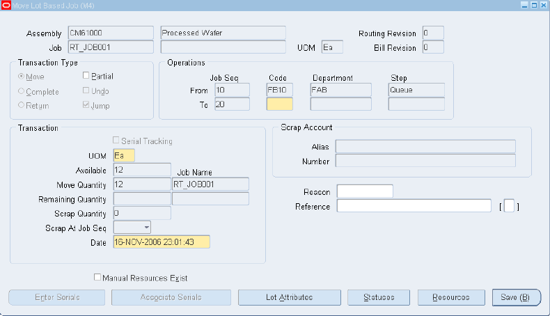

The operation jump functionality enables you to skip operations in a routing, or jump to any operation not defined in the network routing. To use this functionality, set the following parameters:
Oracle Shop Floor Management profile option, Allow Operation Jumps is set to Yes. See: Profile Options
Work in Process Parameters window, set the Move Transaction Parameter—Allow Creation of New Operations—to Yes
Oracle Shop Floor Management Parameters window, set the parameter Jump From Queue according to your need. See: Defining Parameters.
Navigate to the Move Lot Based Jobs window.
In the Assembly or Job field, select either an item assembly number or lot job number.
Depending on which value you enter, the defaulting information for the From the Transaction Type region, check the Jump check box.
In the To row, enter any operation sequence number which is greater than the From operation sequence number.
Select an operation code and the step for the operation to which you want to jump.
Create remaining transactions as described in Creating Lot Move Transactions.
After completing the jump operation, you can move to any of the operations defined in the original routing to complete the balance of operations.
Save your work.

You can change the recommended path of a job to any other intended path for future operations using the Update Plan Recommended Path UI window.
To update the plan recommended path
Navigate to the Lot Based jobs window and open a job.
Select Plan Details from the tools menu.
The Oracle Shop Floor Management HTML Plan Details UI window appears. The Header region displays job details and the Operations region displays operations for the job. In the Operations region, the default view shows the recommended operations in their order on the recommended path. The view can be changed to show all operations.
Choose Update Recommended Path in the operations region to make changes to the recommended components and quantities. The Update Recommended Path UI window appears. Select or clear the recommendations to create a new recommended path.
Choose Apply to save your changes and return to the Plan Details UI window, or choose cancel to discard any changes.
You can view details for a recommended resource, and view alternate resources using the Plan Resource Details window from the HTML UI.
To view plan resource details for a recommended resource
Navigate to the Lot Based Jobs window and open a job.
Select Plan Details from the tools menu. The Plan Details UI window appears.
Choose Details from a Routing Operation Sequence. The Plan Operation Details UI displays.
Choose Details.
The Plan Resource Details window appears.
You can view and change the recommended plan components using the Update Components UI window.
To update the recommended plan components
Choose the Details icon for a Routing Operation Sequence. The Plan Resources and Components Details UI window appears.
Choose Components to display component information.
Select a Component and choose Update.
Select a component line and choose Recommend. The Update Components UI window appears.
Enter any changes to Required Quantity and choose Apply to save your changes. Choose Cancel to discard any changes and return to the Plan Resources and Components window.
Note: If you make changes to the plan details of an operation through the HTML UI, then changes are effective the next time you come to that operation. To make changes to the current operation in real-time, use WIP windows.

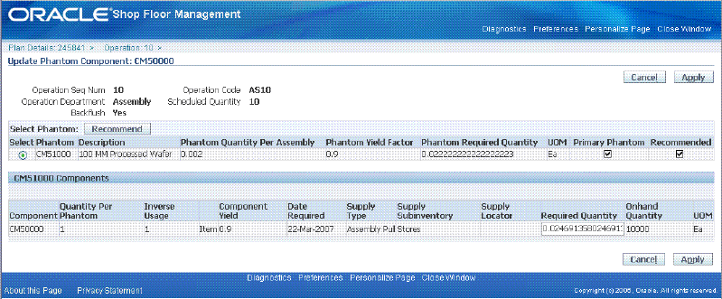

You can use the Update Phantom Component UI window to view and change the recommended phantom components. If you have a BOM with the phantom supply type for one of the components, then you can view phantom details in the UI. If you have substitutes for an item, then you can also choose substitutes. See: Phantoms and Phantom Routings.
See also: Phantoms in Lot Based Jobs, Oracle Bills of Material User's Guide.
To update plan phantom components
Choose Plan Details from the Tools menu. The Plan Details UI window appears.
Choose the Details icon for a Routing Operation Sequence. The Plan Resource and Components UI window appears.
Select the Phantom component that you want to make changes to, and choose Update.
Select a phantom component and choose Recommend. The Update Phantoms UI window appears.
Select the Phantom and enter any Required Quantity changes. Choose Apply to save changes, or choose cancel to discard any changes and return to the Plan Resources and Components UI window.

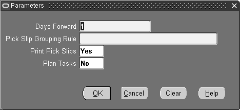

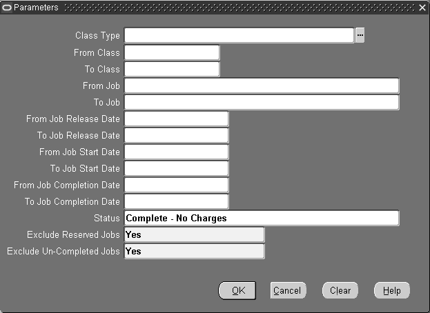

Navigate to the WSM_REFRESH_JOBS Parameters window.
Enter Yes or No to Refresh All Open Jobs. (Required)
You can refresh all open jobs with any status except Closed by entering Yes for Refresh All Open Jobs. If this value is Yes, then the application ignores all other search parameters, and refreshes BOM and Routing copies for all open lot based jobs in the current organization. If this value is No, then additional job selection criteria are required.
Enter a range of jobs to refresh in the From Job Name and To Job Name fields (Optional).
Enter a Job Assembly (Optional).
Enter the Job Type (Optional).
Enter a Common Bill Item and Alternate Bill Designator (Optional).
Enter a Common Routing Item and Alternate Routing Designator (Optional).
Enter Yes or No to Select Jobs by Status.
If you select No, then the application refreshes the specified jobs and does not consider job status. If you select Yes, then the application considers each of the job status values that you select.
Choose OK.
The WSM_REFRESH_JOBS window displays the request information.
Choose Submit.

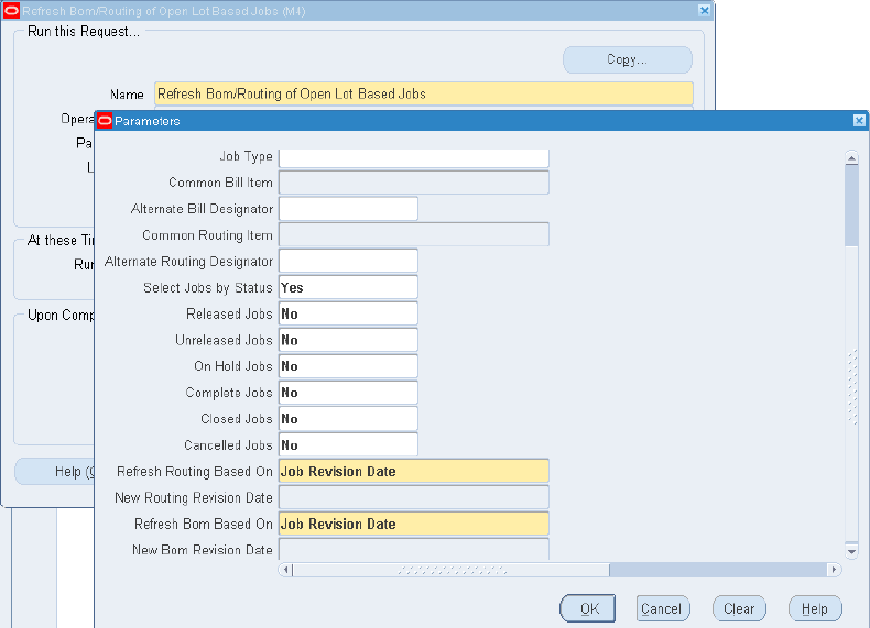

Note: If the Refresh Open Job Copies concurrent program runs, and the Infinite Scheduler program runs to assign dates on the jobs. If scheduled dates are not available, the Resource Centric Work bench will not show these jobs or operations in the Workbench user interface.
Refresh Open Job Copies updates copy tables, but does not refresh current operation information. Refreshing copy tables is intended to update future operations with changes. Any changes made to the current operation from the User Interface are not captured by the Resource Scheduling Workbench or lot based job. If you intend to make changes to current operations, then you must use WIP windows.
Refresh BOM/Routing of Open Lot Based Jobs functionality is used to propagate the changes made to bills of material and routing of an assembly to the jobs that were created for the assembly prior to the changes. This enables the jobs to get the new (or changed) details of the BOM/Routing that are refreshed based on the routing revision date.
Previously, the changes made to BOM/Routing were effective as on Routing Revision Date. To update the routing revision date on the job and incorporate the changes, you have to do Update Routing transaction through the OSFM WIP Lot Transaction. But if the changes made to BOM/Routing are not effective as on the Routing Revision Date, then the changes will not be updated on the job.
Refresh BOM/Routing of Open Lot Based Jobs with Revision Dates refreshes all selected jobs based on New Revision Dates or Current Job Revision Dates, depending on the parameters you select. If you update the job's BOM or Routing, then Refresh Job Copies concurrent request runs to successfully update plan details of the job.
Four parameters are added to Refresh BOM/Routing of Open Lot Based Jobs concurrent request, so that you can refresh all selected jobs either as per Job Revision Date or New Revision Date. These parameters (two for BOM and two for Routing) are:
Refresh Routing Based On:
This has three values.
Job Revision Date: If you select this option, then the job is refreshed based on the job's current Revision Date.
New Revision Date-All Jobs: If you select this option, then enter a new date for the New Routing Revision Date parameter. Job's plan details are updated based on the new date.
New Revision Date-Job Revision Date less than new date: If you select this option, then enter a new date for the New Routing Revision Date parameter. In this case, the job is refreshed in the following ways:
If the job's current revision date is less than New Routing Revision Date, then the application updates the job's plan details based on the New Routing Revision Date.
If the job's current revision date is greater than New Routing Revision Date, then the application updates the job's plan details based on the job's current Revision date.
New Routing Revision Date: Enter a New Routing Revision Date to refresh whenever required as described in the previous option.
The two similar parameters for BOM are Refresh BOM Based On and New BOM Revision Date. The preceding descriptions apply for BOM as it is for Routing.
Oracle Shop Floor Management provides the ability to split lots, merge lots, and perform additional other advanced lot transactions. Lots exist at different production points as either WIP lots or Inventory lots. Two windows, one for the WIP lot and the other for Inventory lot, give you the ability to perform various work in process and inventory transactions so you can divide, combine, rename existing lots, or create new lots from scrapped material. These windows enable you to do the following actions:

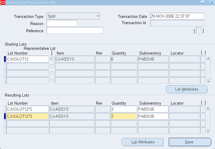

Lot Splitting: divide a lot into two or more resulting lots: split a released lot into two or more resulting lots that can have different resource, material requirements, and different operations.
Lot Merging: combine multiple lots of the same item into one resulting lot. The jobs to be merged must be at the same operation, department and intraoperation step. Identical assemblies are not required.

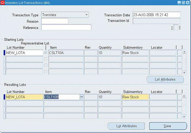

Update Assembly: change the item, quantity, or revision of an existing lot and move it to another assembly. The lot number is renamed in these transactions.
Bonus: recover scrap quantities to create a new lot, or create an entirely new lot.
Use the WIP Lot Transactions window for these transactions.

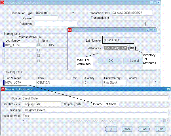

Use the Inventory Lot Transactions window for this transaction.
WIP Split and Merge functionality provides business solutions on the shop floor so you can do the following tasks:
Lot Splitting: You can divide a lot into any number of child lots. The parent lot can be at any operation in the routing and may have created material, resource and cost transactions. The split lots have a value proportional to the number of units being split away. Scrap and variance due to scrap are associated with the lot number in the scrap transaction. Child lots have their own routings and bills of material, and you can create transactions against different child lots immediately after a split. Backward movement for a split transaction is not allowed. The transaction processing for splits is not linked to the cost processing for splits, as transactions may be entered into the system via the interface at any time. When a lot is split into multiple children, the standard costs collected at the starting job are redistributed to the resulting jobs.
New lot numbers are automatically assigned to the child lots of a split transaction, but can be changed. New lots are independent entities linked by a transaction history associating their genealogy.
The split transaction can update the assembly of the child job while performing the split transaction. This provides greater flexibility and reduces the number of transactions. Support for combined split and update assembly transactions are also available through open interfaces.
Lot Merging: Multiple lots with identical assemblies can be combined to create a single parent lot. Only lots at the same intraoperation step are merged. The new job is now at the operation where the lots were merged.

Update Assembly: One product can be translated into another product—that is—change the item, quantity, revision, or routing of an existing lot and move it to another assembly. There are no costing implications in this transaction. You can also switch to an alternate routing on the same operation step.
If the translation is updating the routing, then the WIP lot is updated with an alternate network routing defined for the assembly. When this type of translation is performed at the queue intraoperation step, the operation characteristics correspond to the same operation, if existing, in the new routing. You can also update the routing revision, or routing revision date without changing the alternate designator. It is mandatory to provide the starting operation if the job is at a To Move intraoperation step.
If the user specifies a new BOM revision or BOM revision date during an update routing transaction through the WIP lot transaction interface, then it would be honored and the job would have the revised BOM revision and BOM revision date after the transaction. The job plan operations and components would be based on the new routing revision date and the new BOM revision date. The revision date would be honored both for standard jobs as well as for non-standard jobs. Note that this feature is not supported through forms. Update of BOM alternate is not allowed when carrying out an update routing transaction.

To create WIP lot split transactions
Select the split transaction type.
In the Starting Job region, in the Lot Number field, select the lot number of the parent lot to split.
The lot details display: assembly number, operation sequence number, intraoperation step, operation code, quantity remaining in the lot, alternate routing, and start date.
In the Resulting Job region, in the Job tab, the new lot number displays.
The system automatically assigns a new lot number according to your setup in the Shop Floor Management Parameters window, see: Defining Parameters. When a lot is split, the new resulting lot designation is the original lot number, followed by the lot separator value set in the parameter, followed by sequential numbering.
The representative lot is transferred from the original lot number. Enter the quantity in the Resulting Quantity field.
Select the Change Assembly indicator to execute a split and update transaction.
The Change Assembly indicator is active only when you select the split transaction type. The split transaction can now update the assembly of the child job while performing the split transaction. You cannot clear (uncheck) this indicator, therefore, you must exit and open the window.
If you select the Change Assembly indicator, then enter a new Assembly and Resulting Quantity.
You cannot update Accounting Class for non-bonus WIP Lot transactions. You cannot update Start and Completion Dates except for any WIP transaction other than bonus where you can provide the start date and completion dates.
You can also enter routing and bill of material information in the Routing Information and the BOM and More tabs.
Save your work.

For split transactions, select the lot to split in the Starting Lot region.
In the Resulting Lot region—the system automatically assigns new lot numbers according to your setup in the Shop Floor Management Parameters window, see: Defining Parameters. When new lots are created, the resulting lot designation is the original lot number, followed by the lot separator value set in the parameter, followed by sequential numbering.
The lot details are transferred from the original lot number: item number, quantity, subinventory location, and locator. Enter the quantity of the new lot in the Quantity field. You can also change the subinventory location.
If a co-product definition is defined, then there should be no date in the future where the split percentages remain undefined. For this reason, you cannot change existing date ranges. If you want to change date ranges, then define new dates that overlap with existing dates.

For lot translating transactions, select the lot you want to rename in the Starting Lot region.
In the Resulting Lot region—select the new name for the lot. You can change the item number in the Item field and the subinventory location, if required.

Split
Lot attributes specified during Job Creation, Execution, or Completion get transferred from the job (WIP lot) to the inventory lot.
Lot attributes of the Starting Lot defaults to the Resulting Lots and you can update them, if required.
Navigate to Inventory Lot Transactions window.
Select Split as Transaction Type.
Enter Lot Number in the Starting Lots region to query.
Click Lot Attributes in the Starting Lots region.
The Lot Attributes window appears displaying the Lot Number and the WMS and Inventory lot attributes.
Click OK.
Enter split lot details.
Click Lot Attributes in the Resulting Lots region.
Inventory lot attributes default and update them if required.
Merge
Lot attributes of the Representative Lot are transferred to the Resulting Lot and you can update them if required.
Select Merge as Transaction Type.
Enter Lot Number in the Starting Lots region.
To check the lot attributes, click Lot Attributes in the Starting Lots region.
The Lot Attributes window appears displaying the lot number and the WMS and inventory lot attributes.
Click OK.
Click Lot Attributes of the Resulting Lots region.
The Lot Attributes window of the resulting lot appears.
Check and update the Inventory Lot Attributes.
Click OK.
Translate
Update Lot Name
Lot attributes are transferred to the Resulting Lot and you can update them if required.
Select Translate as Transaction Type.
Click OK.
Update the Lot Name of the resulting lot in the Resulting Lots region.
Click Lot Attributes.
The Lot Attributes window appears.
Update the inventory lot attributes for the updated lot name.

To create lots on the shop floor
Select an Inventory lot number in the Starting Lot field.
Information displays for subinventory location, locator number, item number and description, revision number, quantity on hand, and quantity available to transact.
In the Job Information tab, the resulting job name will be defaulted based on the Reuse Job Name parameter. When multiple jobs are created, the first job name will be defaulted based on the Reuse Job Name parameter and the remaining jobs will be defaulted with the starting lot number, followed by the New Lot Separator value, followed by sequential numbering. You can also define the revision number and revision date for bill of material and routing in order to use the component and operations effectivity.
Information displays in the following fields and can be changed: Accounting Class, Completion Subinventory and Locator.
Note: Please note that the starting component with phantom supply type in the first operation of the subsequent sector assembly bill of material is not allowed. Therefore, the Lot Creation window does not permit you to create the lot based job with phantom supply type material in the first operation.
If you define two components in the first operation, then only one is pushed into this job based on the starting lot selected.

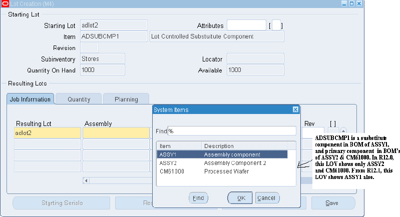

Using Substitutes during Lot Creation
You can also create a lot based job from a substitute item. For example, Item A is an assembly item and Item B is the component for Item A. In the event of nonavailability of Item B, you can identify an alternate item or a substitute item for Item B from Bills of Material of Item A. You can enter an inventory lot number for this alternate or substitute item and create a lot based job for Item A.
When you enter a lot number in the lot creation form, all other information of that starting lot default. In the resulting lot assembly, you can select the assembly of the substitute component for which the lot based job is being created.
Substitute component should be at the first operation and it should not be a phantom component, i.e., Supply Type of primary component of the substitute component should not be phantom in bills of material.
If the same component is present as substitute and primary component at the first operation, then it is treated as primary component.
If the same component is a substitute of two primary components in the same bills of material, then it is treated as a substitute of primary component with minimum sequence number in bills of material.
ADSUBCMP1 is a primary component in BOM of ASSY2 and CM61000.
ADSUBCMP1 is a substitute component in BOM of ASSY1.
You can now create a lot by issuing primary as well as substitute components.

To view lot attributes for starting lots
Choose Attributes.
If the starting lot contains attributes, then the lot attributes window appears.
Choose WMS or INV attributes to view individual segments of the attribute.
Choose OK when you are finished viewing the attribute.

Kanban is a pull based replenishment process in a manufacturing system. You can create lot based and discrete jobs to replenish empty kanbans. In addition, Kanban supports creation of lot based jobs by selecting the starting inventory lot during Kanban replenishment process.
The following are major features of Kanban support on lot-based jobs:
During Kanban replenishment process, you can choose the starting inventory lot for the item attached to first operation. This is similar to lot-based job creation using the Lot Creation window.
Use the Honor Kanban Size parameter to create a lot based job quantity equal to kanban size when components are pushed from an inventory lot during kanban replenishment. If this check box is not selected, lot based jobs are created for the maximum number of assemblies which can be built using the selected component lot. If the check box is selected, the application will honor the kanban lot size.
After a job is created using Kanban replenishment, you can query the Lot Based Job window to view Kanban information.
If the assembly from replenishment lot based job is completed, then the supply status of a production Kanban is updated to Full.
Shop Floor Management allows jobs with a Kanban reference to be merged with another job with a different kanban reference (case 1), or a job with a kanban reference with a job without any reference (case 2). In the first case, one of the jobs is the representative lot, for that WIP lot the net effect from a kanban standpoint is the same as a quantity update. But for a nonrepresentative lot, the quantity become zero and the corresponding Kanban card status is set to Empty, and the job should not be referenced. In the second case, if the Kanban reference job is the representative lot, then the net effect from a Kanban standpoint is the same as a quantity update for that job. Otherwise, the quantity becomes zero, the corresponding Kanban card status is set to Empty, and the job should not be referenced. See: Defining Kanban Pull Sequences, Oracle Inventory User's Guide.

To run the Lot Based Job Component Pick Release (SRS) report
Navigate to the Lot Based Job Reports window.
Select the Lot Based Job Component Pick Release (SRS) report from the Name list of values.
Enter Days Forward.
Enter the Pick Slip Grouping Rule from the list of values.
Optionally, enter Print Pick Slips for the list of values.

Choose Submit to run the report.

To run the Pending Transactions Report
Select the Pending Transactions Report from the Name list of values. The Parameters window appears.
Enter report parameters.
Choose OK.

Lot Based Job Creation/Lot Creation: Starting a job at an OSP results in automatic purchase requisition creation. For the define Lot Based Job and Lot Creation windows, the starting operation, which is always the first operation of the routing, would need to have an OSP resources for this to occur. Creating a lot based job to start at a PO Move OSP operation gives an error and not allow the transaction to be saved (applies for both released and unreleased status).

Split/Merge: Performing WIP lot transactions that have new resulting jobs, such as split or merge, would mean that purchase requisitions or purchase orders for the starting jobs would need to cancelled manually. Note that instead of canceling all purchase requisitions or purchase orders for starting jobs and creating new purchase requisitions for resulting jobs, you can keep existing purchase requisitions or purchase orders by updating their distribution. Also note if a purchase requisition, purchase order is kept because a starting job retained quantity and became a resulting job, then the quantity listed on that purchase requisition or purchase order would need to be updated manually.

Move: Moving a job to the queue of any OSP operation results in the automatic creation of purchase requisitions. Moving to a PO Move OSP operation results in an error. You can move from an OSP operation without formally receiving the OSP item.
Jump: Jumping to the queue of an OSP operation, both inside and outside the routing, results in the creation of a purchase requisition. A jump from an OSP operation queue (with Charge Jump From Queue set to OFF) results in a warning to manually cancel purchase requisitions. Jumping to a PO Move OSP operation results in an error.
