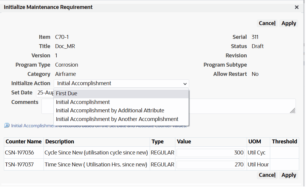

Initializing Maintenance Requirements
To initialize a maintenance requirement
  1. Retrieve the unit maintenance plan record. See: Finding Unit Maintenance Plan Records.
  2. Click the MR link, and the Update Maintenance Requirement page appears.
  3. Click the Affected Items link, and the View Affected Items page appears.
  4. Click the Initialize button for an MR, and the Initialize Maintenance Requirement page appears.
    the picture is described in the document text
  5. Select a value in the Initialize Action drop-down list. Options are:
    • First Due
    • Initial Accomplishment
    • Initial Accomplishment with Additional Attributes
    • Initial Accomplishment with Another Accomplishment
  6. Select an initialization date in the Set Date field.
  7. Enter values for the counters.
  8. Click Apply to save your work.

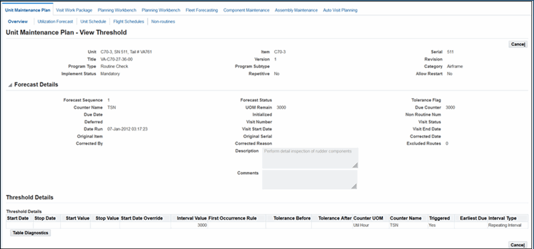

Viewing Maintenance Requirement Thresholds
The Unit Maintenance Plan module enables you to view maintenance requirement thresholds.
Prerequisites
To view maintenance requirement thresholds
  1. Retrieve the unit maintenance plan record for which you want to view maintenance requirement thresholds. See Finding Unit Maintenance Plan Records.
  2. Select the record, and choose View Threshold from the Select Unit Maintenance Plan drop-down box.
  3. Click Go.
    The Unit Maintenance Plan - View Threshold page appears, displaying the thresholds relevant for the selected record.
    The following section describes the fields on the Unit Maintenance Plan - View Threshold page.
    See Creating Maintenance Requirement Records and Working with Maintenance Plans for the description of the fields.
    Header Information
    • Unit
    • Title
    • Program Type
    • Implement Status
    • Item
    • Version
    • Program Subtype
    • Repetitive
    • Revision
    • Category
    • Allow Restart
    Forecast Details
    • Forecast Sequence
    • Forecast Status
    • Tolerance Flag
    • Counter Name
    • UOM Remain
    • Due Counter
    • Due Date
    • Initialized
    • Non Routine Num (number)
    • Deferred
    • Visit Number
    • Visit Status
    • Date Run
    • Visit Start Date
    • Visit End Date
    • Original Item
    • Original Serial
    • Corrected Date
    • Corrected By
    • Corrected Reason
    • Excluded Routes
    • Description
    • Comments
    Threshold Details
    • Start Date
    • Stop Date
    • Start Value
    • Stop Value
    • Start Date Override
    • Interval Value
    • First Occurrence Rule
    • Tolerance Before
    • Tolerance After
    • Counter UOM
    • Counter Name
    • Triggered
    • Earliest Due
    • Interval Type
  4. Click the Cancel button to return to previous page.
