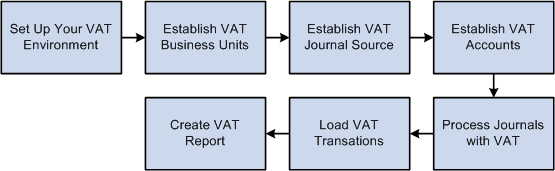

This diagram illustrates VAT processing in PeopleSoft General Ledger:
