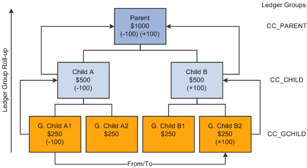

Generate parent budgets, budget adjustments, and budget transfers automatically.

You also have the option to automatically generate and post parent budget level impacts.
The same functionality is available from within the Budget Transfer component.
Note. Budget journal entries are not created for the generated parent budgets. The posting process generates and posts the parent level impacts, but the generated parent level journal lines are stored in the KK_SOURCE_HDR, KK_SOURCE_LN, and KK_ACTIIVTY_LOG tables.
See Generate Parent Budgets, Budget Adjustments, and Budget Transfers Automatically.

You also have the option to automatically generate parent-level budget adjustments from child budget adjustment entries.
See Generating Parent Budgets, Budget Adjustments and Budget Transfers Automatically.

This diagram shows how a budget transfer initiated at the lowest level within a budget hierarchy is reflected at each level in the ledger groups hierarchy:
Parent budget impacts generated by child budget journal transfer
In this example, 100 USD is transferred from the budget G Child A1 to budget G Child B2 within the same CC_GCHILD ledger group. Assuming that you previously set up the option to automatically generate the parent budget impacts, when the originating child journal is posted, the impact to the CC_CHILD and CC_PARENT ledger groups is automatically generated and posted to the budget ledgers for each successive ledger group in the hierarchy.
Automatically
Set user preferences for access to automatically generate parent budgets.
Set options for automatic generation of parent budget journals.
View the results of processing originating journals.

Setting Options for Automatic Generation of Parent BudgetsAccess the Budget Header page (Commitment Control, Budget Journals, Enter Budget Journals, Budget Header).
Setting Parent Budget Options
Generate Parent Budget (s) |
Select this check box to automatically create parent level budget and budget transfer journals for a budget hierarchy no matter how many child to parent budget layers might be involved. The Generate Parent Budget (s) check box is available only under certain setup and security options:
Parent Budget Entry Type |
Select Original or Adjustment budget entry type to be applied to the generated parent budget journals. For transfers the values are Transfer Original and Transfer Adjustment. This field is available only if you have access to and have selected the Generate Parent Budget (s) check box. |
Use Default Entry Event |
Select this check box when the Generate Parent Budget option is checked and you are using entry event functionality for the generated parent budget journals. You establish the default entry event value on the Control ChartField page when you set up the control budget definition for the parent budgets that are to be generated. Note. If you have a single setID for Control ChartField, but more than one setID for Entry Event codes, it is possible that a single control ChartField value may need to be associated with different entry event codes depending on the business unit involved. For this reason, prompting for the default entry event values on the Control ChartField page presents entry event codes across all setID values. However, it is only possible to link one default entry event code with a particular setID and control ChartField value. See Defining Control ChartFields. If the Entry Event for Budgets Ledger field for the parent ledger group is set to Optional in the ledgers for a unit component, budget posting applies default entry event code values from each parent budget that has the Entry Event for Budgets Ledger option set to optional or required. This occurs even if the child budget line in the originating journal does not have entry event populated. If a default entry event code has not been specified within the budget definition on the Control ChartField page of the parent, the originating journal is posted and the parent impacts are created but a warning message is issued for the parent. The warning is issued if entry event is optional and no value is specified. However, the system logs an error if entry event is required and no value has been specified. If a parent ledger group has the Entry Event for Budgets Ledger field set to Required in the ledgers for a unit component, the default entry event code is applied regardless of the setting for the Use Default Entry Event check box on the budget journal header. If a default value is not established for the parent budget definition, the budget posting process errors out (fails) and the originating child journal and parent impacts are not generated. |
Note. In no case does the system supply, or default, an entry event code for the originating budget entry line if one is not entered.
