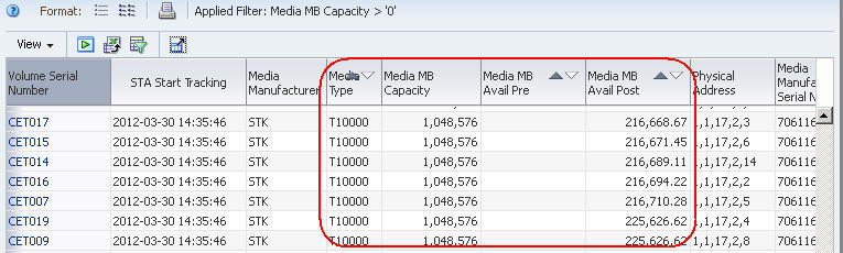

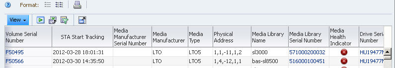

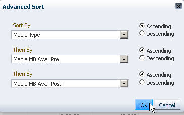

Note – LTO drives report “Media MB Avail Pre” and StorageTek enterprise drives report “Media MB Avail Post”. Sorting on both attributes allows you to capture all drive types.
c.
The table is sorted according to your criteria.
