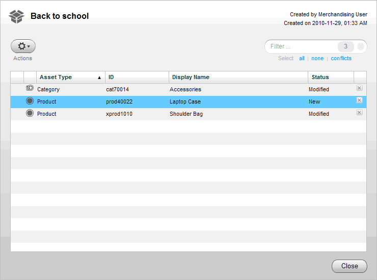

To see the assets that have been added to the current project, click the name of the project at the top of the Merchandising window.
Merchandising displays the project dialog box, which contains all the project’s assets.
When you create an asset, for example a product, the asset is automatically added to the current project, with the status New in the project dialog box. The new asset also appears in the Navigation pane for this project. The asset will be published to the live Web site when the project is deployed. The asset is also added to the versioning system.
