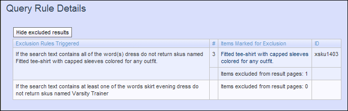

If you want to view the excluded items, click Show excluded results. When you click the button, the following updates are made to the test output:
Excluded items appear in the results list with a strike through the item’s name. For an example, see Positioning and Exclusion Rules in the Results List.
The table of triggered exclusion rules is updated to show each excluded content item in the current page of results along with its position number and item ID, as shown in the figure below.
You can look at where the excluded item would have appeared in the results list to analyze whether the rule is useful and has the intended effect. If an excluded item is not on the current page of results, look at the number of items excluded to determine if it might appear on other pages.
All triggered exclusion rules are listed in the query rule details output, even if the excluded items are not returned by the search. In this case, when you click Show excluded results, the rule appears in the list, but no item IDs appear next to it, and the number of items excluded is zero. You can use this information to determine whether the exclusion rule is necessary.
To remove the excluded items from view, click Hide excluded results. The excluded content items no longer appear in the output.
