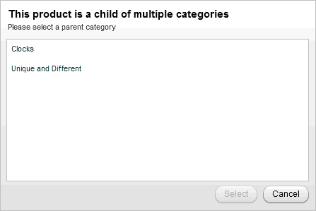

If you click a product, the light table displays the fixed child products for that product’s parent category. If the product has more than one parent category, select the category to display and click Select in the dialog that appears.
