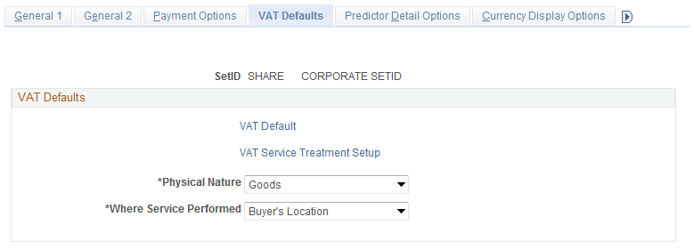

Receivables Options - VAT Defaults
BUS_UNIT_OPT_AR5
select Set Up Financials/Supply Chain, then select Business Unit Related, then select Receivables, then select Receivables Options, then select VAT Defaults
Define the defaults for VAT processing.

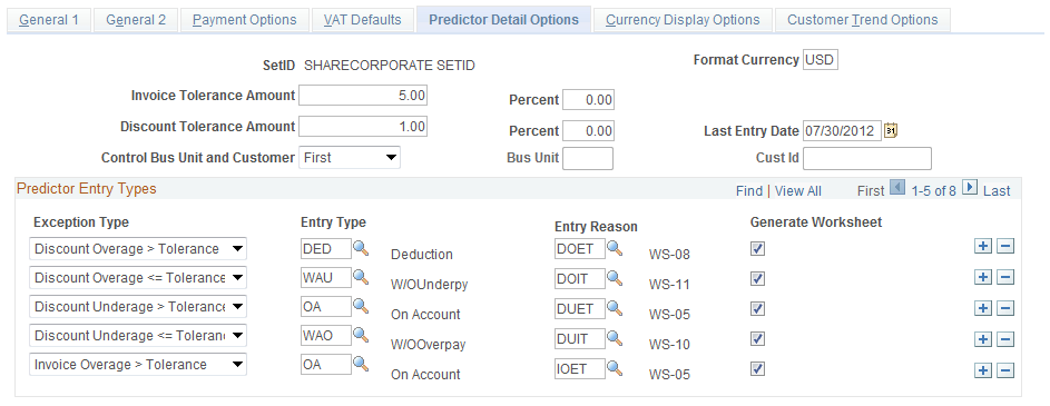

Receivables Options - Predictor Detail Options
BUS_UNIT_OPT_AR6
select Set Up Financials/Supply Chain, then select Business Unit Related, then select Receivables, then select Receivables Options, then select Predictor Detail Options
Define the maximum write-off amounts and discount tolerances for the #DTL_TLR algorithm group.
Specify the default entry type and reason that the Payment Predictor process (ARPREDCT) uses to create accounting entries for partial payments and discounts when it executes the algorithm group.

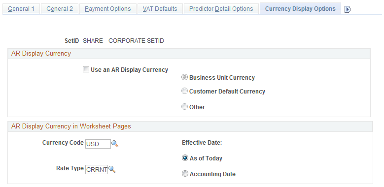

Receivables Options - Currency Display Options
BUS_UNIT_OPT_AR7
select Set Up Financials/Supply Chain, then select Business Unit Related, then select Receivables, then select Receivables Options, then select Currency Display Options
Specify the default currency that appears on some of the inquiry pages, the maintenance and transfer worksheets, and the run control pages for dunning letters and statements.

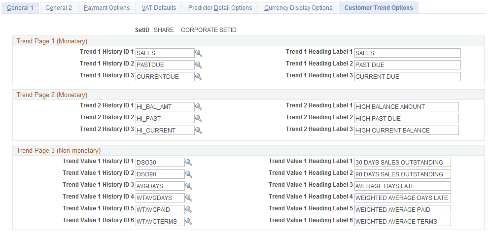

Receivables Options - Customer Trend Options
BUS_UNIT_OPT_AR8
select Set Up Financials/Supply Chain, then select Business Unit Related, then select Receivables, then select Receivables Options, then select Customer Trend Options
Define the historical statistics that you want to appear on the Customer Trend 1 page, Customer Trend 2 page, and Customer Trend 3 page.

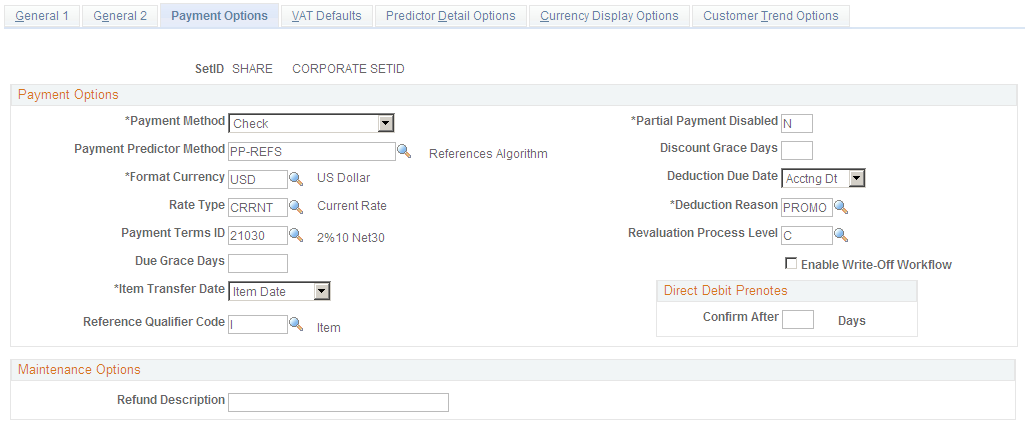

Receivables Options - Payment Options Page
Use the Receivables Options - Payment Options page (BUS_UNIT_OPT_AR2) to define defaults for payment processing, grace days, deduction dates, revaluation, and worksheets.
Image: Receivables Options - Payment Options page
This example illustrates the fields and controls on the Receivables Options - Payment Options page. You can find definitions for the fields and controls later on this page.
Payment Method
Select the default payment method for items. Options are: Check, Credit Card, Direct Debit, Draft, Electronic Funds Transfer, or Giro - EFT.
Override the value for individual customers, items or payments.
Note: If you receive payments using a payment interface, such as an electronic data interchange (EDI), lockbox, or bank statement, select Check or Electronic Funds Transfer. If you receive electronic payments for acceptgiro attachments, select Giro - EFT.
Payment Predictor Method
Select the method that the Payment Predictor process uses if you do not specify a method at the customer level. The payment predictor method defines the rules that the process uses to apply payments and to make adjustments such as write-off items.
See Defining Payment Predictor Methods.
If you want to use Payment Predictor to apply all payments from a particular bank account, select the Payment Predictor check box on the External Accounts - Account Information page. Override this default, and select or deselect Payment Predictor for individual payments, using the deposit entry pages.
Format Currency
Select the default currency that the system uses for receivables processing.
Rate Type
Select the exchange rate type that the system uses to perform currency conversion. Override the default at the customer level or when you enter pending items, enter deposits, create maintenance worksheets, or create customer-initiated drafts.
Payment Terms ID
Select the default payment terms for the business unit. Override the default at the customer level or when you enter pending items. Define payment terms on the Payment Terms page. The payment terms determine the item due date and discount information.
Partial Payment Disabled
Enter a value that determines whether you can modify the amount on the payment worksheet to create a partial payment. The default is N, which enables users to create partial payments. Enter Y if you do not want users to create partial payments.
Due Grace Days
Enter the number of days beyond the due date that a customer can pay without the payment being considered late. The Overdue Charges Application Engine process (AR_OVRDUE) uses due grace days to determine whether an item is overdue. If the item's due date is May 1, 2003 and you run the process on May 2, 2003, the process does not create an overdue charge if you enter 5 for the due grace days. However, after the grace days pass, the system calculates overdue charges from the item's due date. The Aging process uses grace days to determine in which aging category to place an item. For example, you enter 5 days and an item is 22 days old. You have aging categories for 10, 20, and 30 days. The item would be in the aging category for 10 days, because the system subtracts five days from the age.
Discount Grace Days
Enter the number of days beyond the discount date that a customer is still eligible for an earned discount. Payment worksheets, express deposits, and the Payment Predictor process use discount grace days to calculate discounts.
Override the due grace days and discount grace days for a customer on the Bill To Options page and for individual items during pending item entry or item maintenance.
Enable Write-Off Workflow
Select this check box to activate approval workflow for write-offs entered on the payment worksheet, maintenance worksheet, or draft worksheet. This approval workflow is controlled by the Approval Framework feature in PeopleSoft Enterprise Components. The user is not able to set the worksheet to post until the write-off amount is approved. Both the approver and the worksheet user can set the worksheet to post after approval is granted.
See Setting Up Write-Off Approval Workflow.
Item Transfer Date
Select the option that the system uses to determine the accounting date for transfer activities when you transfer items from one customer to another. Options are:
Item Date: The accounting date of the original item.
System: The current system date.
Deduction Due Date
Select the type of date that the system uses to determine the due date of the new item created for a referenced deduction. Select Acctng Dt (accounting date) if the due date is to be the accounting date of the payment. Select Item Dt (item date) to carry over the original item due date.
Deduction Reason
Select the default deduction reason to assign to new deductions that the Payment Predictor process or payment and draft worksheet create. Users can override the reason when they create the deduction on the payment worksheet or on the View/Update Item Details - Detail 1 page. Use a generic reason as the default reason and override it as needed.
Note: You can also create unique deduction reasons for each entry reason for the Deduction entry type. If you do this, the system assigns the appropriate deduction reasons for deductions that you create on the payment or draft worksheet.
See Understanding Exception Reasons and Collection Codes.
Reference Qualifier Code
Select the type of remittance information generally provided by customers, such as document, item, or bill of lading. This is the default value for identifying items to include in the payment, draft, maintenance, and transfer worksheets. You can override the value at the customer level.
(USF) Entity Code and Receivable Type
Enter the default code that identifies the government agency to which you submit the Receivables Due from the Public report and the code that categorizes the types of receivables that are included on the report. This value is the default for items. These fields are available only if you select the Receivables Due From Public check box on the Installation Options - Receivables page.
Revaluation Process Level
Select the level where the revaluation process occurs. Options are: B (business unit), C (customer ID), or I (item). You must specify a revaluation level to summarize revaluation information by a specific level according to these rules:
  • If you summarize at the business unit level, the values for customer ID and item ID are 0.
  • If you summarize at the customer level, the value for the item ID is 0.
  • If you summarize at the item level, each field contains a value.
Confirm After n Days
Enter the default number of days that a prenote will be automatically confirmed by the system.
  • When Prenote Required check box on the Bill To Options page for the customer (select Customers, then select Customer Information, then select General Information) is selected and New is selected for the Prenote Status on the same page.
  • If Prenote Required check box is not selected for a customer on the Bill To Options page, and it is selected for the bank or in the Direct Debit Profile, the Create Direct Debit process will update the Confirm After n Days field on the Bill To Options page for the customer with the default days entered in this Confirm After n Days field on the Payment Options page of the Receivable Business Unit.
Refund Description
Enter a description that can be populated as the default voucher description in Payables vouchers. The refund description can indicate why the voucher was created (for example, a refund in Receivables).
Receivables Options - VAT Defaults Page
Use the Receivables Options - VAT Defaults page (BUS_UNIT_OPT_AR5) to define the defaults for VAT (value-added tax) processing.
Image: Receivables Options - VAT Defaults page
This example illustrates the fields and controls on the Receivables Options - VAT Defaults page. You can find definitions for the fields and controls later on this page.
VAT Default
Click this link to access the VAT Defaults Setup page.
The VAT Defaults Setup page is a common page used to set up VAT defaulting for all PeopleSoft applications processing VAT transactions. On this page you can define PeopleSoft Receivables VAT business unit defaults as applicable.
Use the VAT Defaults Setup page to identify this PeopleSoft Receivables business unit as subject to the domestic reverse charge provision by selecting Yes in the Domestic Reverse Charge field. In addition, use the Domestic Reverse Charge Sales field to enter a VAT Transaction Type code and enter a value in the VAT Driver field. The domestic reverse charge fields are displayed on various receivable transactions for pending item entry, draft entry, and payment entry.
See Domestic Reverse Charge Goods VAT.
VAT Service Treatment Setup
Click to access the Services VAT Treatment Defaults Setup page.
The Services VAT Treatment Defaults Setup page is a common page used to set up VAT services treatment defaults for all PeopleSoft applications processing VAT transactions. If you are required to implement special handling for services, you can specify PeopleSoft Receivables VAT service treatment defaults on this page as applicable.
When defining service VAT treatment defaults for a specific service, you specify the defaults applicable to that service. When defining defaults for a driver higher in the hierarchy, such as a supplier, customer, or business unit, you specify the defaults that apply to the services most often supplied by or for that driver.
Note: The VAT Defaults Setup and Services VAT Treatment Defaults Setup pages are described in detail in the PeopleSoft Global Options and Reportsdocumentation.
Physical Nature
Select the default physical nature for transactions. Options are: Physical Goods or Intangible/Services.
Where Service Performed
Select the default location for where a service is most often physically performed. Options are: Buyer's Location, Ship From Location, Ship To Location, or Supplier's Location.
Receivable Options - Predictor Detail Options Page
Use the Receivable Options - Predictor Detail Options page (BUS_UNIT_OPT_AR6) to define the maximum write-off amounts and discount tolerances for the #DTL_TLR algorithm group.
Image: Receivables Options - Predictor Detail Options page
This example illustrates the fields and controls on the Receivables Options - Predictor Detail Options page. You can find definitions for the fields and controls later on this page.
The Payment Predictor process uses the tolerances that you specify to write off or adjust an underpayment or overpayment or to adjust the discount amount when you run a payment predictor method that executes the #DTL_TLR or #DTL_TPM algorithm groups. The system uses these tolerances for underpayments to determine whether to write off or adjust the balance, or make a partial payment if the Partial Payment Switch check box on the Bill To Options page for the customer is selected. If you deselect the Partial Payment Switch check box, it only uses the tolerances to determine whether to write off or adjust the balance. The tolerances apply to individual items not to all invoices paid by the payment.
Assigning Default Entry Types and Reasons
Enter the entry type and entry reason codes that you want to use to override the defaults for the system function. The following table provides a list of conditions that are in the Exception Type field and the default system function that the Payment Predictor process uses for the condition. It also provides other system functions that you can use for the exception type and the entry type and reason to enter if you want the Payment Predictor process to use that system function.
Condition
Default System Function
Possible
System Functions
Entry Type and
Reason
Invoice amount or percent overage within tolerance
WS-10 (Write-off an Overpayment)
WS-09 (Write-off an Item)
WS-06 (Adjust Remaining Overpayment)
WO and IOIT
AO and IOIT
WAO and IOIT
Invoice amount or percent overage exceeds tolerance
WS-05 (Place Amount on Account)
WS-04 (Prepay an Item)
OA and IOET
PR and IOET
AO and IOET
Invoice amount or percent underage within tolerance
WS-11 (Write-off an Underpayment)
WS-07 (Adjust Remaining Underpayment)
WO and IUIT
AU and IUIT
WAU and IUIT
Invoice amount or percent underage exceeds tolerance
WS-08 (Create a Deduction)
DED and IUET
Discount amount or percent overage within tolerance
WO and DOIT
AU and DOIT
WAU and DOIT
Discount amount or percent overage exceeds tolerance
DED and DOET
Discount amount or percent underage within tolerance
WO and DUIT
AO and DUIT
WAU and DUIT
Discount amount or percent underage exceeds tolerance
OA and DUET
PR and DUET
AO and DUET
Select Generate Worksheet on this page and in payment predictor methods where you use the #DTL_TLR algorithm group to generate a worksheet when the condition occurs. This enables you to review the payment application before you post it.
Note: If you use the #DTL_TLR algorithm group in a payment predictor method, the Payment Predictor process uses default entry types and reasons (for each system function) for underpayment, overpayment, and discount conditions. However, you can override the defaults by business unit based on their SetID. You must assign these entry types and reasons to the system function on the Automatic Entry Type - Selection page.
Receivables Options - Currency Display Options Page
Use the Receivables Options - Currency Display Options page (BUS_UNIT_OPT_AR7) to specify the default currency that appears on the Collections Workbench and some of the inquiry pages, the maintenance and transfer worksheets, and the run control pages for dunning letters and statements.
Image: Receivables Options - Currency Display Options page
This example illustrates the fields and controls on the Receivables Options - Currency Display Options page. You can find definitions for the fields and controls later on this page.
AR Display Currency
AR Display Currency in Worksheet Pages
The values that you enter here determine the default values that display on the Currency Conversion page for maintenance, payment, and transfer worksheets. You can override the values at the worksheet level if needed. The values are used to convert the item amounts to a different currency and they display in the Conversion Amount - Currency field if you use the Currency Conversion page to convert them.
Receivables Options - Customer Trend Options Page
Use the Receivables Options - Customer Trend Options page (BUS_UNIT_OPT_AR8) to define the historical statistics that you want to appear on the Customer Trend 1 page, Customer Trend 2 page, and Customer Trend 3 page.
Image: Receivables Options - Customer Trend Options page
This example illustrates the fields and controls on the Receivables Options - Customer Trend Options page. You can find definitions for the fields and controls later on this page.
Enter the history ID that you want to use to calculate the historical data for each of the trend pages along with the heading label that you want to display for the data on the trend pages. You use the trend pages to compare historical data for different history IDs. Enter either system-defined or user-defined history IDs.
The Customer Trend 1 and Customer Trend 2 pages can display up to three historical statistics for history IDs that track amounts, such as High Balance Amount, and the Customer Trend 3 page can display up to six historical statistics for history IDs that track the number of days, such as average days late.
