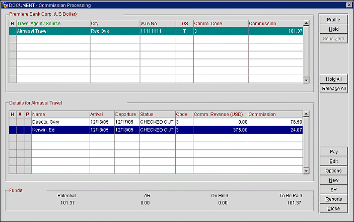

Commission Processing Screen
The Commission Processing screen may be used to perform the following activities:
The Commission Processing screen consists of three main sections.
Travel Agent/Source Grid
The following information is displayed in the upper grid (travel agent/source grid):
H. An X in this column indicates that all commissions are being held for the agent or source. (See Hold or Release Commissions, below.)
Travel Agent/Source. Travel agent or source profile name.
City. City of the travel agency or source profile.
IATA No. Travel agent's IATA number.
Note: If the Profiles>IATA YN application parameter is set to Y the IATA number is validated upon entry and only numerals are allowed. If this parameter is set to N, any character may be entered in the IATA number. When non-numeric characters are included in an IATA number, however, the EFT export file may fail when processed by a third-party system.
T/S. T = travel agent; S = source.
Comm. Code. Profile's commission code. (See Commission Codes for details.)
Commission. Amount of the commission payment to be generated for that agent or source.
Note: Amount is shown in the bank currency. To determine this amount, the exchange rate is applied to the commission amount in the hotel currency; decimal places shown correspond to the number of decimal places appropriate for the bank's currency.
Send Zero
Select the Send Zero button to send the commission records for all zero commission reservations associated with the agent/source to the commission history marked "Paid," without including them in the check or EFT payment file. Use this feature, for example, to avoid cutting checks for zero amounts.
Note: Zero amount commission records sent to commission history include those commission records for which the commission was prepaid.
You are first prompted whether you wish to transfer all zero commission records for the associated bank account to history. If you reply Yes, all zero commission records for the selected bank account are sent to history marked "Paid." If you select No, a second prompt asks whether you wish to transfer all zero commissions for the highlighted agent or source to history. If you respond Yes, all zero commissions for the selected agent or source are sent to history marked "Paid." If you respond No, you are returned to the Commission Processing screen.
This button is active only when the cursor is in the Travel Agent/Source grid.
Commission Details Grid
The lower grid (commission details grid) lists the commission detail records resulting from reservations attached to the agent or source highlighted in the upper grid. The following information is shown:
H. An X in this column indicates commissions associated with this record are being held until further notice. For example, a disputed amount may need investigation before commissions can be processed. (See Hold or Release Commissions, below.)
A. An X in this column indicates commissions associated with this record are being applied to offset the travel agent's or source's accounts receivable account. (See Flag to Offset AR, below.) Detail records marked in this column will be processed out of commissions, but no check or EFT payment authorization will be issued.
Note: This column is automatically marked if the transaction code specified by the Cashiering>AR Settlement Trn Code application setting is attached to a posting for the reservation.
P. An X in this column represents a (whole or partial) prepaid commission. For example, if a guest had paid the travel agent for the stay, the travel agency provides the property with a voucher for the full amount, less the agreed upon commission amount. The property will post the full amount to the guest folio and then make a Prepaid Commission posting to indicate that the commission has been deducted. This prevents the property from paying a commission twice.
Note: This column is automatically marked if the transaction code specified by the Commission>Default Prepaid Commission Trn Code application setting is attached to a posting for the reservation.)
Name. Guest name on the reservation that generated the commission.
Arrival. Stay arrival date.
Departure. Stay departure date.
Status. Reservation status.
Code. Commission code that was used to determine the commission amount. (See Commission Code for details.)
Note: A commission detail record is highlighted in yellow and placed on hold if multiple commission codes apply during the guest's stay.
This might be the case, for example, if more than one rate code applies to the reservation over the course of the stay. The travel agent/source commission code will apply in this case; if there is no commission code attached to the travel agent/source, the default commission code applies. You may edit the record to change the default. See About Commissions Setup for details about the commissions hierarchy.
Comm. Revenue. Commissionable revenue in local currency (currency code shown in parentheses).
Commission. Commission amount owed to the agent/source for this stay.
Funds
The following information is shown in the lower part of the screen.
Potential. Total funds required to pay all commissions for the one or more agents/sources displayed in the upper frame.
AR. Total value of commission amounts flagged as Held to Offset AR for the one or more of agents/sources displayed in the upper frame. The number represents the total commission amount held to offset the agents' and/or sources' accounts receivable accounts. (See Flag to Offset AR, below.)
On Hold. Total value of commission amounts being held for the one or more agents/sources displayed in the upper frame. (See Hold/Release Commissions, below.)
To Be Paid. Difference between the Potential amount minus the On Hold amount minus the AR amount (Potential – On Hold – AR = To Be Paid).  This is the value of the commissions to be processed when the Pay button is selected.

Commission Processing Options
The options described in the following sections are available from the Commission Processing screen Options menu.
Flag to Offset AR
Highlight a commission detail record and select the AR button, or click in the A column, to flag the commission payment to offset the travel agent's or source's accounts receivable account. An X displays in the A column of the commission details grid next to the highlighted guest name. (Click in this column again to remove the X and release the commission record for normal processing.)
Note: This column is automatically marked if the transaction code specified by the Cashiering>AR Settlement Trn Code application setting is associated with a folio attached to the reservation.
When commissions are processed, commission records marked with an X in the A column are removed from the commission details grid without creating a check or an EFT payment record. A notation is added to the check register for the attached bank account such that when the batch details are viewed (Commissions>Payment Activity) for the travel agent or source, the Guest Details screen shows an X in the A column next to the guest's name. (See Payment Activity for details.)
Detach a Commission Detail Record from an Agent/Source
Note: Either of two parameters can be used to attach a reason code when a hold is placed on a commission payment or when a commission is detached from an agent/source. The Commission>Default Reason Code setting allows you to select a default hold/detach reason code that will automatically be attached to the commission detail record when you stop processing.  The second application parameter is Commission>Stop Processing Reason Codes. If this parameter is set to Y, each time you apply stop processing to a commission record, you will be prompted to select the reason. (Reason codes are set up using Configuration>Commissions>Stop Processing Reasons.)
A commission detail record may be detached, or de-linked, from a travel agent or source. (This option is available only if the commission record is already attached to an agent/source.)  Commission detail records may be detached from the agent or source regardless of whether the stay record was added manually via the guest's Profile screen History option  or generated automatically by OPERA.
To detach a commission record, highlight your choice on the Commission Processing screen and select the Detach button from the Options menu. Depending on the Commission parameters for your property, you may be prompted to enter a reason for detaching the commission detail record from the agent/source.
Note: If a travel agent or source is attached to a reservation in the commission payment process, the agent/source remains attached to the reservation until it is detached by using the Detach feature, or  until a different agent or source is attached to the reservation. If both a travel agent and a source are attached to a reservation, detaching one profile will not automatically detach the other.
The detached commission record is removed from the Commission Processing screen's commission detail records list for the agent or source from which it was detached. When the detached commission detail record is edited (see Commission Details), the name of the agent/source from which the commission was detached and the detach reason, if applicable, is shown in the lower Notes area. The reason is also shown in the notes area on the Reservation Search screen when the associated reservation is highlighted.
The commission detail record may be attached to another agent/source. To do so, search for the agent or source using the Agent/Source Search screen.  Select the new agent/source and use the Search button on the Commission Processing screen to locate and select the commission detail record you wish to add to the new agent/source.
Note: If the commission detail record is on hold at the time it is detached, it remains on hold — even if it is attached to a new agent/source — until it is explicitly released.
Note: Either of two parameters can be used to attach a reason code when a hold is placed on a commission payment or when a commission is detached from an agent/source. The Commission>Default Reason Code setting allows you to select a default hold/detach reason code that will automatically be attached to the commission detail record when you stop processing.  The second application parameter is Commission>Stop Processing Reason Codes. If this parameter is set to Y, each time you apply stop processing to a commission record, you will be prompted to select the reason. (Reason codes are set up using  Configuration>Commissions> Stop Processing Reasons.)
A "hold" may be placed on a commission to prevent it from being paid when commission payments are processed. A hold can be placed on a commission either manually or, in some cases, automatically.  An automatic hold can be placed on a commission by selecting the Always Hold Status flag on the Commission Code New or Edit screen (see Commission Codes for details). When a commission is associated with that commission code, it will automatically be placed on hold. A manual hold can be placed on a commission for many reasons. For example, you may wish to investigate a possible discrepancy before payment. Or, the reservation may belong to a group booking and you want to wait until all group members check out before processing the commission payment.
Once a commission is placed on hold, you can at any time manually release the hold making the commission eligible for payment.
The Hold and Release options are available at the agent/source level and at the individual reservation commission detail record level.
Agent/Source Level Hold
Placing a hold at the agent or source level automatically places a hold on all outstanding commissions attached to reservations associated with that agent or source.
To apply hold at the agent/source level, highlight the agent or source in the upper grid and select the Hold button (this button toggles between Hold and Release, depending on the state of the highlighted item). An X appears in the H column next to the agent/source name, and X's appear in the H column for each reservation associated with that agent/source. To release the hold, again highlight the agent or source and select the Release button. This will not release the hold on other travel agents/sources or their details.
To apply a hold to all reservations for all travel agents or sources in the upper grid, select the Hold All button. An X appears in the H column next to all agent/source names, and X's appear in the H column for all reservations. To release the hold, select the Release All button.
Reservation Commission Level Hold
Highlight the commission details record and select the Hold button to place a hold on an individual commission. or select the Release button to release a commission for payment (this button toggles between Hold and Release, depending on the state of the highlighted item).  You may also click in the H column to place an X next to the commission you wish to place on hold. Click again to release a commission for payment.
