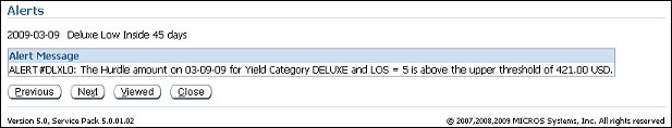

The Alerts section automatically generates and displays any alerts that have been configured whose thresholds have been exceeded on the selected dates. The date format displayed is based on what is configured in Opera. These alerts can pertain to Hurdles, Forecast, Overbooking, and On the Books (On the Books - OTB - can be set up individually or with a Forecast alert). For alerts configuration and descriptions, see Configuration Tab Alerts and Rules for details.
Click on an alert to display the full description about the alert. The Alerts screen appears where you can view the Alert Message sorted by alert type ( OTB, Hurdles, Forecast, and Overbooking) for the date.

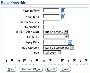

Batch Override. When selecting this button, the Batch Override screen displays. This screen gives you the option to globally override hurdles, Overbookings and OOO Ceilings for a pre-defined date range.
