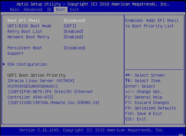

  11. If you installed the OS in UEFI Boot Mode, perform these steps:
    1. In the BIOS Setup Utility screen shown below, verify that [Oracle Linux Server (HITACHI H109030SESUN300GA606)] is listed as the first option under UEFI Boot Option Priority field.
      image:Graphic showing the BIOS Boot Menu screen in UEFI Boot                                         Mode.
      Note -  The BIOS Boot screen that appears for your installation might differ depending on the type of disk controller and other hardware, such as PCIe network cards, installed in your server.
    2. Press the F10 key to exit the BIOS Setup Utility.
