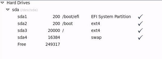

For example, if the storage drive on which you are installing operating
system is blank and you select Create Custom Layout, the "Please Select a
Device" screen appears.
To create partitions, do the following:
Scroll to the bottom of the screen, and click Create.
The Create Storage dialog appears.
Select Standard Partition, and click Create.
The Add Partition dialog appears.
In the dialog, set the Mount point to /boot and
leave the File System Type set to ext4 and the
Size (MB) set to 200.
Here is the updated Add Partition dialog.
Click OK.
The partition is created.
Repeat Step a through Step d above to create the following
additional partitions:
/boot/efi
Note -
This partition can only be created if you
selected the UEFI Boot Mode. It is not supported
in Legacy BIOS Boot Mode.
EFI System Partition
200
ext4
20000
None
swap
16384
The updated partitions screen appears.
Click Next to apply the partitions.

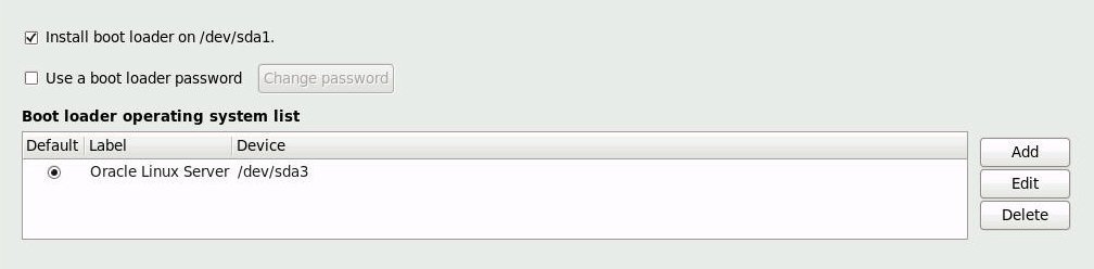

In the install boot loader screen, select Install boot loader on
/dev/sda1, and click Next.
