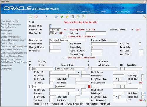

On Contract Billing Line Details
  1. To locate a contract and change order, complete the following fields:
    • Contract Number
    • Change Order Number
    • If you inquire using only Contract Number, then Change Order 000 displays.
  2. Complete the following fields for the billing line:
    • Billing Line
    • Description
    • Pricing Type
    • Schedule of Values
    Use the pricing type D or 8 for a direct draw.
    The direct draw reduces the billing amount. You must enter a negative amount in the Schedule of Values field, such as -10,000.
  3. Choose More Details (F4).

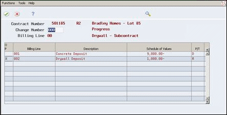

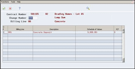

  6. Choose the Draw Line Cross Reference option (Option 3) for an independent billing line.
    Figure 12-2 Draw Line Cross Reference Option screen
    Description of Figure 12-2 follows
    Description of ''Figure 12-2 Draw Line Cross Reference Option screen''
  7. On Draw Line Cross Reference, choose Select (Option 4) for the direct draw billing line that you want to cross-reference to the independent billing line. An X in the Option field indicates that the draw line is cross-referenced to the billing line shown in the header portion of Draw Line Cross Reference.
    The Change Number that the system displays in the Draw Line Cross Reference window is the change number for the independent billing line.

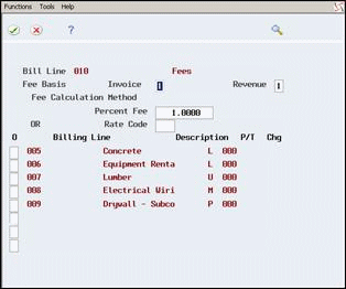

12.5.1 Cross-References for Fees
To apply a fee to a contract, you must set up a cross-reference between the dependent fee billing line and other independent billing lines within the contract against which you want to apply the fee. You can set up a cross-reference to the same billing line from multiple fee billing lines.
When you create invoices, the system uses the invoice or cost amount you specify to calculate the fee amount. For example:
Fee Amount = Fee Percent X Total Invoice Amount for the Billing Lines
When you create revenue journals, the system uses either the revenue amount or the cost amount to calculate the fee amount. For example:
Fee Amount = Fee Percent X Total Revenue Amount for the Cross-Referenced Billing Lines

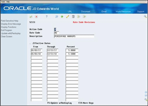

A rate code specifies the fee percentage that the system uses for a fee billing line. The rate code is based on an effective date range.
On Fee Rate Code Table
Figure 12-4 Rate Code Revisions screen
Description of Figure 12-4 follows
Description of ''Figure 12-4 Rate Code Revisions screen''
  1. To identify the rate code, complete the following fields:
    • Rate Code
    • Description
  2. Complete the following fields:
    • Effective Date From
    • Effective Date Through
    • Percent
Field Explanation
Description A user defined name or remark. A brief description of the rate code.
Form-specific information
This description appears on the Valid Rate Codes Selection window.
Date From The beginning date for which the transaction or code is applicable.
Date Thru The ending date for which the transaction or code is applicable.

You can define dependent contract billing lines for fees. Fees represent an amount that you bill your customer in addition to the amounts billed for one or more independent billing lines. You can base the fee billing line on a percent of either the costs incurred or the amounts invoiced for a contract.
When you define fee billing lines, the system supplies the following default information:
  • Tax explanation, tax or geographical area, job, and accounts receivable company from the contract master information
  • Accounts receivable offset from the customer address
  • Default account based on the Automatic Accounting Instruction BC03 for fees
Defining fees for billing amounts consists of the following:
  • Setting up a contract billing line for a fee
  • Defining a rate code for a fee
  • Setting up a cross-reference for a fee

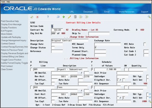

To set up a contract billing line for a fee
Navigation
From Contract Billing Processing (G52), choose Contract Billing Line Details
    • Contract Number
    • Contract Billing Line
    • Description

    Figure 12-5 Contract Billing Line Details (Defining Fees) screen
    Description of Figure 12-5 follows
    Description of ''Figure 12-5 Contract Billing Line Details (Defining Fees) screen''
  5. To override default information, complete the following optional fields:
    • Revenue BU or Cost BU
    • Subsidiary
    • Object
    • A/R Offset
    • Tax Explanation
    • Rate/Area
  6. Complete the following optional fields:
    • Retainage Rule
    • Subledger
    • Subledger Type
    • Eligibility Override
    • Account Override
    The system highlights the Pricing Type field until you define the cross-reference for the billing line.

  3. On Fee Cross Reference, if you have not already defined a rate code and you would like to do so, then choose Rate Code Revisions (F15) and add a rate code.
  4. On Fee Line Cross Reference, complete the following fields that are applicable to your system setup:
    • Invoice Fee Basis
    • Revenue Fee Basis
    If the fee basis is cost, the fee billing line must reference only T&M billing lines.
    You set the Independent Revenue/Invoice system constant to control whether the values you specify for these fields can be different.
    If the Independent Revenue/Invoice system constant is set so the invoice and revenue amounts are always equal, then the invoice and revenue fee basis values must be 1 (use invoice/revenue amount); the fee cannot be based upon cost.
    See Chapter 33, "Set Up System Constants."
  5. Complete one of the following fields:
    • Percent Fee
    • Rate Code
  6. Choose Cross Reference Selection (F8) to locate billing lines that are eligible for fees.
    The position of the independent billing line that you set up for the cross-reference must either precede the fee billing line in the same change order or occur in a previous change order.
    Figure 12-7 Cross Reference Selection screen
    Description of Figure 12-7 follows
    Description of ''Figure 12-7 Cross Reference Selection screen''
  7. On Fee Line Cross Reference Selection, choose Select (Option 4) for one or more billing lines that you want to add to the cross-reference.
    The system displays the change order number for the fee line on Fee Line Cross Reference Selection.
  8. Choose Exit Program (F3).
    The system removes the billing lines from the list and adds them to the cross-reference.
  9. Access the Fee Cross Reference form to verify the cross-reference information.
