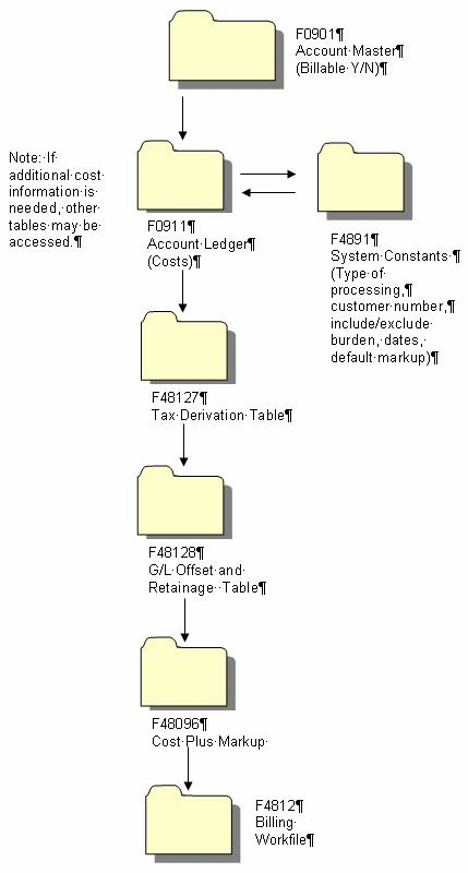

The following graphic illustrates the process the system uses to accumulate costs.
Figure 4-1 Process of Accumulating Costs
When you run the Workfile Generation program to accumulate costs, the system:
Identifies all the unprocessed source transactions in the Account Ledger (F0911)
Determines whether the account for each eligible source transaction is billable, based on the Billable (Y/N) field in the Account Master table (F0901)
Uses related tables when constants and source transactions indicate the need for additional information, such as when burden is associated with payroll transactions
Updates the Bill Code (BC) field of the source transactions in the Account Ledger table as processed to the workfile (Z) or non-billable (N)
Updates the payroll transaction history and employee transaction details for all payroll-related transactions
Calculates markup and tax amounts
Creates copies of source transactions in the Billing Workfile (F4812)
Assigns appropriate eligibility codes to the copied transactions based on the Journal Generation Control field in the system constants and the Billable (Y/N) field in the Account Master table
Assigns each transaction in the Billing Workfile a customer number
After you accumulate costs to generate workfile information, the system marks the source transactions in the Account Ledger table with N (non-billable) or Z (billed) to indicate that the transactions have been included in the billing process. The next time you accumulate costs, the system generates workfile transactions for only the source transactions that have not been previously included in the workfile generation process.
