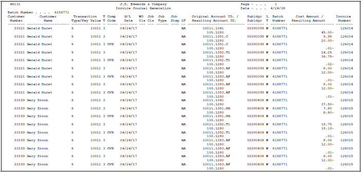

When the system creates preliminary A/R and G/L entries, you can review the batch status on Batch Review to determine whether the entries were generated with errors. To verify the information for the general ledger journal before you create the final A/R and G/L entries, you can review the following reports:
Invoice Journal Generation Report (R48131), to review the detail of all cost transactions that make up the pay items for your invoices, and the accounting rules for the transactions

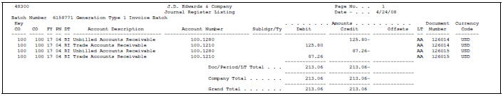

Billing Journal Register (R48300), to review journal entry details summarized by business unit, object, subsidiary, and subledger
Depending on the processing options, the reports can include error messages and warnings related to the journal information.
Review the Billing Journal Register first for errors and warnings. Use the Invoice Journal Generation Report to locate errors resulting from the account derivation rules.
Figure 12-3 Invoice Journal Generation report
Figure 12-4 Journal Register Listing report

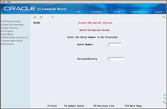

To create final A/R and G/L entries
On Create A/R and G/L Entries
Complete the following fields and press Enter:
Batch Number
Version
Choose Submit Batch (F6).
If the Invoice Date Override Control option in the Service Billing Constants is set to automatically display the date override window, then enter the override G/L date and invoice date to assign to the invoices and invoice journal entries. Choose Process (F6).
The system displays a message prompting you to verify the batch submission.
Choose Submit Job (F6).

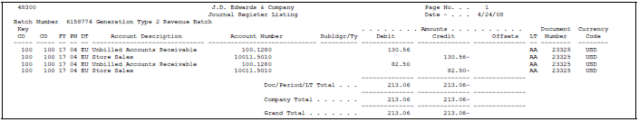

Figure 12-6 Journal Register Listing report

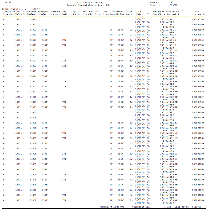

Figure 12-7 Revenue Journal Generation report
Component Code OVH Component Link 2,022 Jrnl Batch. 6158770
