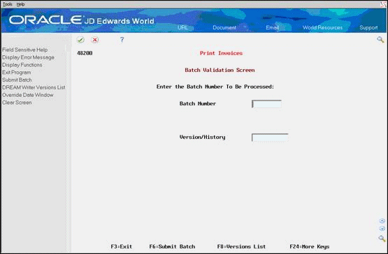

To print invoices after generation
From Work Order / Service Billing Processing (G48), choose Service Billing
From Service Billing (G4824), choose Invoice Generation
From Invoice Generation (G4824), choose Print Invoices (P48504)
On Print Invoices
Complete the following field:
Batch Number
Choose Field Sensitive Help (F8) to choose a program version.
If you do not choose a version, the system runs the ZJDE0001 version.
| Note:The value for the invoice type in the processing option for the ZJDE0001 program might not correspond to the value indicated in the DREAM Writer title. If you need to change the invoice type for the print program, you can access this processing option when you choose Print Invoices. |
After you enter the information, the batch is ready to submit.
Choose Submit Batch (F6).
The system displays the message Verify Invoice Print Submission.
Choose Submit Job (F6).
