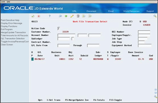

On Service Billing Invoice Entry (P4822), choose Workfile Selection (Option 1) for a specific pay item.
Figure 10-2 Work File Transaction Select screen
On Work File Transaction Select (P48123), choose Select Transaction (Option 1) for one or more transactions.
Choose Merge/Update Invoice (F5).
The system merges the workfile transaction information into the invoice pay item.
