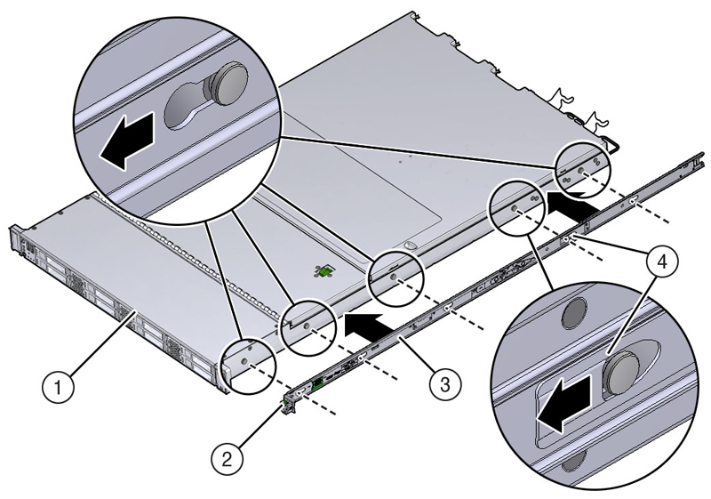

Perform the following procedure to install mounting brackets onto the sides of the server.
Position a mounting bracket against the chassis so that the slide-rail lock is at the server front, and the five keyhole openings on the mounting bracket are aligned with the five locating pins on the side of the chassis. See Figure 6.3.
Table 6.3 Figure Legend
Item
Description
1
Chassis front
2
Slide-rail lock
3
Mounting bracket
4
Mounting bracket clip
With the heads of the five chassis locating pins protruding through the five keyhole openings in the mounting bracket, pull the mounting bracket toward the front of the chassis until the mounting bracket clip locks into place with an audible click.
Verify that the rear locating pin has engaged the mounting bracket clip.
Repeat these steps to install the remaining mounting bracket on the other side of the server.

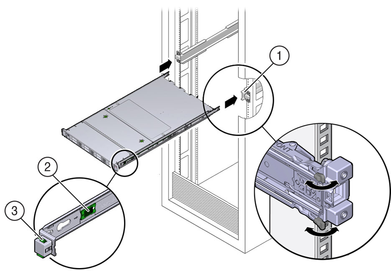

Perform the following procedure to install the server, with mounting brackets, into the slide-rail assemblies that are mounted to the rack.
This procedure requires a minimum of two people because of the weight of the server. Attempting this procedure alone could result in equipment damage or personal injury.
Always load equipment into a rack from the bottom up so that the rack will not become top-heavy and tip over. Extend your rack's anti-tilt bar to prevent the rack from tipping during equipment installation.
Push the slide-rails as far as possible into the slide-rail assemblies in the rack.
Position the server so that the rear ends of the mounting brackets are aligned with the slide-rail assemblies that are mounted in the rack. See Figure 6.6.
Insert the mounting brackets into the slide-rails, and then push the server into the rack until the mounting brackets encounter the slide-rail stops (approximately 30 cm, or 12 inches).
Table 6.5 Figure Legend
Item
Description
1
Inserting mounting bracket into slide-rail
2
Slide-rail release button
3
Slide-rail lock
Simultaneously push and hold the green slide-rail release buttons on each mounting bracket while you push the server into the rack. Continue pushing the server into the rack until the slide-rail locks (on the front of the mounting brackets) engage the slide-rail assemblies. See Figure 6.7.
You will hear an audible click.

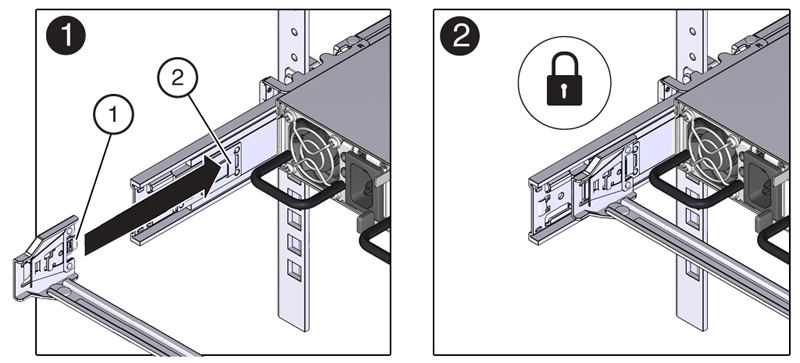

Perform the following procedure to install the cable management arm (CMA) to rear of the server.
Unpack the CMA.
To make it easier to install the CMA, extend the server approximately 13 cm (5 inches) out of the front of the rack.
Take the CMA to the back of the equipment rack, and ensure that you have adequate room to work at the back of the server.
NoteReferences to “left” or “right” in this procedure assume that you are facing the back of the equipment rack.
NoteThroughout this installation procedure, support the CMA and do not allow it to hang under its own weight until it is secured at all four attachment points.

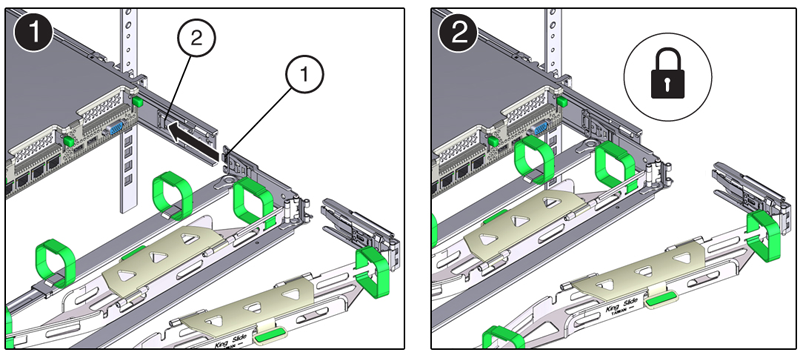

Insert the CMA's connector A into the front slot on the left slide-rail until it locks into place with an audible click. See Figure 6.8, frames 1 and 2.
The connector A tab (see call-out 1) goes into the slide-rail's front slot (call-out 2).
Gently tug on the left side of the front slide bar to verify that connector A is properly seated.
Insert the CMA's connector B into the front slot on the right slide-rail until it locks into place with an audible click. See Figure 6.9, frames 1 and 2.
The connector B tab (call-out 1) goes into the slide-rail front slot (call-out 2).
Gently tug on the right side of the front slide bar to verify that connector B is properly seated.
To install the CMA's connector C into the right slide-rail, perform the following steps:
Align connector C with the slide-rail so that the locking spring (call-out 1) is positioned inside (server side) of the right slide-rail. See Figure 6.10, frame 1.
Insert connector C into the right side-rail until it locks into place with an audible click (frames 2 and 3).
Gently tug on the right side of the CMA's rear slide bar to verify that connector C is properly seated.
To prepare the CMA's connector D for installation, remove the tape that secures the slide-rail latching bracket to connector D and ensure that the latching bracket is properly aligned with connector D. See Figure 6.11, frames 1 and 2.
NoteThe CMA is shipped with the slide-rail latching bracket taped to connector D. You must remove the tape before you install this connector.
While holding the slide-rail latching bracket in place, insert connector D and its associated slide-rail latching bracket into the left slide-rail until connector D locks into place with an audible click. See Figure 6.12, frames 1 and 2.
NoteWhen inserting connector D into the slide-rail, the preferred and easier method is to install connector D and the latching bracket as one assembly into the slide-rail.
Gently tug on the left side of the CMA's rear slide bar to verify that connector D is properly seated.
NoteThe slide-rail latching bracket has a green release tab. This tab is used to release and remove the latching bracket so that you can remove connector D.
Gently tug on the four CMA connection points to ensure that the CMA connectors are fully seated before you allow the CMA to hang by its own weight.

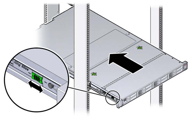

To verify that the slide-rails and the CMA are operating properly before routing cables through the CMA, perform the following steps:
Extend the server from the front of the rack until the CMA is fully extended.
CautionTo reduce the risk of personal injury, stabilize the rack cabinet and extend all anti-tilt devices before extending the server from the rack.
Simultaneously pull and hold the two green release tabs (one on each side of the server) toward the front of the server (see the following figure) while you push the server into the rack. As you push the server into the rack, verify that the CMA retracts without binding. See Figure 6.13.
NoteTo pull the green release tabs, place your finger in the center of each tab, not on the end, and apply pressure as you pull the tab toward the front of the server.
Continue pushing the server into the rack until the slide-rail locks (on the front of the server) engage the slide-rail assemblies.
You will hear an audible click when the server is in the normal rack position.

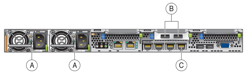

The Oracle PCA rack is pre-cabled for all Ethernet and InfiniBand cabling, including for future compute nodes. Cable bundles are cable-tied to the correct rack unit for each future server. You should not modify any of the cabling on the Oracle Switch ES1-24 switches, NM2-36P Sun Datacenter InfiniBand Expansion Switches, Oracle ZFS Storage Appliance ZS3-ES, or the InfiniBand ports on the Fabric Interconnects. For cabling reference information, see Appendix B, Cabling Reference.
Connect the pre-installed power and data cables of the appropriate rack unit to the back of the expansion node. The cables are labeled for your convenience, and should be connected according to Figure 6.14.
Table 6.9 Figure Legend
Item
Description
A
Power supplies
B
InfiniBand connectors
C

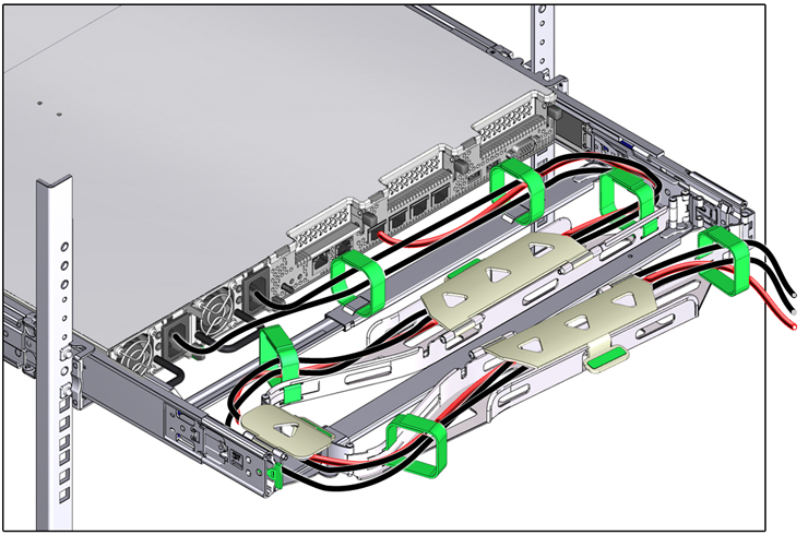

NET0Ethernet portOpen the CMA cable covers, route server cables through the CMA's cable troughs, close the cable covers, and secure the cables with the six Velcro straps. See Figure 6.15.
First through the front-most cable trough.
Then through the small cable trough.
Then through the rear-most cable trough.
NoteWhen securing the cables with the Velcro straps located on the front slide bar, ensure that the Velcro straps do not wrap around the bottom of the slide bar; otherwise, expansion and contraction of the slide bar might be hindered when the server is extended from the rack and returned to the rack.
Ensure that the secured cables do no extend above the top or below the bottom of the server to which they are attached; otherwise, the cables might snag on other equipment installed in the rack when the server is extended from the rack or returned to the rack.
NoteIf necessary, bundle the cables with additional Velcro straps to ensure that they stay clear of other equipment. If you need to install additional Velcro straps, wrap the straps around the cables only, not around any of the CMA components; otherwise, expansion and contraction of the CMA slide bars might be hindered when the server is extended from the rack and returned to the rack.
