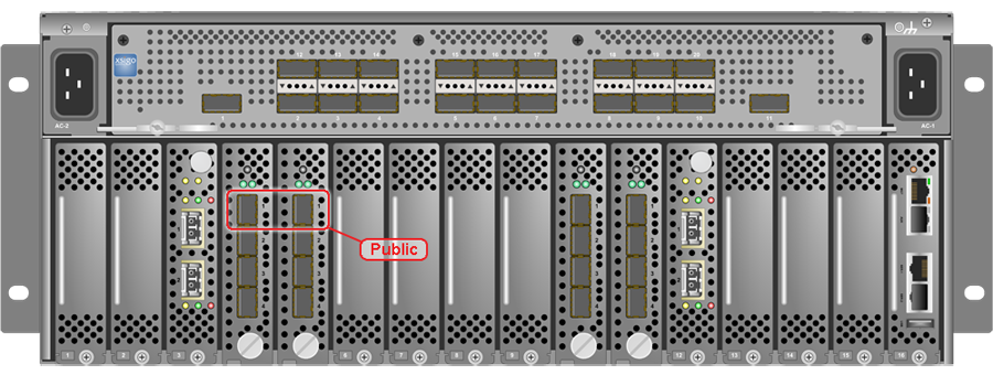

You must connect two 10 Gigabit Ethernet (GbE) IO module ports labeled “Public” on each Fabric Interconnect to your public Ethernet network.

Figure 3.1 shows the location of the 10 GbE Public IO module ports on the Fabric Interconnect.
Figure 3.1 Oracle Fabric Interconnect F1-15 10 GbE Public IO Module Ports
Figure showing the location of the Oracle Fabric Interconnect F1-15 10GbE Public IO module ports.

It is critical that both Fabric Interconnects have two 10GbE connections each to a pair of next-level data center switches. This configuration with four cable connections provides redundancy and load splitting at the level of the Fabric Interconnects, the 10GbE ports and the data center switches. This outbound cabling should not be crossed or meshed, because the internal connections to the pair of Fabric Interconnects are already configured that way. The cabling pattern plays a key role in the continuation of service during failover scenarios involving Fabric Interconnect outages and other components.
