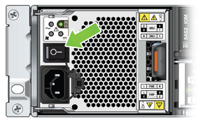

  3. Make sure that the circuit breakers located on the rear left and right side power supplies of the Oracle ZFS Storage Appliance ZS3-ES are in the ON (|) position.
    Figure 5.4 Oracle ZFS Storage Appliance ZS3-ES Circuit Breakers
    Figure showing the circuit breaker on the left-side power supply of the Sun ZFS Storage Appliance

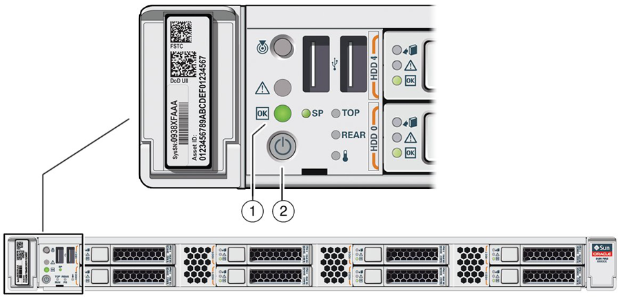

  4. Press the Power button located on the front of the first (bottom) management node. See Figure 5.5.
    The first management node is located in rack unit 5 (U5). The second management node is located in rack unit 6 (U6). It is switched on and configured automatically during the initial power-on sequence.
    A management nodes take approximately five to ten minutes to power on completely. Once complete, the Power/OK LED illuminates and remains a steady green.
    Figure 5.5 Oracle Private Cloud Appliance Management Node
    This figure shows the location of the Power/OK LED and Power button on the Oracle Private Cloud Appliance management node.
    Table 5.2 Figure Legend
    Item
    Description
    1
    Power/OK LED
    2
    Power button
