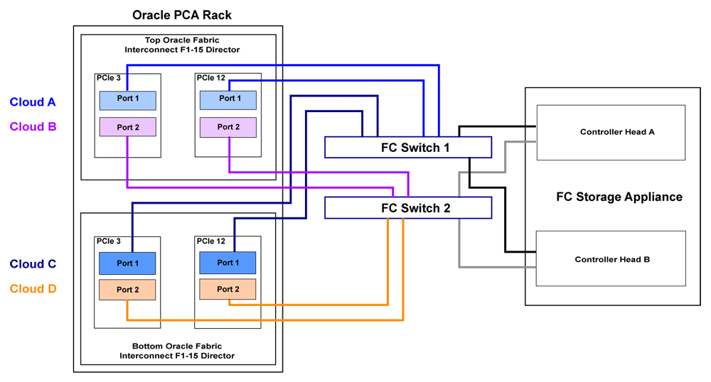

For a bare minimum configuration, you can use two cables to connect your FC switch to cloud A. This would require that you connect cables to the top Fabric Interconnect in the rack, using I/O Module 3 Port 1 and I/O Module 12 Port 1. Connect each controller head on your FC storage appliance to your FC switch. Typically you would use two cables for each controller head.
For a basic HA configuration, you should cable for cloud A and cloud C. This allows you to use both of the Fabric Interconnects in the rack to improve redundancy. This is the recommended default minimum configuration. It is important that cloud A and cloud C are cabled to the same FC switch.
Figure 8.1 Minimum HA FC Storage Cabling Configuration
Figure showing the minimum HA FC storage cabling configuration, with cloud A on the top Fabric Interconnect and cloud C on the bottom Fabric Interconnect connected to the FC switch. Two cables are connected from each controller head on the storage appliance into the same FC switch.
To maximize an HA configuration, by using an additional FC switch, you can cable cloud B and cloud D into the second FC switch. In this situation you should cross-cable the controller heads on your FC storage appliance, so that each controller head is connected to each of your FC switches.
Figure 8.2 Full HA FC Storage Cabling Configuration
Figure showing full HA FC storage cabling configuration, with cloud A on the top Fabric Interconnect and cloud C on the bottom Fabric Interconnect connected to the same FC switch. cloud B on the top Fabric Interconnect and cloud D on the bottom Fabric Interconnect are connected to an alternate FC switch. Each controller head on the storage appliance is connected to each of the FC switches.
Other cabling possibilities exist, such as the aforementioned configuration where clouds are each connected to independent FC switches to maximize throughput or to achieve physical traffic separation. Usually, in this configuration, one cloud is left disconnected in standby so that in the event that one of the other clouds fails for some reason, it is possible to connect the standby cloud to take over the function of the failed cloud. In this situation, you would need to configure so that the WWPNs for the standby cloud are substituted for the failed cloud in the initiator groups on your storage appliance.
The most important points to remember when cabling are as follows:
  • Clouds are comprised of two equivalent ports on alternate I/O Modules on the same Fabric Interconnect. For instance, cloud A on the top Fabric Interconnect in the rack is comprised of Port 1 on I/O Module 3 and Port 1 on I/O Module 12; while cloud D on the bottom Fabric Interconnect in the rack is comprised of Port 2 on I/O Module 3 and Port 2 on I/O Module 12.
  • Although not required, you should cable both ports that belong to a cloud to provide redundancy and to allow better throughput.
  • Unless you have defined zones that span more than one FC switch, the ports that belong to a cloud must be cabled to connect to the same FC switch.
  • For HA configurations, clouds on alternate Fabric Interconnects should be connected to the same FC switch. For instance, cloud A and cloud C should be connected to the same FC switch; while cloud B and cloud D can be connected to an alternate switch.
You can connect FC cabling at any time, and no system shutdown is required, allowing you to hot-add storage or improve redundancy as required.

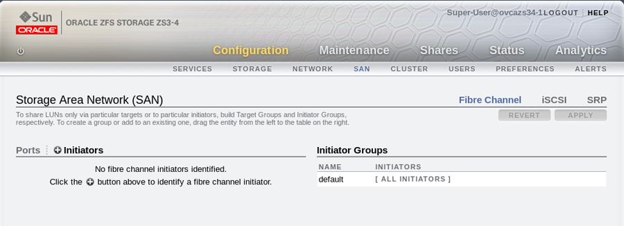

  3. Click on the + Initiators link as indicated in the image below:
    Figure 8.3 Click on the + Initiators link.
    Figure showing the SAN Summary page in the Oracle Storage Appliance ZS3-4 web user interface. The + Initiators link is circled in red.

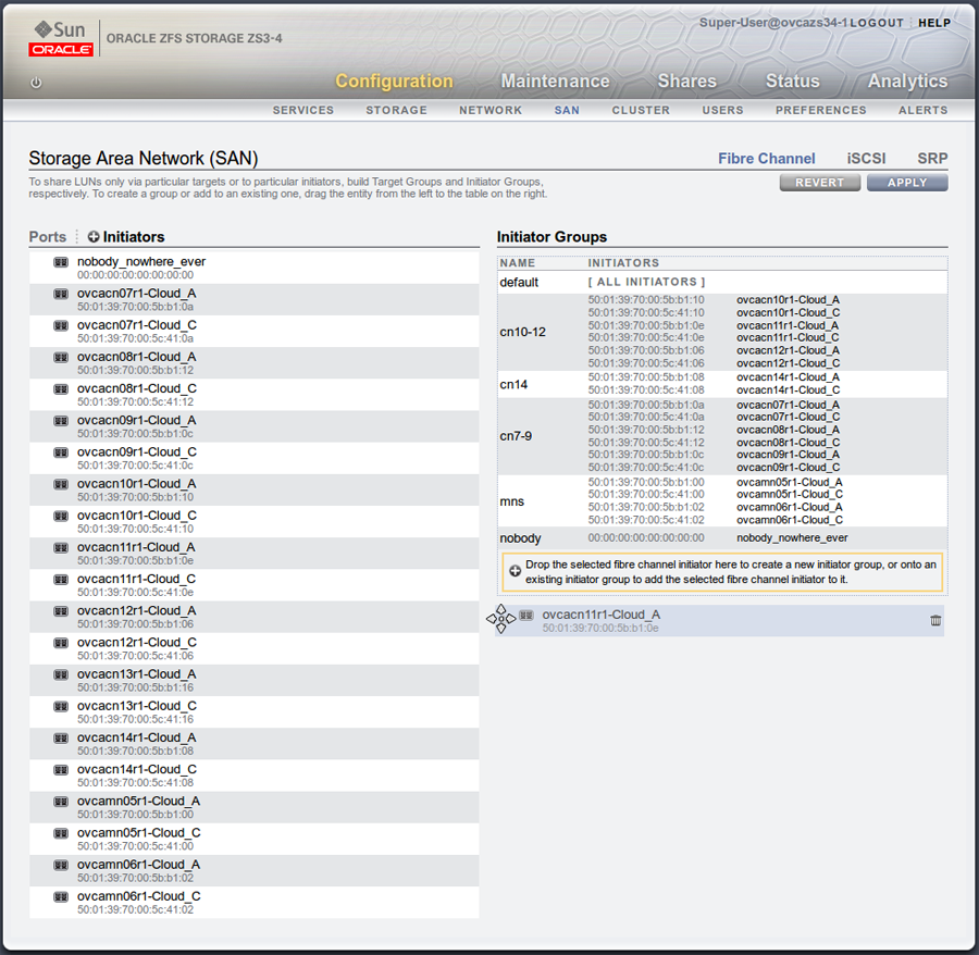

  5. When you have finished creating aliases for each WWPN, you can start to create the storage initiator groups where LUNs are presented later in the configuration. To create a new storage initiator group in the SAN Summary view, move your mouse over the left hand side of the WWN name until you see the move icon appear, then drag it to the right hand side of the screen and drop it in the Create New Initiator Group box that appears. This step is illustrated in the figure below:
    Figure 8.5 Use the SAN Summary page to create a new storage initiator group by dragging an initiator across the page.
    Figure showing how to use the SAN Summary page in the Oracle Storage Appliance ZS3-4 web user interface to create a new storage initiator group by dragging an initiator across the page and dropping it in the Create New Initiator Group box that appears.
    You can create as many initiator groups as you like. In most cases, if your storage is not used outside of the Oracle PCA and you do not need to segregate storage within the Oracle PCA, you can simply use the default initiator group. However, if your storage is shared with appliances outside of the Oracle PCA, you must, at least create an initiator group for all of the initiators that belong to nodes within the Oracle PCA. If you need to segregate storage further, you can create initiator groups that only include the initiators for particular compute nodes, as is illustrated in the screenshot.
  6. Once you have created a new initiator group, you can roll over it using your mouse and then click on the edit icon that appears in the form of a pencil. A dialog appears where you are able to edit the initiator name to change it to something more appropriate. You can also select the rest of the initiators that you wish to include in the initiator group. Click OK when you have finished editing the initiator group.
  7. When you have finished creating and editing initiator groups, it is important that you click on the Apply button on the SAN Summary page to save the changes that you have made.
  8. You can now define how LUNs map to your initiator groups depending on your requirements. This is achieved by clicking on the Shares link in the navigation bar at the top of the page. On the Project Summary page, you can view any storage pools that you have defined and the LUNs associated with those pools. You can also create new LUNs for each storage pool as required. On this page, you can click to edit a LUN and edit the storage initiator groups that it is exposed to. In this view, you can make a LUN accessible to any of the storage initiators that you defined in the previous steps.
