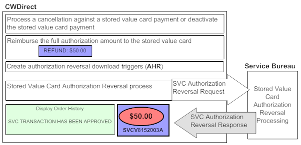

Stored Value Card Authorization Reversal Process
Purpose: The system reimburses a stored value card the original authorization amount associated with the card when you process a cancellation associated with a stored value card payment or deactivate the stored value card.
Note: If the Perform Authorization Reversal during Deposit Processing (J20) system control value is set to Y, when you process deposits and the deposit amount is less than the original authorization amount, the system reimburses the stored value card the difference; see Authorization Reversal Process During Deposits.
Stored Value Card Authorization Reversal Illustration:
1. You process a cancellation associated with a stored value card payment or deactivate the stored value card.
You can process a cancellation by:

2. The system determines if the order is eligible for stored value card authorization reversal.

3. The system creates an authorization reversal for the original authorization amount, not the actual amount of the reversal.
4. The system creates a record in the Auth History SVC Reversal file for the authorization amount to reimburse.

5. The system creates an authorization reversal download trigger for the stored value card authorization reversal.

The system:
• looks for AHR download triggers with the File code AHR and a status of ready (R).
• determines which stored value card authorization reversal to download, based on the Key field for the authorization reversal download trigger.
8. for each authorization reversal download trigger, generates a Stored Value Card Authorization Reversal Message.
The system creates the Stored Value Card Authorization Reversal Message using the Generic Authorization Request Message in Batch mode. See SVC Authorization Reversal Request Message for a description of the attributes in the message that relate to stored value card authorization reversal.
9. The system sends the generated SVC Authorization Reversal Request Message to the service bureau and waits for a response.
10. The service bureau receives the request, processes the authorization reversal request, and sends back a response indicating if the authorization reversal request was approved.
11. The system receives the Authorization Response Message and processes the response accordingly. See:

What Happens When the Authorization Reversal is Approved?
An authorization reversal receives an approved reversal if the Authorization Reversal Response message contains an authorization number. In this case, the system:
• updates the associated record in the SVC Authorization Reversal file with the approval date, approval time, and reversal response.
• creates an order transaction history message indicating the authorization reversal was approved: SVC Reversal Has Been Approved.
• voids the authorization history record.
The stored value card authorization reversal request contains authorization reversal information to send from CWDirect to the service bureau for approval.
The system creates the SVC authorization reversal request using the Generic Authorization Request XML message in Batch mode; because of this, only the elements and attributes specific to SVC authorization reversal are explained below. See Authorization Request XML Message (CWAuthorizationRequest) for more information on the additional elements and attributes in this message.
Note: The SVC_REVRSL integration layer process uses the outbound XML version for the Stored Value Card Activation integration layer process defined for the service bureau, not the outbound XML version you define for the SVC_REVRSL process. For example, if you enter SVC_OUT in the SVC activation field for the service bureau, the system uses the outbound XML version defined for this process when generating the SVC Authorization Reversal Request Message.
Attribute Name
