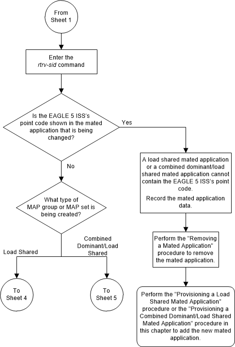

Figure 2-112 Change the Mated Application Type - Sheet 1 of 6

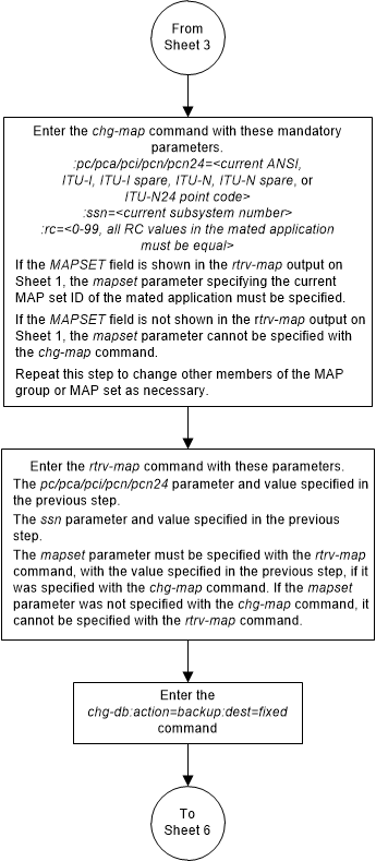

Figure 2-113 Change the Mated Application Type - Sheet 2 of 6

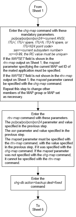

Figure 2-114 Change the Mated Application Type - Sheet 3 of 6

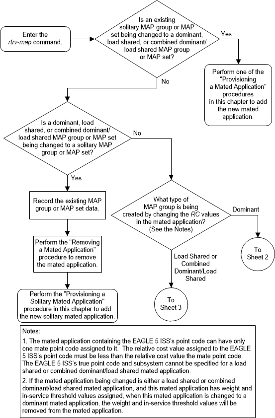

Figure 2-115 Change the Mated Application Type - Sheet 4 of 6

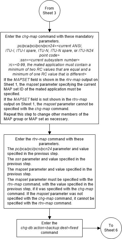

Figure 2-116 Change the Mated Application Type - Sheet 5 of 6

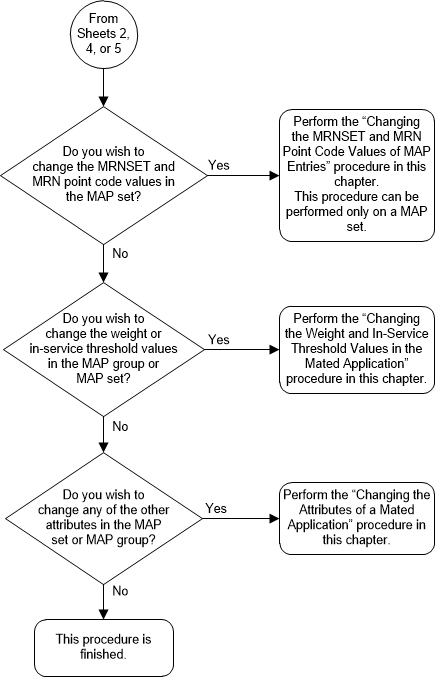

Figure 2-117 Change the Mated Application Type - Sheet 6 of 6
