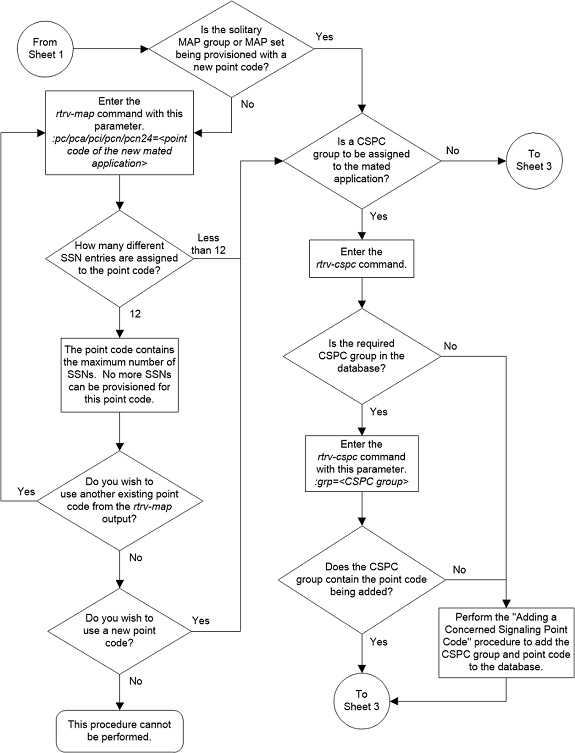

:grp
– The name of the
concerned signaling point code (CSPC) group that contains the point codes that
should be notified of the subsystem status. This parameter applies to both
RPCs/SSNs. The value for this parameter is shown in the
rtrv-cspc
output. If the desired value
is not shown in the
rtrv-cspc
output, perform the
Adding a Concerned Signaling Point Code
procedure to add the desired group. If this parameter is not specified, then a
CSPC group name is not specified for the mated application.

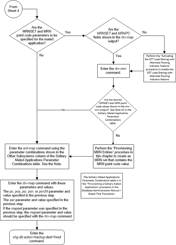

:mrnset
– The MRN set
ID that is being assigned to the mated application. This is the MRN set from
which alternate routing indicator searches are performed.
:mrnpc/mrnpca/mrnpci/mrnpcn/mrnpcn24
– The point code
assigned to the
mrnset
MAP set.
The current values of the
mrnset
and
parameters are shown in the
rtrv-map
output only if the Flexible
GTT Load Sharing and the GTT Load Sharing with Alternate Routing Indicator
features are enabled.
The new values for the
mrnset
and
parameters must be shown in the
rtrv-mrn
output.
The network type of the
pc/pca/pci/pcn/pcn24
and
parameter values must be compatible, as shown in
Table 2-38.
Table 2-38 MAP and MRN Point Code Parameter Combinations
MAP Point Code Parameter | MRN Point Code Parameter |
pc/pca | mrnpc/mrnpca |
pci or pcn (See Notes 1 and 2) | mrnpci or mrnpcn (See Notes 1 and 2) |
pcn24 | mrnpcn24 |
pci
), the network
type of the MRN point code parameter can be either ITU-I
(mappci
) or ITU-N (mappcn
pcn
), the network
(mappci
) or ITU-N (mappcn

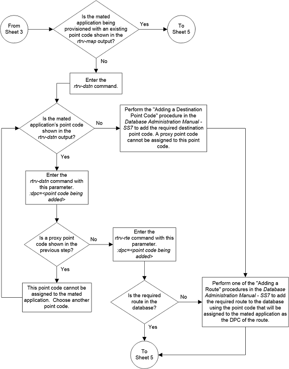

The point codes specified in the
ent-map
command (pc
/pca
pci
pcn
, or
pcn24
) must be either a full point code
in the routing point code table or the EAGLE’s true point code. Cluster point
codes or network routing point codes cannot be specified with this command. The
rtrv-rte
command can be used to verify
the point codes in the routing table. The point codes in the routing table are
shown in the
DPCA
DPCI
DPCN
, or
DPCN24
fields of the
rtrv-rte
command output. The EAGLE’s
true point code is shown in the
PCA
PCI
PCN
, or
PCN24
fields of the
rtrv-sid
command output.

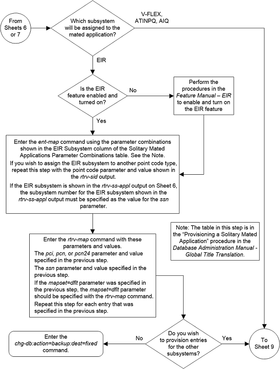

A solitary mated application can be provisioned with a point code that is assigned to other mated applications as long as the SSN is not assigned to other mated applications. A point code can be assigned to maximum of 12 different SSNs.
If the EAGLE’s true point code is specified in the mated application and the Flexible GTT Load Sharing feature is enabled, the mated application containing the EAGLE’s true point code can be assigned only to the default MAP set.
A mated application containing the LNP subsystem can contain only the EAGLE's ANSI true point code. The LNP feature must be enabled for a quantity greater than zero.

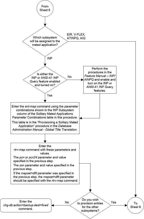

A mated application containing the INP subsystem can contain only the EAGLE’s true14-bit ITU-N point code, 14-bit ITU-N spare point code, or 24-bit ITU-N point code. The INP or ANSI-41 INP Query feature must be enabled and turned on. The EAGLE can contain either 14-bit ITU-N point codes (spare or non-spare point codes) or 24-bit ITU-N point codes. Both types of point codes cannot be present on the EAGLE at the same time.
A mated application containing the EIR subsystem can contain only the EAGLE’s true ITU-I point code, ITU-I spare point code, 14-bit ITU-N point code, 14-bit ITU-N spare point code, or 24-bit ITU-N point code. The EIR feature must be enabled and turned on. The EAGLE can contain either 14-bit ITU-N point codes (spare or non-spare point codes) or 24-bit ITU-N point codes. Both types of point codes cannot be present on the EAGLE at the same time.
A mated application containing the VFLEX subsystem can contain any of the EAGLE’s true point codes. The V-Flex feature must be enabled and turned on. The EAGLE can contain either 14-bit ITU-N point codes (spare or non-spare point codes) or 24-bit ITU-N point codes. Both types of point codes cannot be present on the EAGLE at the same time.

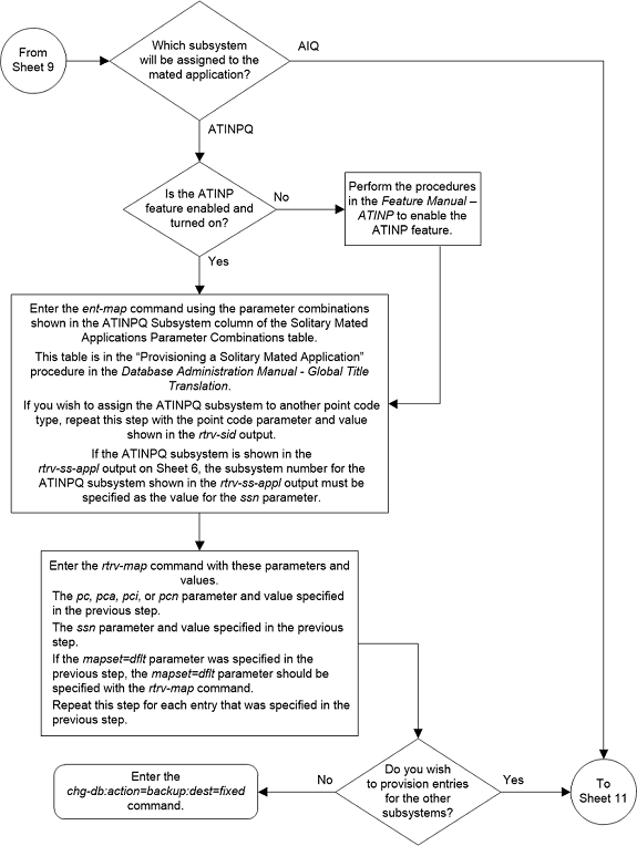

A mated application containing the ATINPQ subsystem can contain only the EAGLE’s true ANSI point code, ITU-I point code, ITU-I spare point code, 14-bit ITU-N point code, or 14-bit ITU-N spare point code. The ATINP feature must be enabled.
A mated application containing the AIQ subsystem can contain any of the EAGLE’s true point codes. The ANSI41 AIQ feature must be enabled. The EAGLE can contain either 14-bit ITU-N point codes (spare or non-spare point codes) or 24-bit ITU-N point codes. Both types of point codes cannot be present on the EAGLE at the same time.
The EAGLE can contain multiple entries that contain the
EAGLE's true point code, shown in the
rtrv-sid
output.

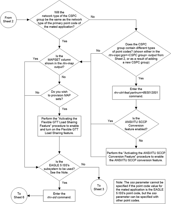

The format of the point codes in the CSPC group specified
with the
grp
parameter must be the same as the
point code specified with the
ent-map
command only if the ANSI/ITU
SCCP Conversion feature is not enabled. If the ANSI/ITU SCCP Conversion feature
is enabled, the CSPC group may contain a mixture of point code types (refer to
the
procedure), and the network type of the CSPC group can be different from the
network type of the primary point code of the mated application. The status of
the ANSI/ITU SCCP Conversion feature can be verified with the
rtrv-ctrl-feat
command.

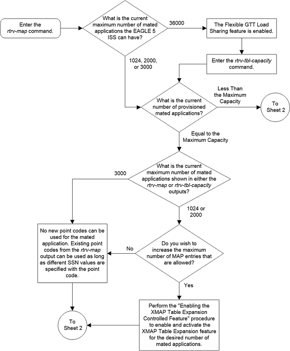

The EAGLE can contain 1024, 2000, or 3000 mated applications. The EAGLE default is 1024 mated applications. This quantity can be increased to 2000 by enabling the feature access key for part number 893-0077-01, or to 3000 by enabling the feature access key for part number 893-0077-10. For more information on enabling these feature access keys, refer to the Enabling the XMAP Table Expansion Feature procedure.

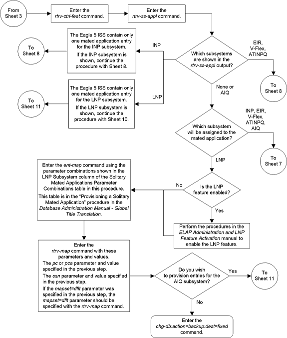

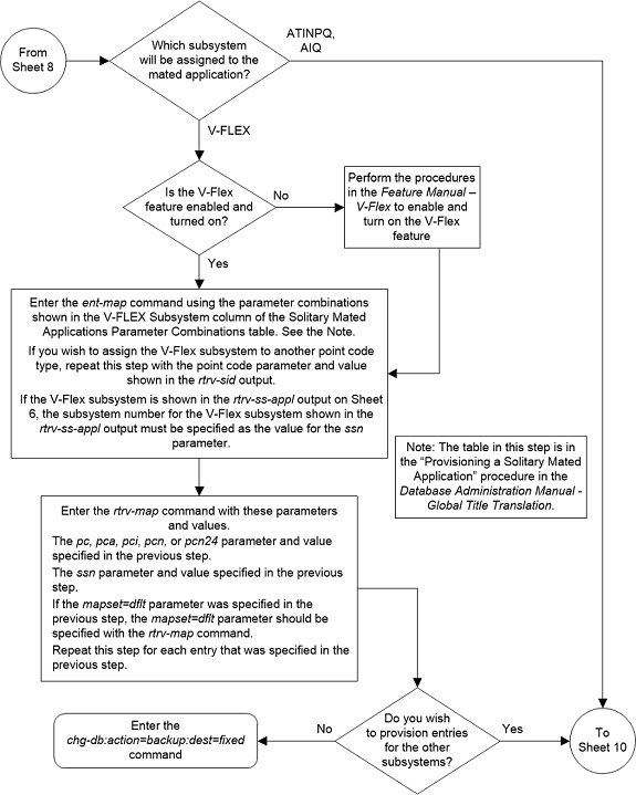

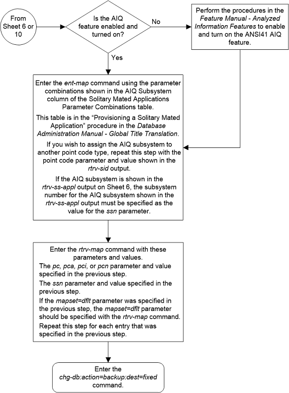

Figure 2-51 Provision a Solitary Mated Application - Sheet 1 of 11
Figure 2-52 Provision a Solitary Mated Application - Sheet 2 of 11
Figure 2-53 Provision a Solitary Mated Application - Sheet 3 of 11
Figure 2-54 Provision a Solitary Mated Application - Sheet 4 of 11
Figure 2-55 Provision a Solitary Mated Application - Sheet 5 of 11
Figure 2-56 Provision a Solitary Mated Application - Sheet 6 of 11
Figure 2-57 Provision a Solitary Mated Application - Sheet 7 of 11
Figure 2-58 Provision a Solitary Mated Application - Sheet 8 of 11
Figure 2-59 Provision a Solitary Mated Application - Sheet 9 of 11
Figure 2-60 Provision a Solitary Mated Application - Sheet 10 of 11
Figure 2-61 Provision a Solitary Mated Application - Sheet 11 of 11
